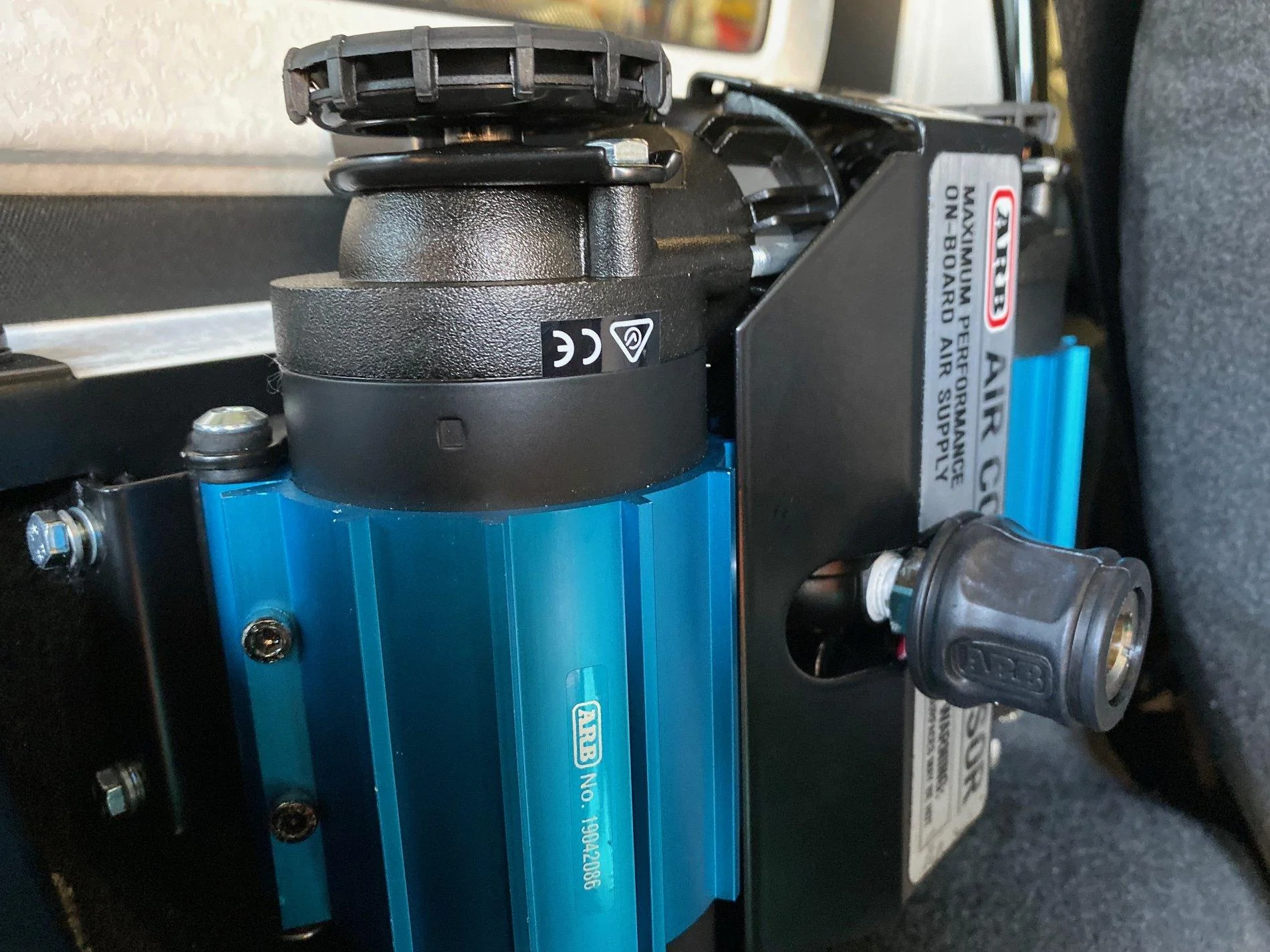

Hello,
Today, the compressor is installed. I contacted ARB if this was a good solution, and they suggested I put in the Air manifold. Since its not expensive. Where is a good solution to mount it. That is behind the rear seats.

Hello,
I thought the manifold is just needed for lockers.
I went around and round on location. And the MORE bracket seemed to be the ideal solution giving proper ventilation. Agreed it’s not the best location with the top off. But I just put a cheapie Amazon elastic band winch cover over it to keep the dust off of it. And pull it off when I need it. With the hardtop on it is not a issue.
I have discovered that it’s essential to keep the engine running while running the compressor.
@Lazygreek. I see that you had some trouble with those side bolts holding the compressor to the bracket. Just save yourself the grief and get a closed end ratcheting wrench. Makes the job much easier
