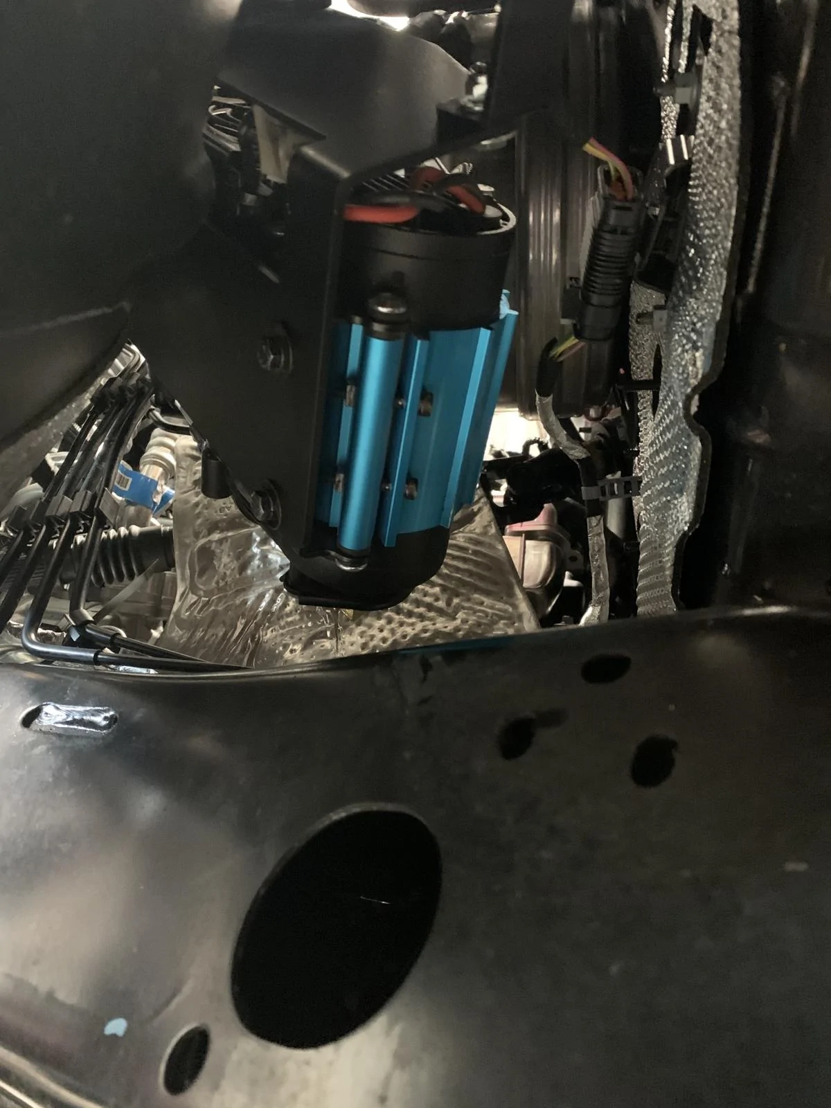

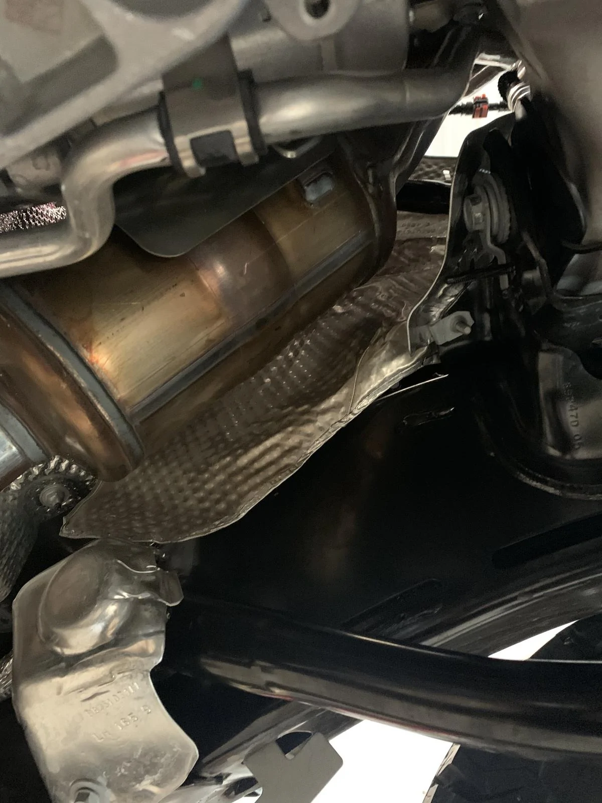

Well I have the @Kansascoast mount and my ARB just went out. Blows the fuses and will only run for a few min. As much as i love it under the hood, the exhaust is just too close to it and makes it overheat.
I have the same mount. I also mounted the air intakes up higher by the master cylinder, still hot air, but not right next to catalytic converter. I also mounted a heat shield. Snagged a couple off a Jeep Patriot in the junkyard (couldn’t find any rigid shields online that weren’t crazy expensive). Hard to take pictures of this area, but here’s the shield to keep some of the heat off the compressor:
Jeep Wrangler JL Mounting ARB Air Compressor 60C8F908701D490EA012
Jeep Wrangler JL Mounting ARB Air Compressor 1168B6AF1AB94BA9B5C6
I also removed my hood insulation, the motor cover and made my hood vents fully functional - anything to get as much heat out as possible. Also leave the hood up while airing up (which also gives my remote air intakes cooler air)...

Not really going to help. Hood was open when using it. It's right next to the exhaust manifold.
Mantacon
Eric
Jul 30, 2018
369
427
2018 Sting Grey JLUR
You may be right, but after I get this $500 compressor refurbished, it's not going back under the hood in that heat.
