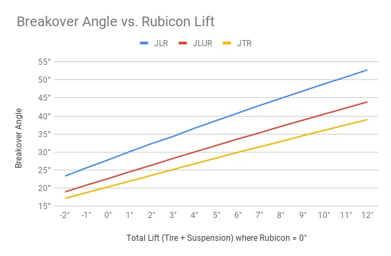

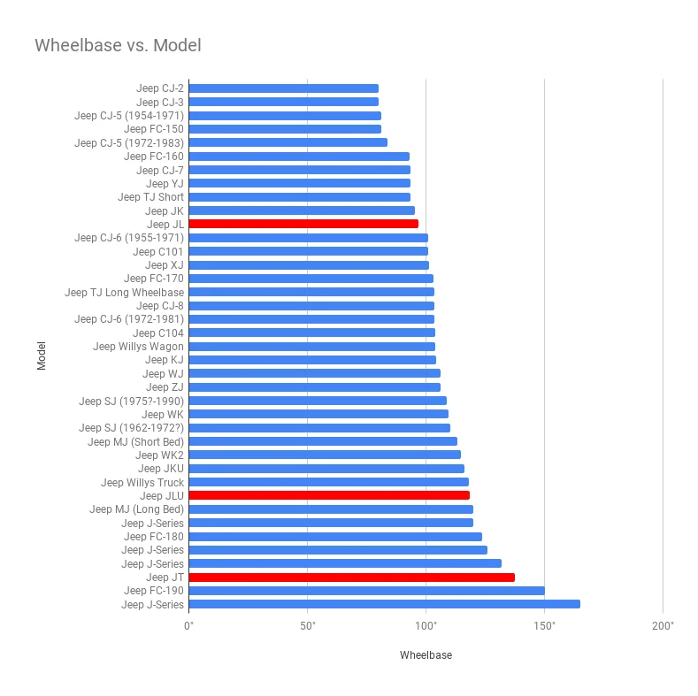

Somewhat related
I wouldn't trust the numbers above about 8" of lift on this chart though...
Our resident statistician has a chart for everything. According to this chart, our jlur with 4" lift and 37's has ~35⁰ breakover angle. A JLR on 35's with 1.5" lift will have the same breakover angle. It will also have much worse approach and departure angles, water fording ability, and ground clearance. Even though the JL is lower, it is still less stable in my experience having wheeled both types of builds. It wins in maneuverability hands down but that is about it.
