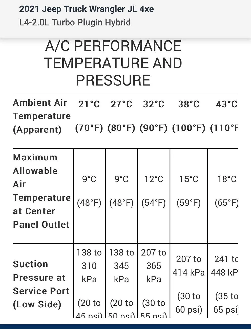

FSM test temps.
Jeep Wrangler JL "Max A/C" IMG_8451
roaniecowpony
roaniecowpony
Dec 4, 2018
200
13,390
21,587
Retired Engineer
FSM test temps.
Hmm. It appears that I'm inside specification. Still, itd be helpful to know some actual temps to see if what i would like is practical.
