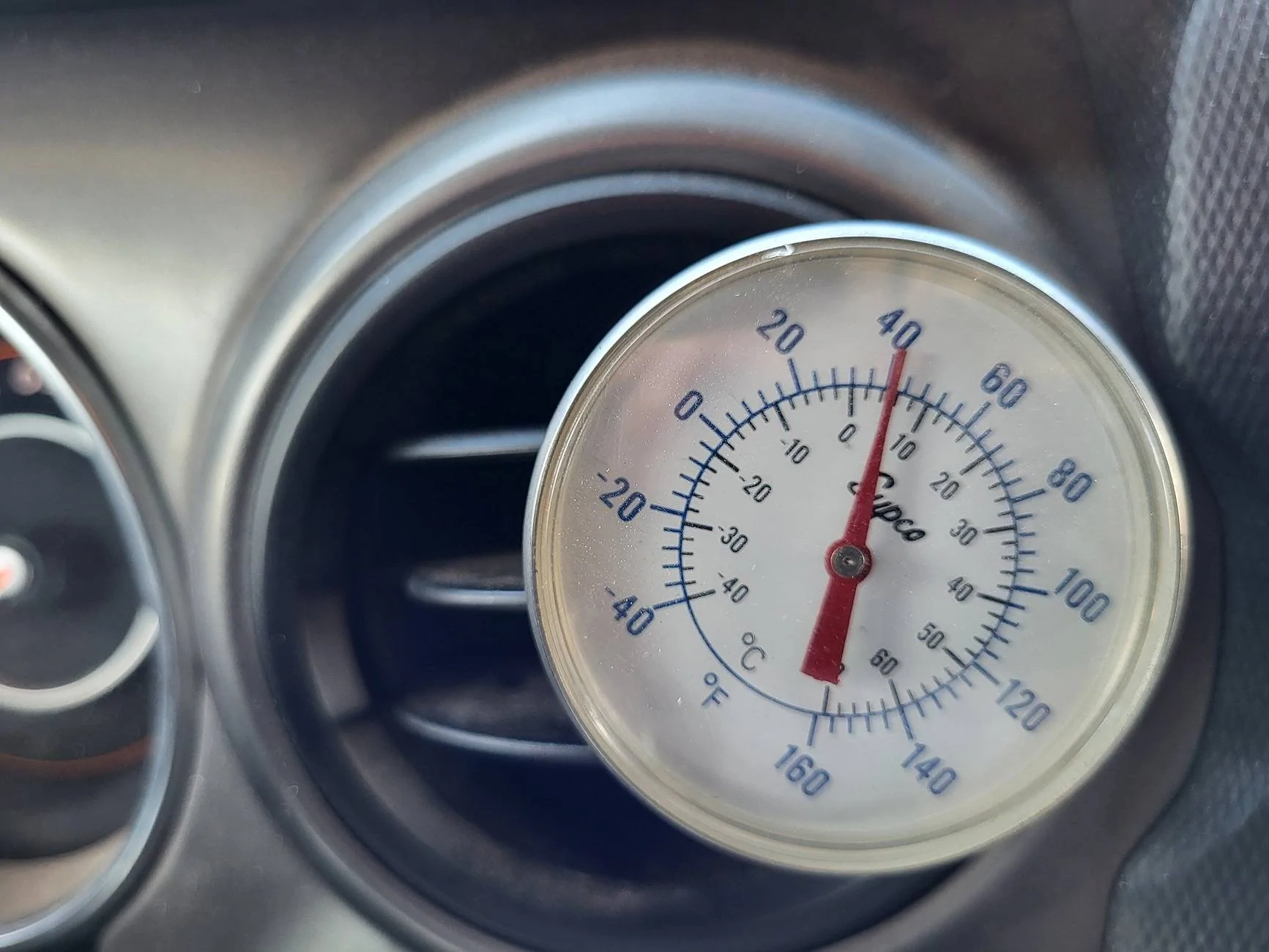

I had a Thermapen instant read thermometer in the vent for some street and freeway driving several times now. Temps are 44-46 pretty consistently in the past couple weeks, including yesterday around here. Doesn't seem to change much, so I think the mechanicals and sensors are working as designed. My vacuum might have been less than ideal.

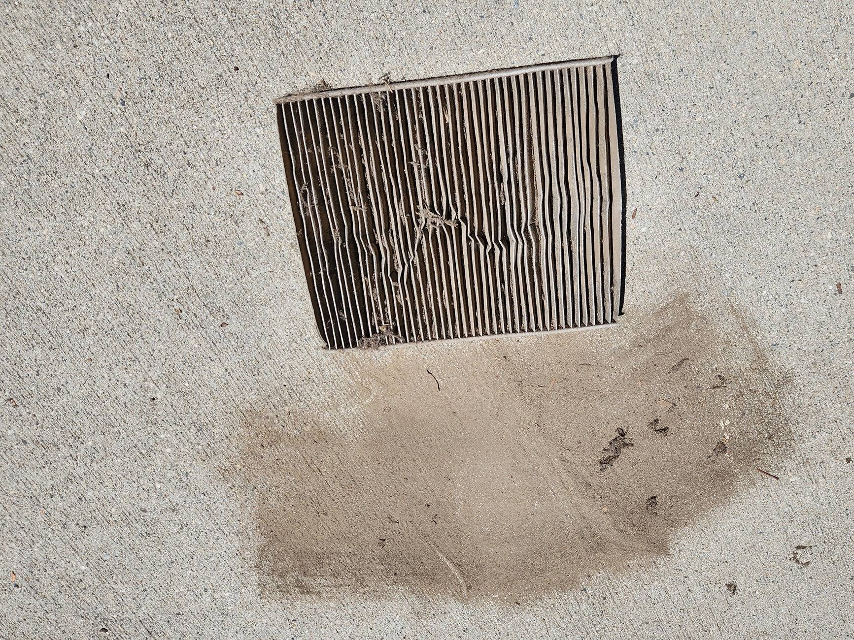

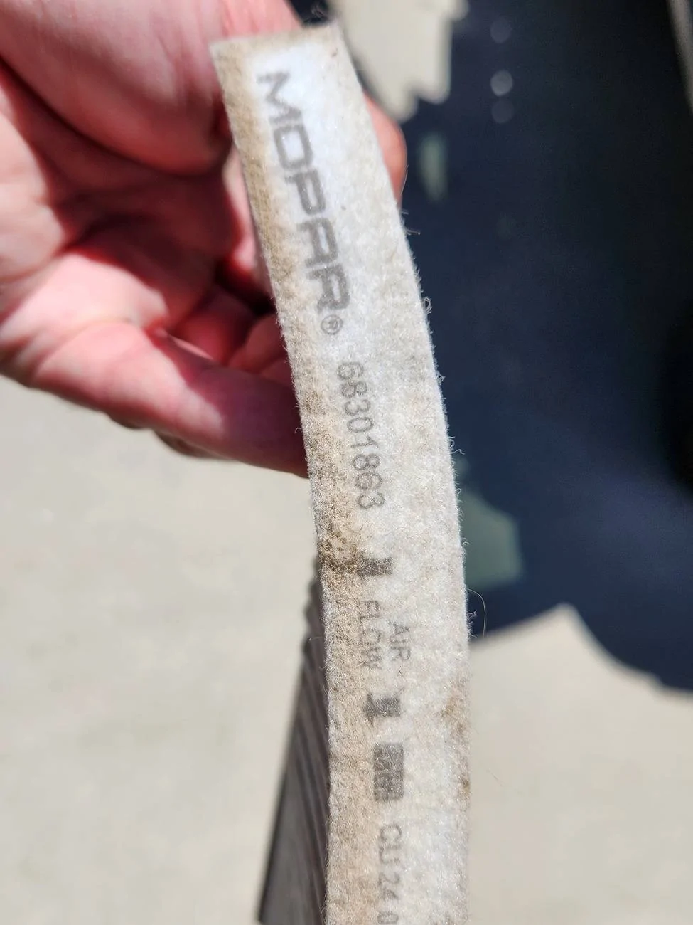

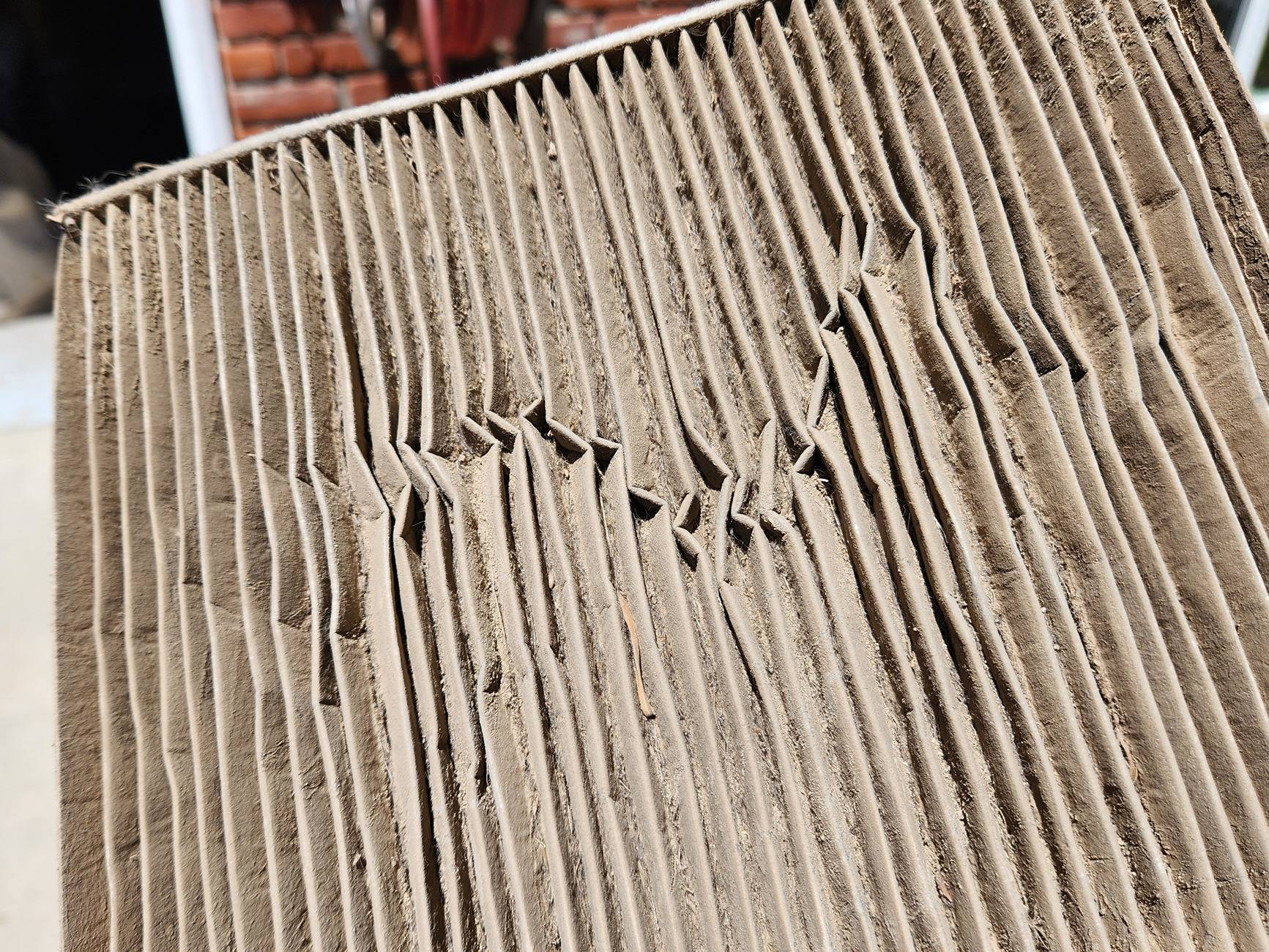

It's likely my cabin filter is responsible for carrying off a good portion of the dirt missing from the Rubicon trail and some Moab and Big Bear trails. I haven't looked at it since starting rock crawling a couple years ago. Also, I noticed the Jeep is leaning slightly on that side where the filter is.
Soooo, these pix speak for themselves. I hope the Rubicon Trail Foundation doesn't ban me for taking their trail dirt home. Looks like there's some Moab in there too, and enough hair to re-hair a dog. Quick question; are original 2018 cabin filters collectable?

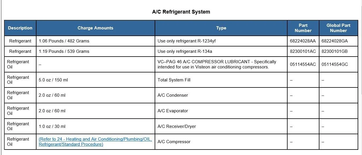

Everything I've read about R1234yf suggests that the orifice does not need to change. Pressures are slightly higher with R1234yf. I didn't find a different orifice listed for R134a in the JL parts lists online. My only concern is possibly programming of the PCM for the different pressures/clutch operation. But, then everything I've read thus far suggests there should be no differences.
So, a test drive after the filter change and no surprise, it was a huge difference in flow rate. However, the ability to cool the cabin didn't change much and the vent temps jumped up to the low 50s while sustained rpm was 2200 ish and outside air temps were in the mid to upper 80s. Upon stopping for a light, the cabin temps got uncomfortable quickly. So, I'm going to find out if R134a is a straight change out. There is a slight increase refrigerant weight called for with R134a in my Tech Authority service manual.
Jeep Wrangler JL "Max A/C" AC capacities

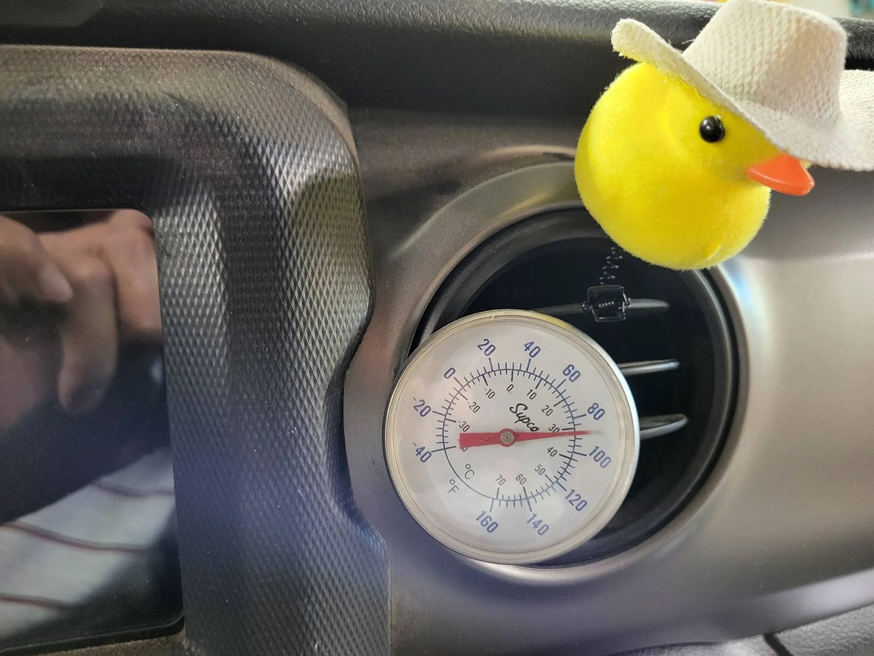

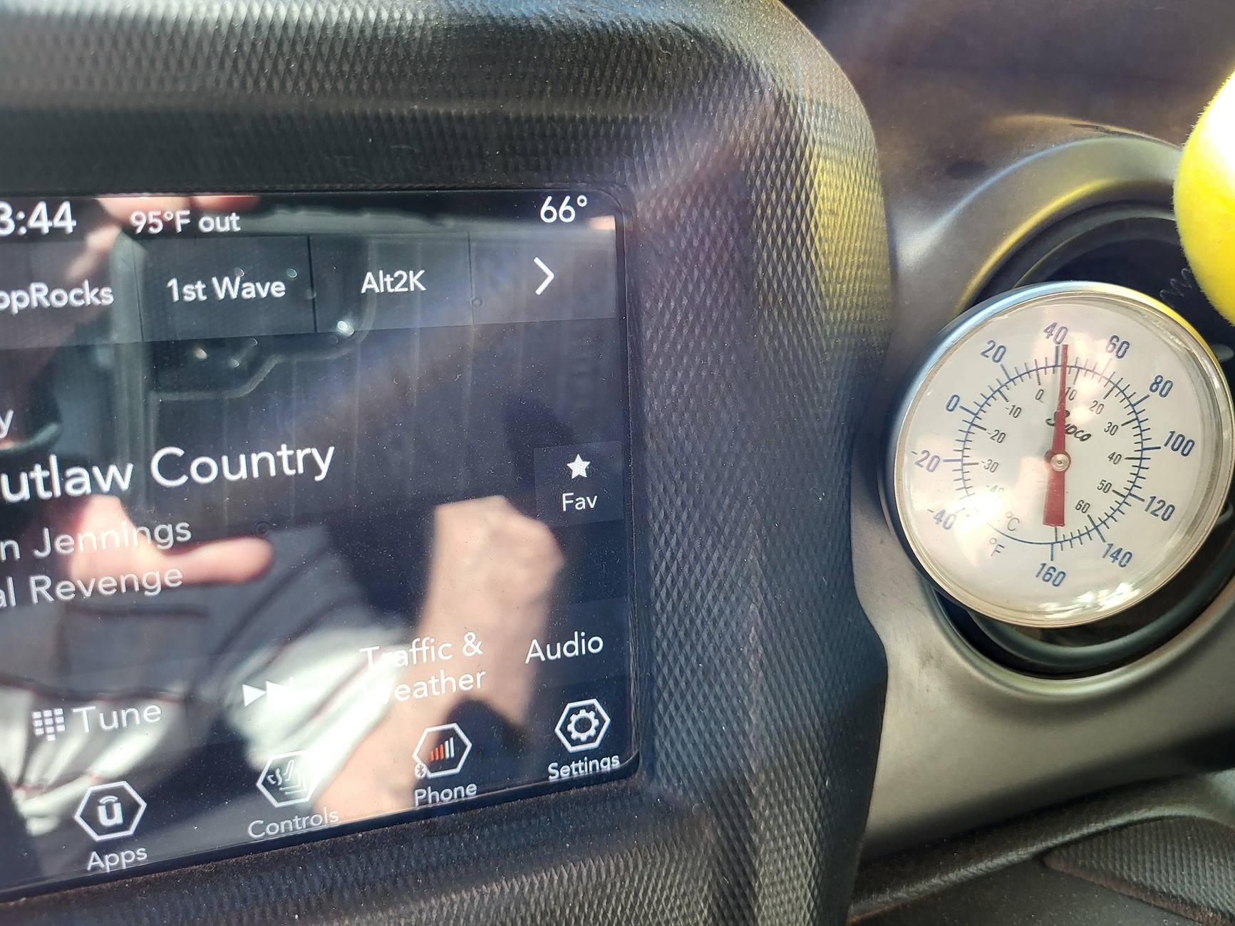

Additional info. Today, dynamic. My perception, higher vent fan speeds are sustainable. First pic, fan 6, second, fan 8. Ambient as shown. Road speed 38-40 mph, 1800-2300 RPM. 7 gear common. (4.10/32.6"OD)
