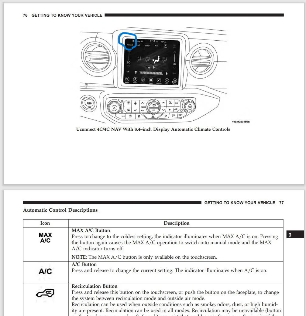

I noted that my AC isn't keeping up with cooling when the temperature is in the 90s or above. I attributed this to my quick and dirty recharge after installing a new engine before a trip. While driving up the San Juaquin valley in upper 90s and above it was not quite cool and relaxing, with the AC blower on the highest setting and the recirculation button lit.
So, today, I thought I'd check the manual for anything I'm missing. It shows that there is a "Max A/C" button on the Uconnect that supposedly does something. I started my JLUR in the driveway and while idling, I couldn't tell the difference between this button on or off. Anyone use this?

I believe it normally changes to upper dash vents (face?), fan at full, temp at coldest and turns on recirculation.
Yes, like every other car with a max AC function.

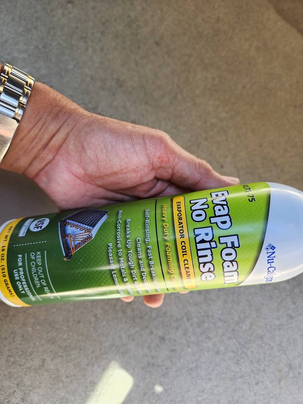

When I stopped by Johnstone Supply for some vac pump oil, I grabbed a couple cans of evap coil cleaner. Since the filter was that dirty, surely something got by and is covering the evaporator. I dumped most of a can into the plenum through the hole where the fan installs. It's a short distance over to the evaporator.

So, the evaporator cleaning was worth maybe 2-3 degrees in vent temperature. It's starting to work almost acceptably. But zero margin with 84F OAT it was able to get it comfortable if I had it on Max and the vents pointed at me.

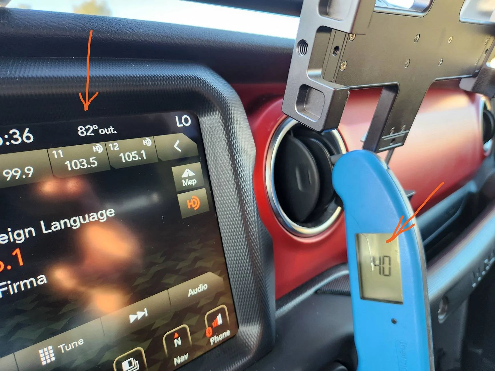

I think I'm done messing with the AC. I'm satisfied. Pulled it down to 500 microns for about 1 1/2 hours and charged it with R134a. This was cruising down the freeway.
Jeep Wrangler JL "Max A/C" AC temps
