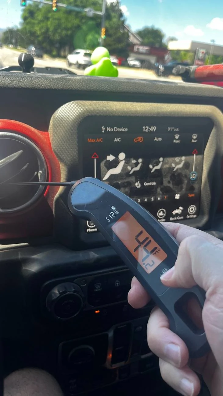

Can I trouble some of you to toss a thermometer in your center driver side vent and run your system on Max next time you drive it and post the temperatures here? I can't get below 44-46F. My truck and my wife's car (both R134a systems) get noticeably colder.
Give me 90 minutes and I'll get on this after my next meeting. I need to go to the store to get some cilantro and jalapenos for my guac anyway. I have one of those infrared thermometers. By noon it should be 90 here and sunny here.

Ask and ye shall receive
Thats running i
Thank you
If you have a regular meat thermometer, I think that would reflect more closely to the air temperature.
Running it for 25 minutes in a drive to the store
Jeep Wrangler JL "Max A/C" IMG_2481
