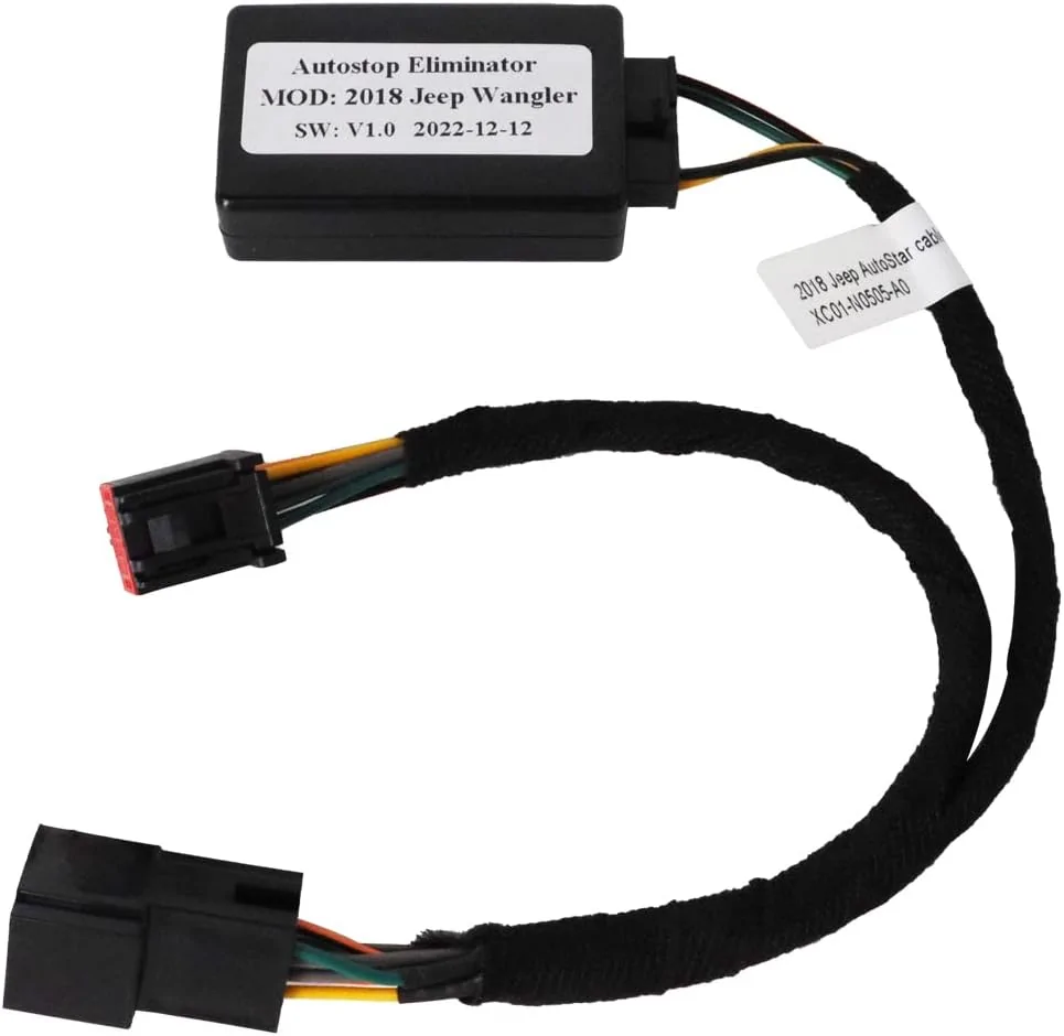

After you disconnect the batteries-expect the electronics to take a while to reboot. That's what I did and everything has been great ever since. The reboot can take hours or sometimes even days-so disconnecting the battery for 30 minutes will restart the reboot process all over again. Once you lose the AUX battery connection from the main battery and pull fuse #42-life will be grand. Later I went to Amazon and installed a memory relay wiring insert behind the climate control panel for $32.00 that remembers to keep the start/stop shut off or on after you manually select the on/off mode.
Jeep Wrangler JL Main Battery questions Citreal Autostop Eliminator for Jeep Wrangler
