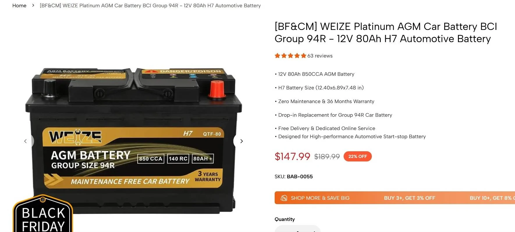

These guys sell on Amazon & have really good ratings. Best way is to buy direct from them & they have free shipping. They don't give a core refund, but you can take your core to Advance or Autozone for a $10 gift card. Their prices are outstanding.
https://www.weizeus.com/collections/platinum-auto-battery
Jeep Wrangler JL Best main battery? weize j
