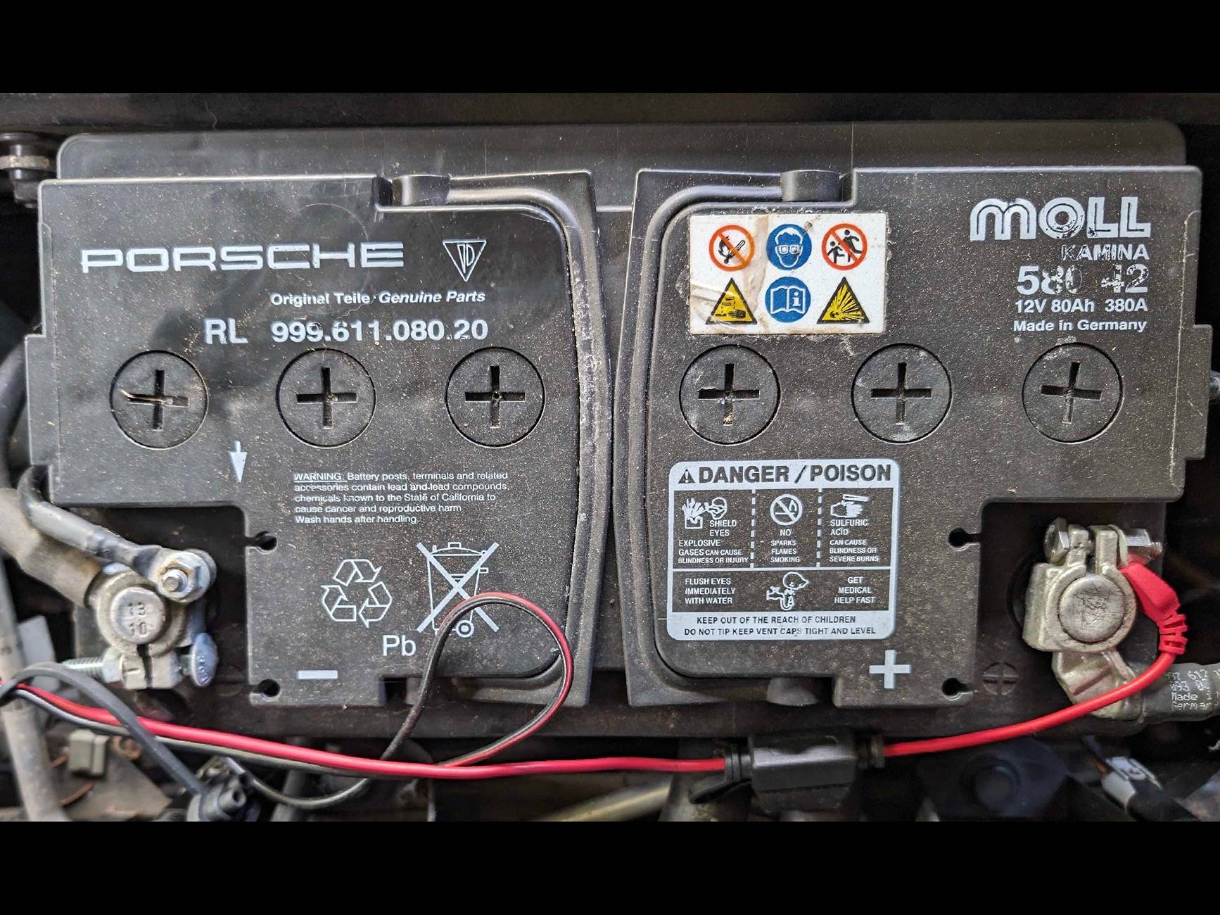

1 Jeep - 7 years shitty AGM everyone hates - both main and aux are fine
2 Porsche - 12 years really shitty Maintenance Free - replaced just last year
3 Benz - 15 years really shitty Maintenance Free - is fine
4 Subaru - 8 years really shitty Maintenance Free - is fine
Provided that any OEM battery is kept separately smart charged and separately desulphated - or simply used daily - that battery should last a reasonably long time in our lame feeble experience. Often over 10 years even parked outdoors 24/7.
However if not properly maintained - 12V batteries may fail to hold a charge after only a relatively short amount of time. The Jeep seems particularly bad with 2 dissimilar sized batteries hooked up in parallel. The most idiotic ill-advised system devised. As the weaker battery effectively kills the stronger battery. Now this applies either way. Aux kills the main - or main kills the aux.
Currently our main is slightly weaker vs our aux by 0.1V. But both are still fine. Jeep can sit for a week outdoors and fire right up. Start stop is available after a minute of driving after sitting outdoors. But my expectation is at some point down the road - the main will fail a hot load test - before the aux. Use is for driving in the winter for skiing and SB. So very cold temps.
Since our charging protocol has worked flawlessly year after year for 20 something years - we have no intention of changing a thing. Just realize there may be a better way and that these OEM batteries - even AGM Jeep or some third party - may not necessarily be complete shit.
Your wife's car and daughter's car batteries lasting 5 years sounds very normal to us. As is generally very easy to tell when a battery is starting to fail without a hot load tester. Electrics start to go a bit wacky. Starter is slow to crank or simply cannot start. Our Porsche had the windows drop down a couple of inches at a time - and not go back up. Could not crank to start. I recall first lasted 4 years with no smart charging - this one lasted 12 on CTEK but was never desulphated. Because CTEK did not have this repair mode. NOCO do. So use those now. Have 2 CTEK and 5 NOCO. Yeah have a race boat and other 12V toys.
So recommendation for those concerned. Really take care of your batteries - and they should last a decent amount of time. 1 or 2 or 3 years is complete BS. But some seem very content with this. Ok. Chk.
Probs we are just lucky. Haha!
