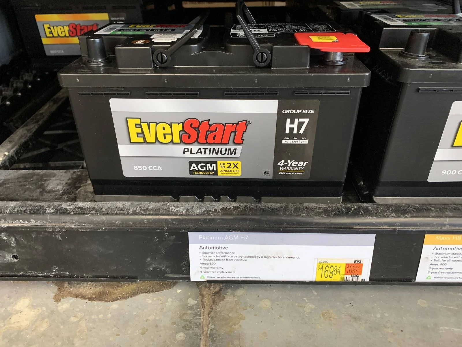

yes - replace that battery. I like the Everstart batteries found at Walmart. This is from a few months ago so the price will probably be higher.
I bought that same one earlier this month, it's like $180 now.

Correct, 180 at Walmart, just looked. Better than orieilys or advanced, they want 250

Pull fuse 42, disconnect the aux battery, put in the new battery, crank up and go. Your Jeep will now work just like cars have since the early 1900s. BTW, the Walmart Everstart, at 850cca, is almost as strong ar the 2 Mopar batteries together (200Cca, 700cca) plus you get a 4 year warranty.
