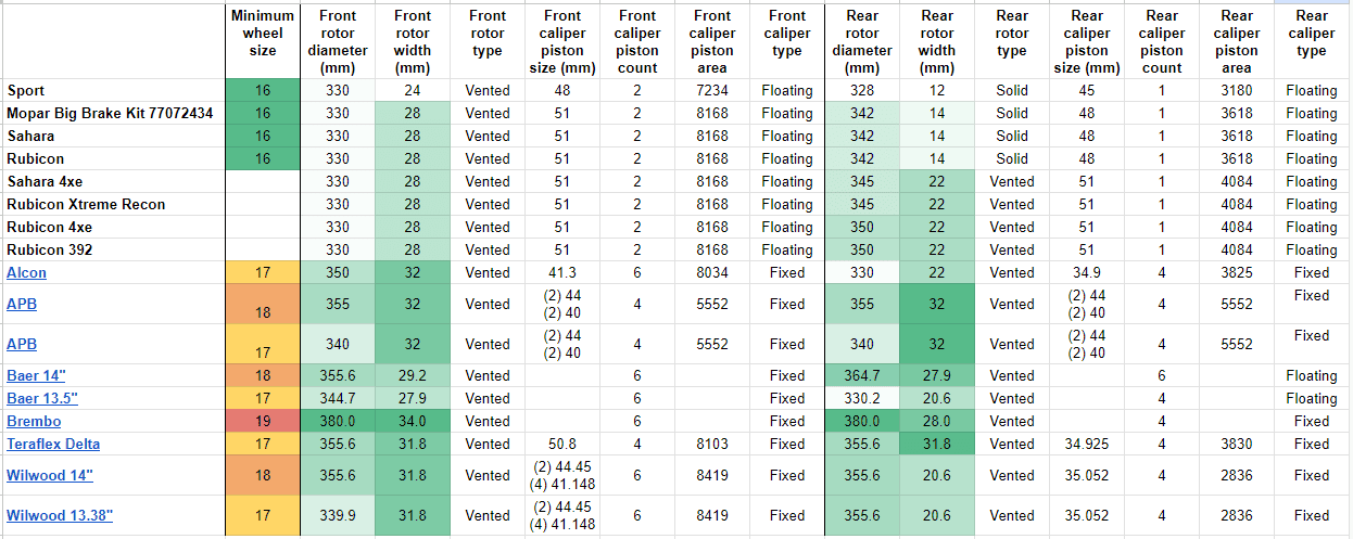

So I'm not sure the brakes on an X are any bigger than the ones that come on the Sahara and standard Rubicon, but that could be researched. So are you satisfied with the ride height now that you have the shocks and airbags in?

ok - the salesperson made a big deal out of the this option which is listed on my build sheet - "ANTI-LOCK 4-WHEEL DISC PERF BRAKES (BR4)" maybe this comes in a standard Rubicon and not just the X ? looks like that might be the case from the chart above.

Rear brakes are larger, wider, and vented according to the chart.

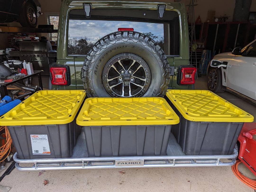

my next adventure is to look at reinforcing the hitch. I have a Pakmule carrier I hang off the back and even thought it is probably only loaded to 200lbs including the rack itself - the factory Class 2 hitch is a bit of a tinkertoy for any sizeable cantilevered load. I have been trying to see what the 5000lb rated Class 3 factory hitch is (Rubicon's with 33" inch tires) - but no one seems to have seen one of these - even the dealers parts books are unclear. I assume it must attach directly to the left and right frame rails and not just the center connecting frame member. I am not looking to tow 5000lbs but think the twist moment on this frame member is significant and can be improved. I have a full machine shop and TIG/MIG/Plasma etc. so I will fabricate if I can't find the factory Class 3.
Jeep Wrangler JL Lower a 2024 RubiconX PAKMULE photo
Yeah the Gladiator's class 4 looks like it would be much better for that kind of load. Not sure if it would be a direct fit but could be a good starting point for a fabricator... Unless you want to start from scratch.
