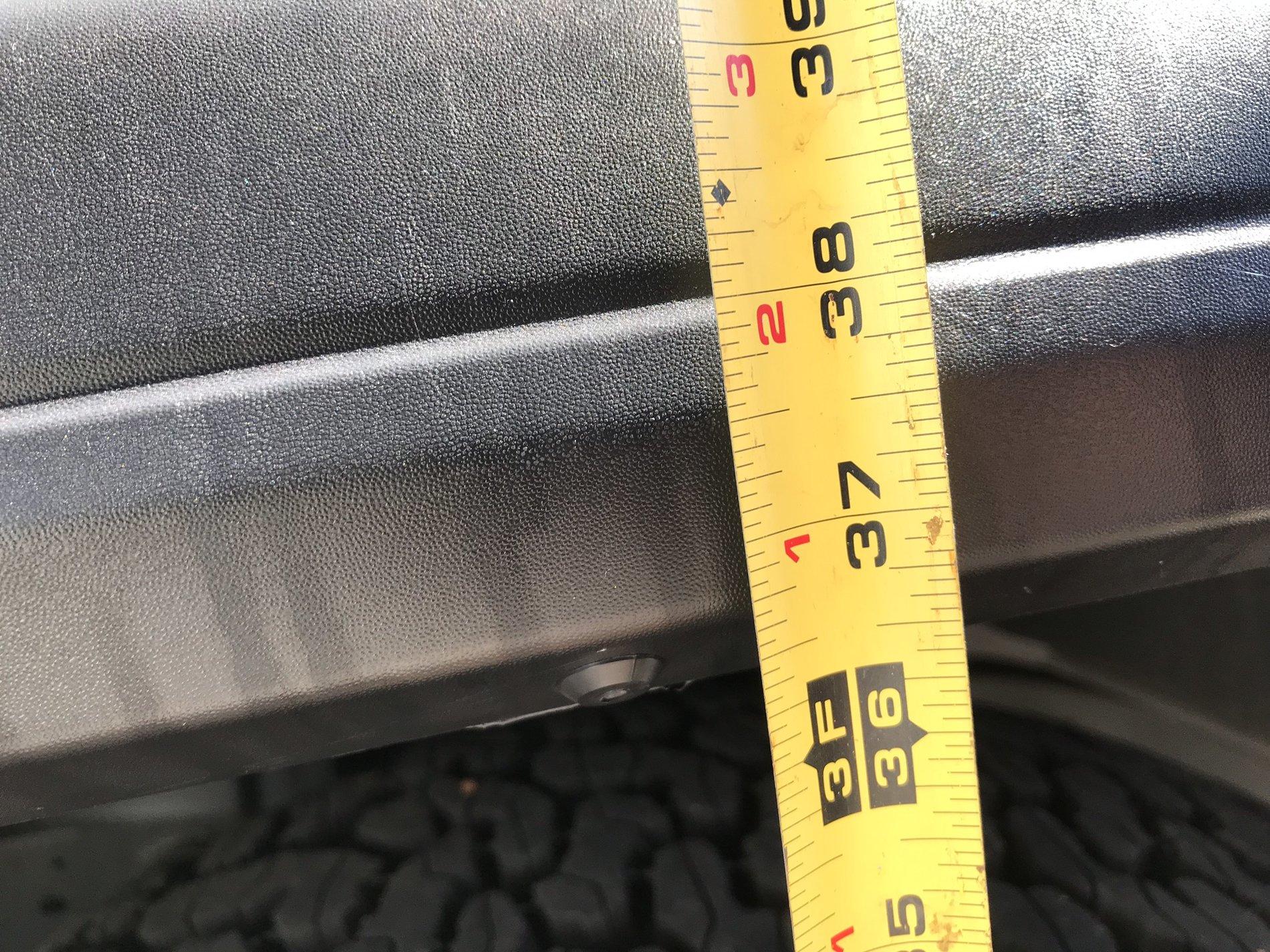

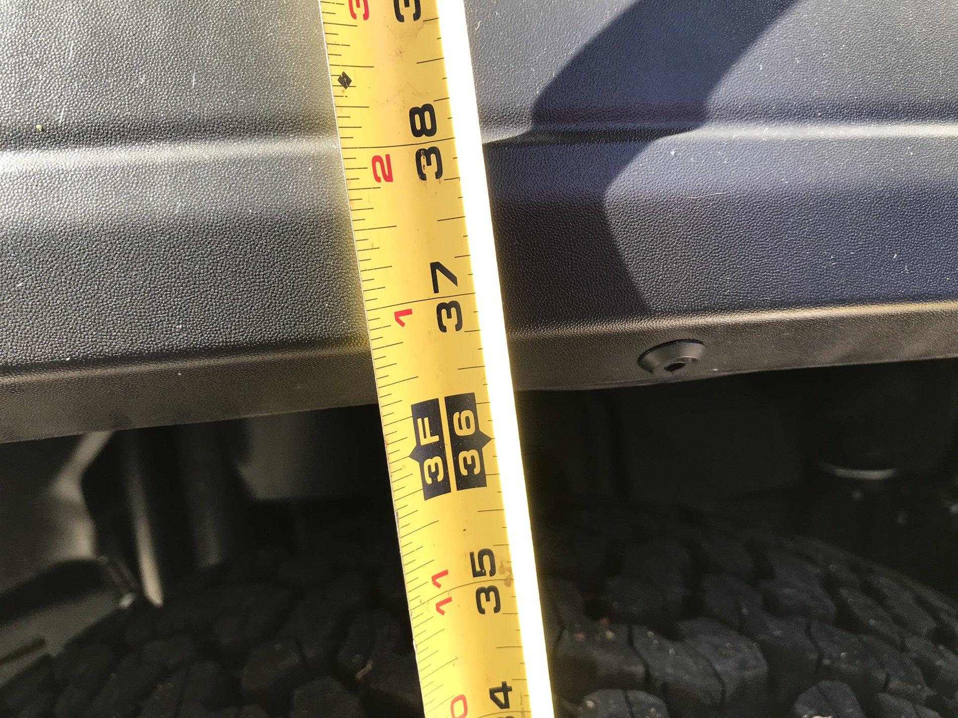

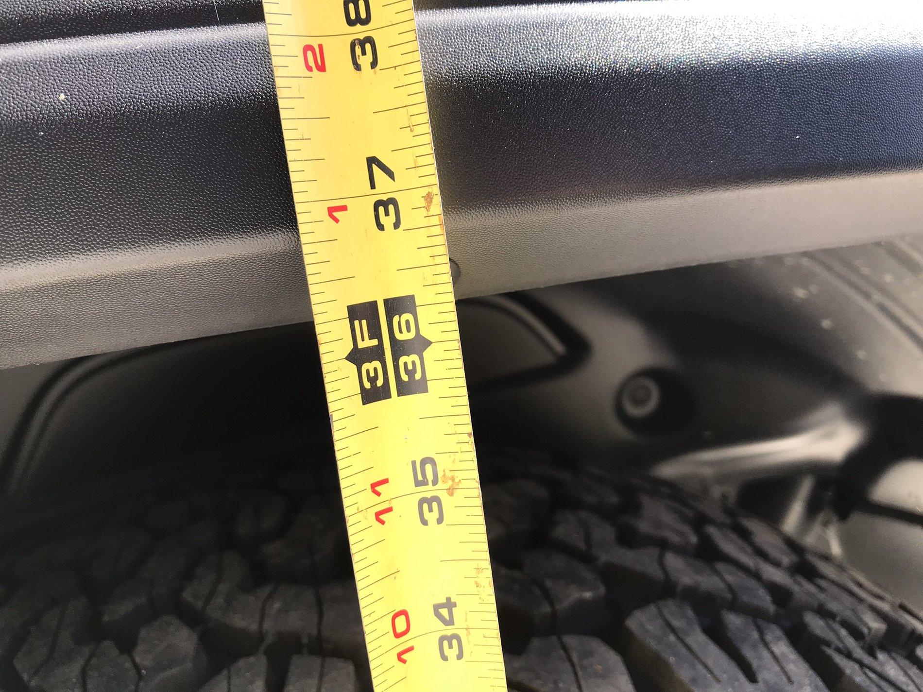

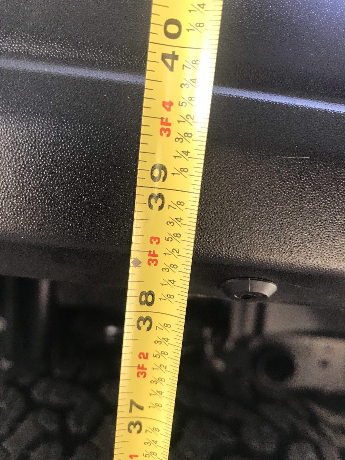

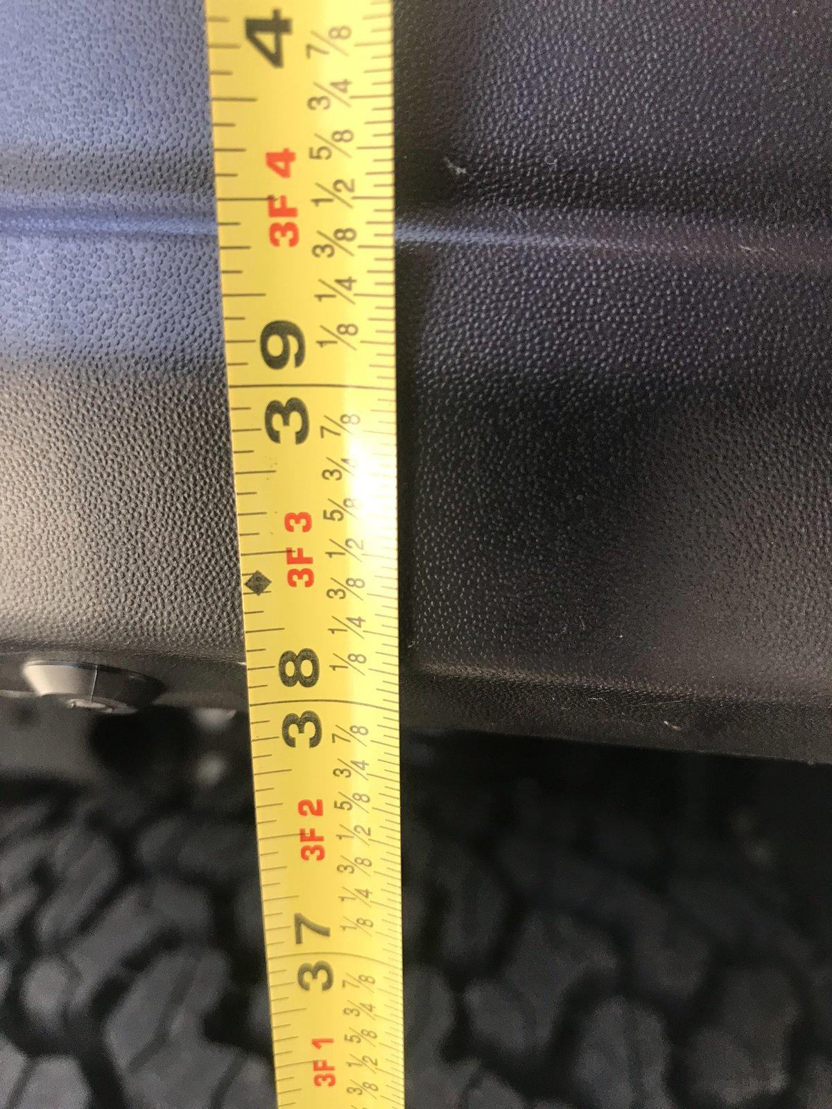

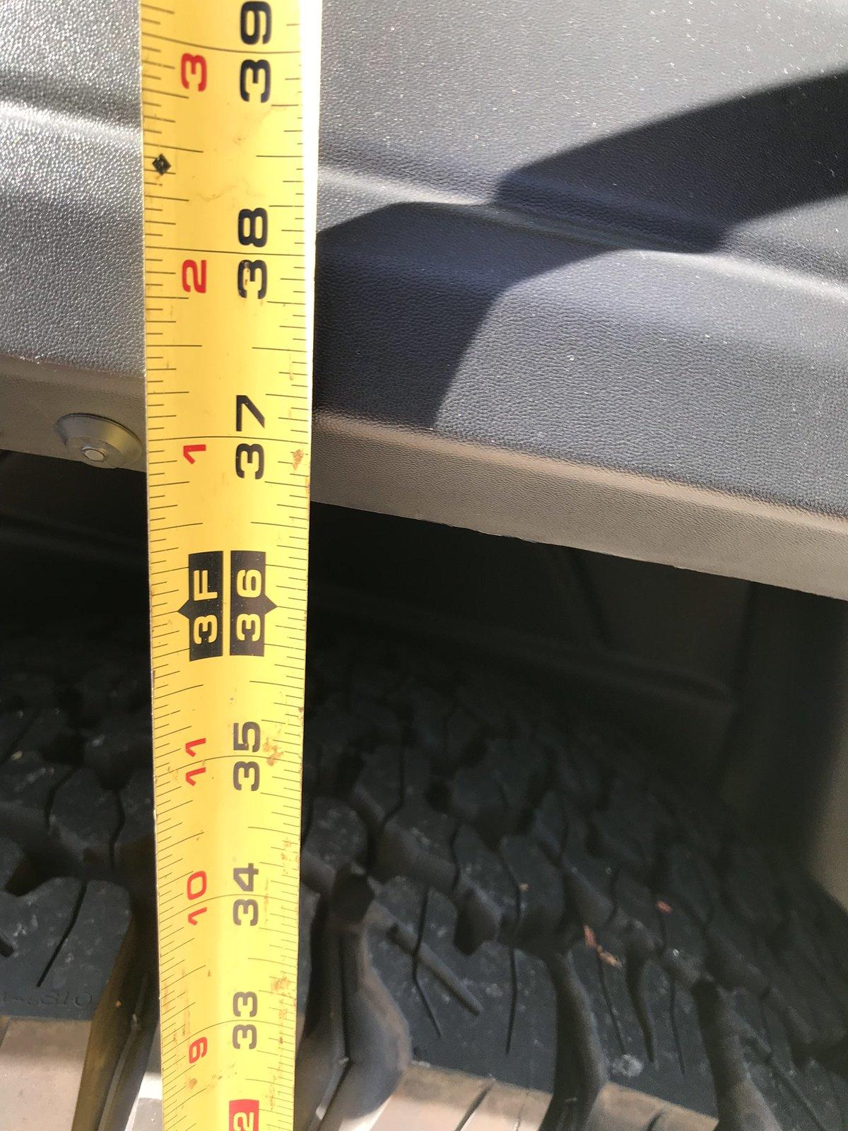

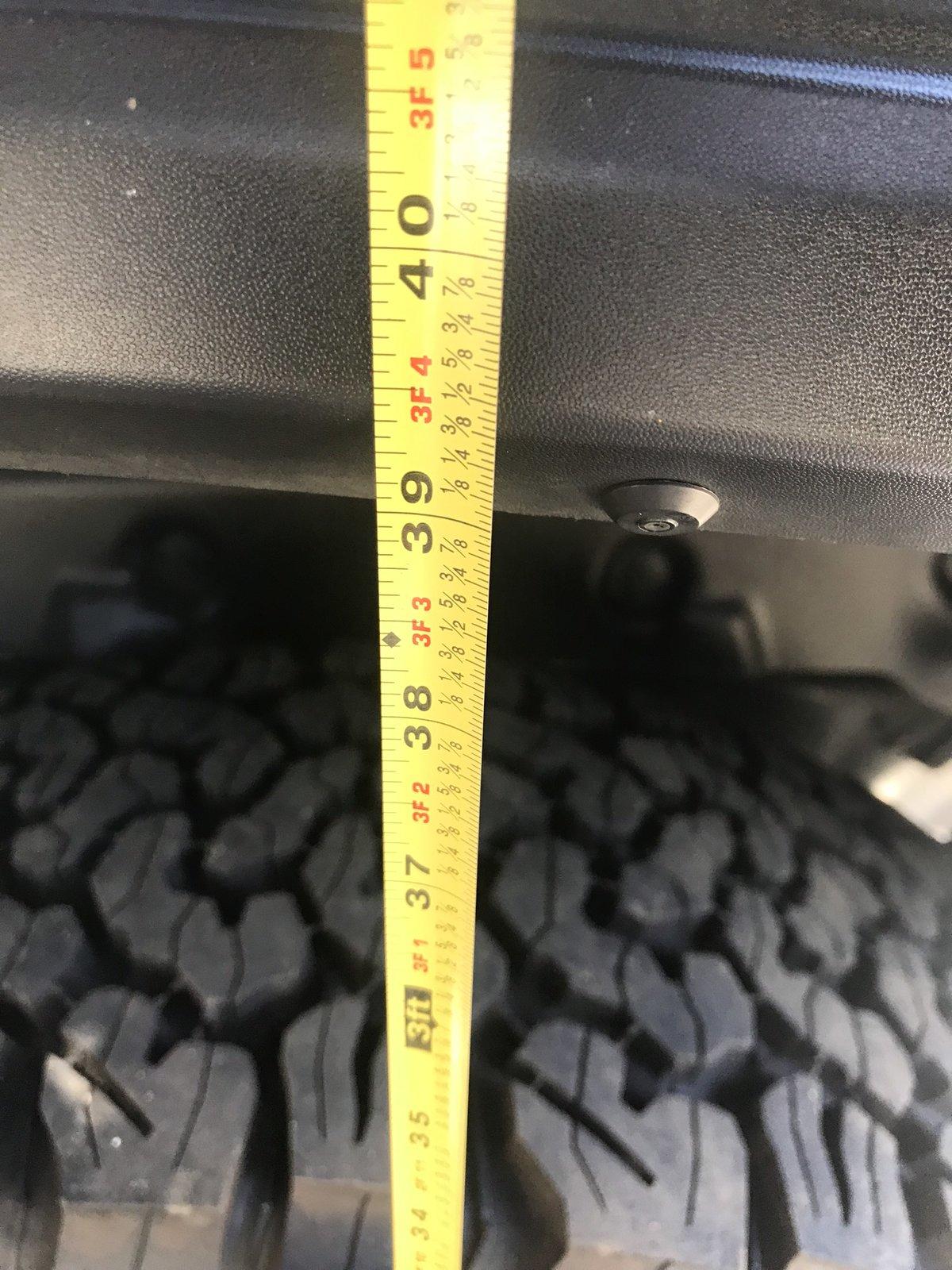

I just wanted to give everyone an update. I did end up purchasing a rubicon suspension off of a hardtop and steel bumper JLUR. Recently got them installed and wanted to note 2 things. For one, I gained about a 1/2in in the front fender (36 1/2 to 37in) and about 1/2in the rear (36 3/4 to 37 1/4). While I was hoping for more in the 1in range, still an improvement. Ground clearance to the front dif and rear dif increased a 1/4in and 1/2in respectively. As far as ride quality goes, I have not noticed any difference. Overall maybe not as much height as I was hoping for, however I did get an improved suspension so ill take it.

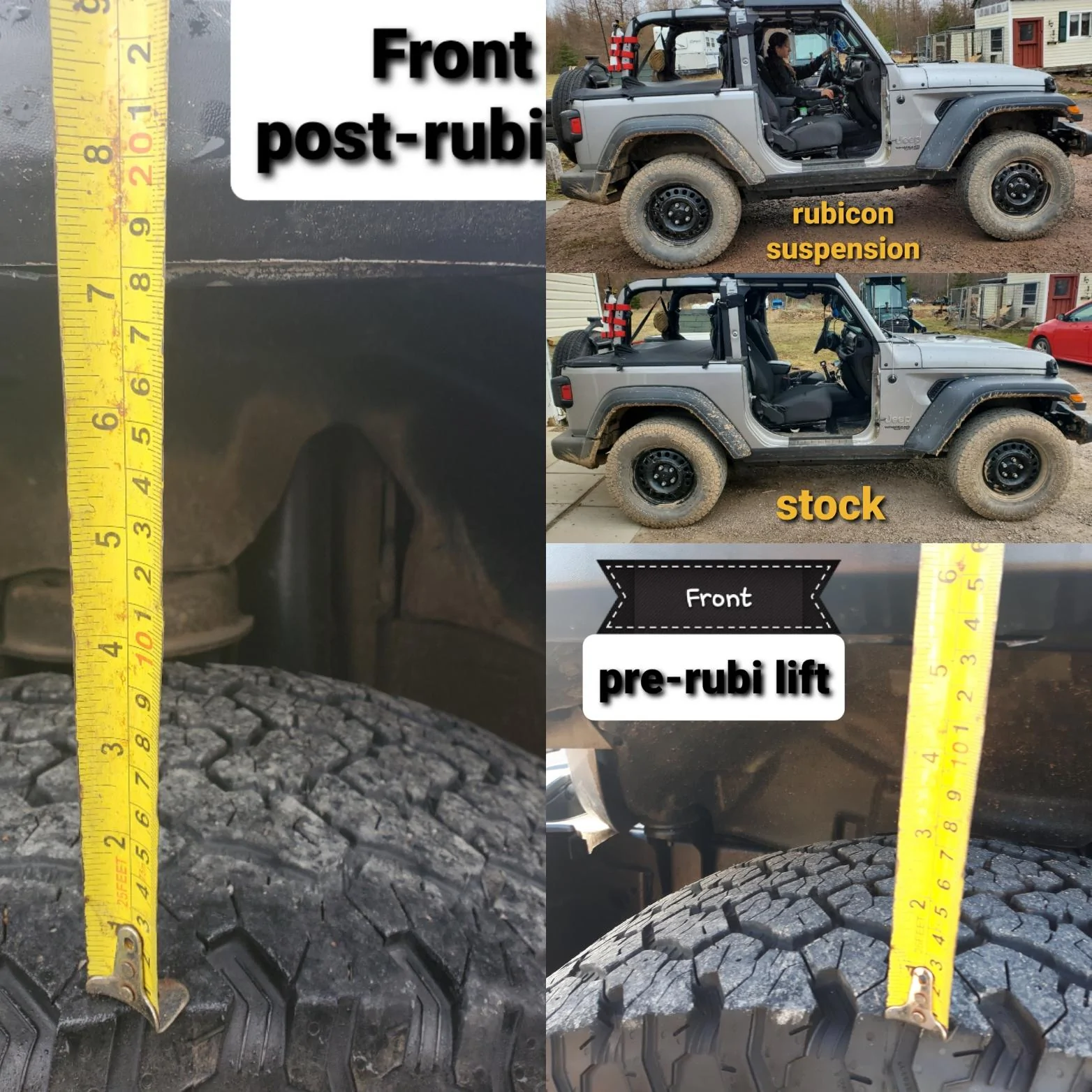

Results....
Jeep Wrangler JL Using Rubicon Suspension on a lower model? IMG_20200507_090411
I figure between 1.75"and 2"....
I believe the rear coils were 90 and 91... off of a steel bumper, tow package 4 door Rubicon...

Looks great!
Yes, this is the expected gain with Rubicon JLU springs installed on a JL.

I was a bit surprised myself as well seeing how most said I should get around an inch. Complete shot in the dark but maybe since I have a D44 rear on a Sahara I had slightly higher coils than a non D44 Sahara. I believe the tags are still on so I'll see if I can crawl under the jeep tomorrow and get them.

You're on to something. It's possible your JLUS started higher, so the difference is only 1/2"

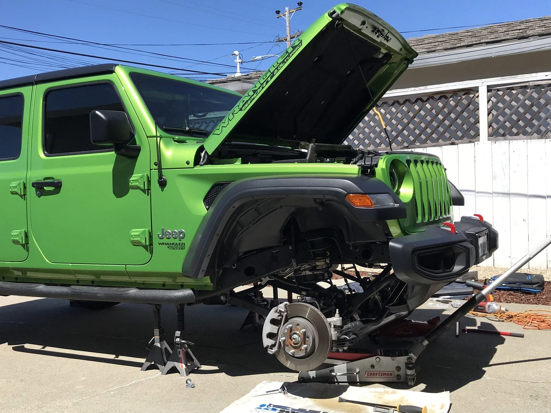

I got mine from a tow package Rubicon . I believe the last digit was 91 and 92 for my spring. I added 1/2 teraflex spacer The here is the picture . The first four are in Order: Front Driver Side - Front Passenger - Rear Driver - Rear Passenger. The last 4 are after the install. Same arrangement
