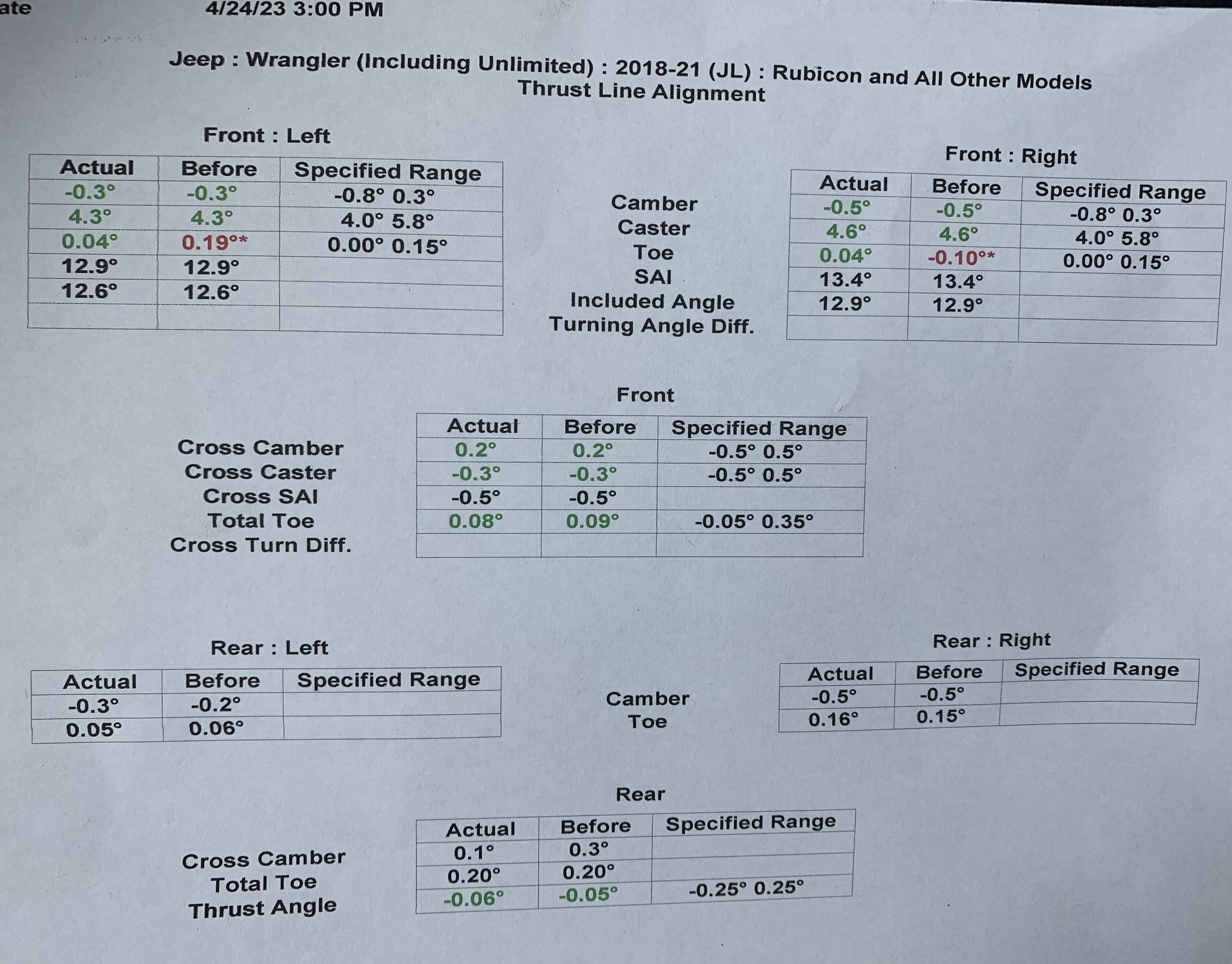

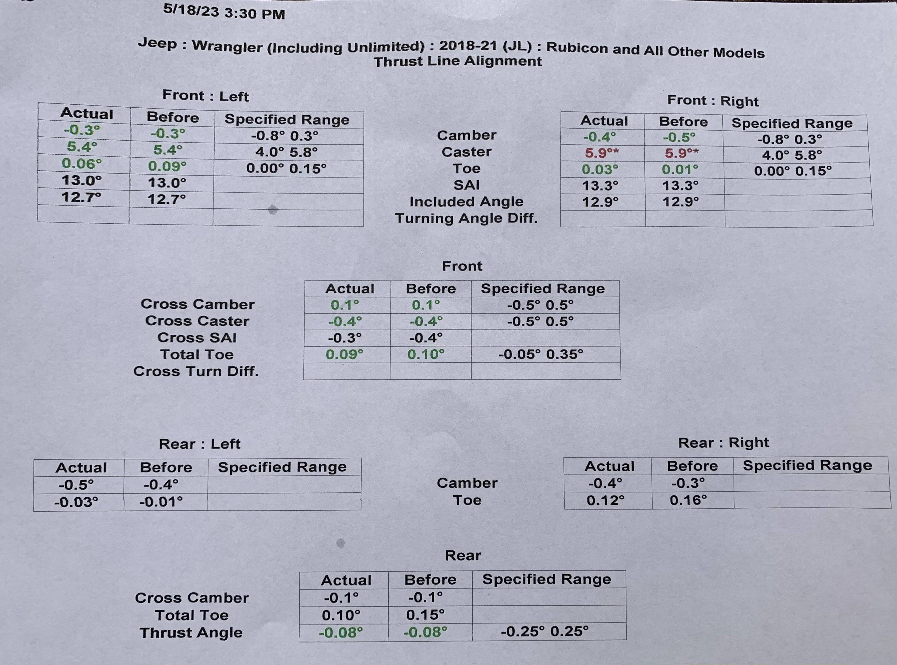

My XR drove very good before the Mopar LCAs swap, both local and highway speed. I was just looking for small projects. Honestly it feels a bit better, I still have a slight pull doesn’t bother me. Tracks a bit better. To me it’s not too obvious or that much of a difference. No regrets anyway. You can tell the caster angle difference. If you don’t consider additional lift, the factory LCAs are fine as long as it tracks well to your liking. If you will go taller, adjustable LCAs may be the way to go.
