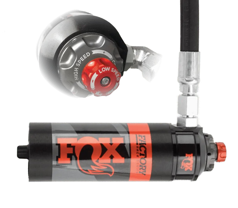

Sure……..
Jeep Wrangler JL Reservoirs worth it? FOX-2.5-JL-DSC
Fox 2.5 Remote Reservoir Shocks
Fox 2.5 Remote Reservoir Shocks provide an excellent ride quality, long term durability and heat capacity. Remote reservoirs reduce the operating gas pressure, friction and heat inside the shock by allowing more volume for the nitrogen to expand. Remote Reservoir Fox Shocks deliver the performance necessary for hard off-roading. The Fox DSC Adjusters are great for dialing in your ride on changing terrian and changing weight. Turn the low speed knob to tune performance on g-outs, handling, and road feel (cadillac vs race car). Turn the high speed knob to tune performance on sets of whoops and find the right balance between bottoming and harshness on big hits such as square ledges and pot holes.
