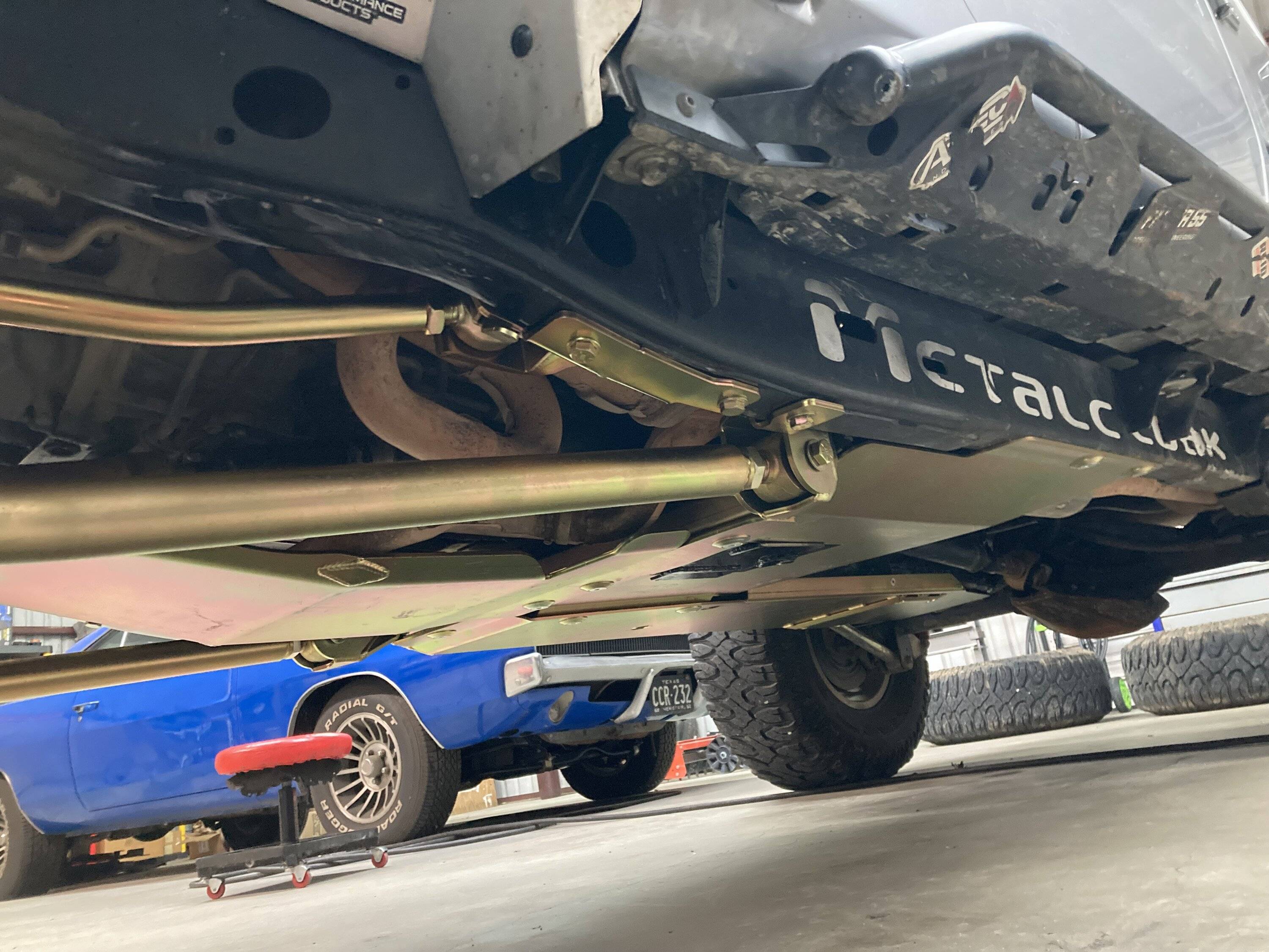

How did you accommodate longer arms? Either the front axle had to move forward or replace the frame mounts for the CA. Other wise they are effectively the same length. Adjustable arms will allow for just caster correction.
