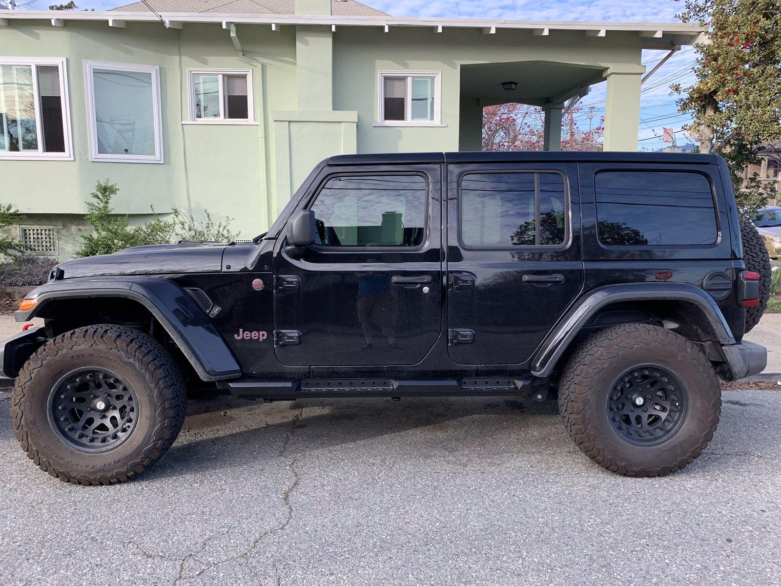

Installed my Destroyer Sliders today. I’m amazed at their tolerances. The sliders were a tight fit over the washers for the body bolts, but with the proper alignment, they made it perfectly. I haven’t drilled the holes yet as I didn’t have a drill that would clear, so I’ll come back to that.
One of the bolts didn’t screw into the frame. I’ll ping @lodoffroad about that directly. Overall I’m really happy with these.
