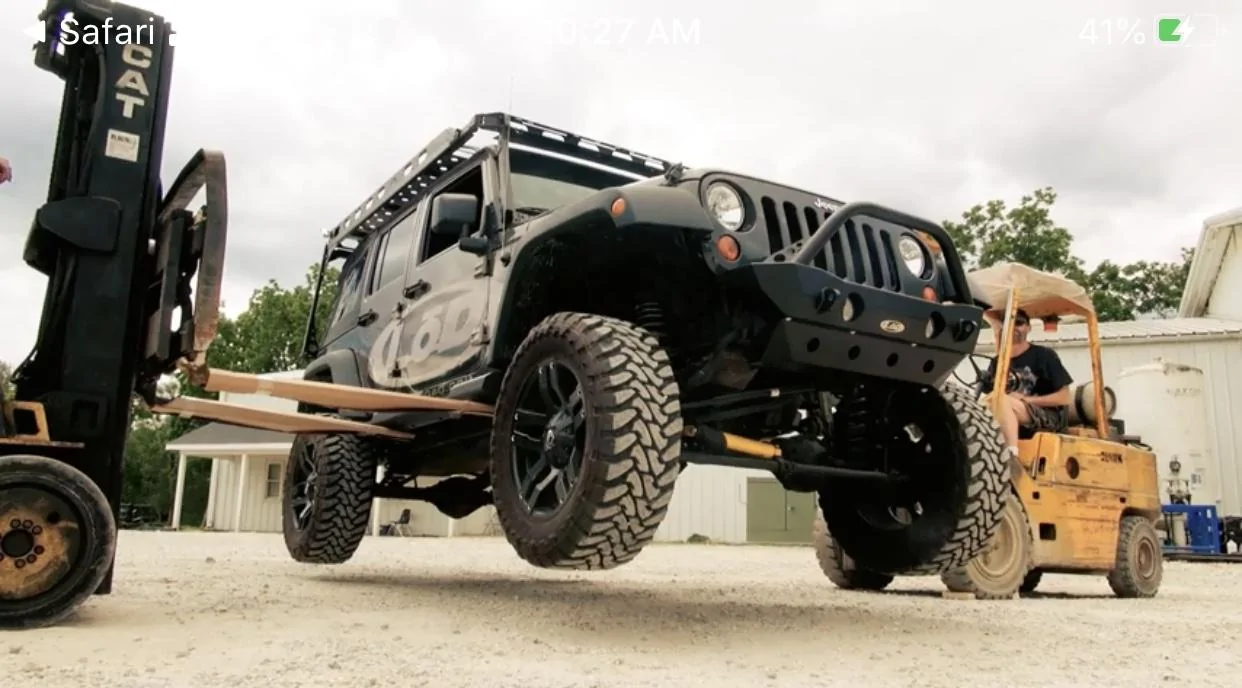

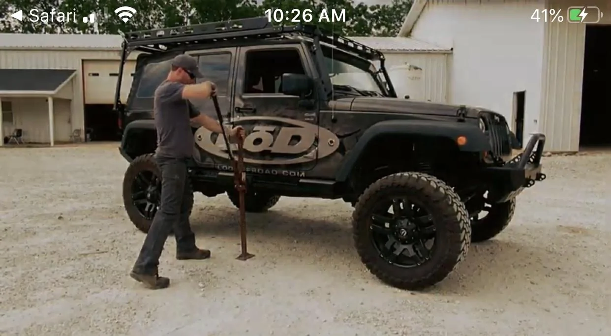

Wow ... this has me concerned. I just installed the destroyers yesterday. Now I am reading these comments today. I do feel misled. After watching the LOD video on YouTube of using a high lift jack and then lifting the Jeep with two forklifts .... I decided to make my purchase. Granted, the Jeep in the video is a JK. I can’t imagine that makes much of a difference. Please share your ideas on beefing things up as you mentioned. @Headbarcode
thanks.

In playing around, I lifted the side of mine with a set of forks. I took pics of lifting by the wheels but forgot to grab some when the forks were under the rail.
There's an incredible difference of force between a lift and an impact.
I don't feel misled, but reading LOD's comment about the Signatures being stronger than the Destroyers left me wishing that was mentioned in the product description.
JLU's are a couple hundred lbs lighter than JKU's, due to fewer crossmembers used the the frame because of the higher tensile strength steel that afforded the same structural integrity with less overall material used. Plus, the weight savings from all the aluminum body panels, doors, and aluminum clad magnesium tailgate.

We don't try to mislead anyone about the performance of our products. The Destroyers were designed for light trail use and to offer a better step and styling. If you call and talk with us, we would recommend the Signature slider if you think you'll be hitting them hard. The Destroyers are a sheet metal design and therefore will have a little more flex in them than the Signature sliders which are a square tube design and much more rigid. But '"Hitting Hard" is subjective and the force generated due to impact can be huge and is highly variable as well. We have designed enough gap between the slider and the body to account for the flex, however we have found that the body on frame alignment can be significantly different from side to side. We have also noticed that the frame flex's more on the JL than the JK. There is not much we can do about that, so there is potential if you hit the sliders "hard" enough that they may hit the body. But that would need to be a pretty good hit...
