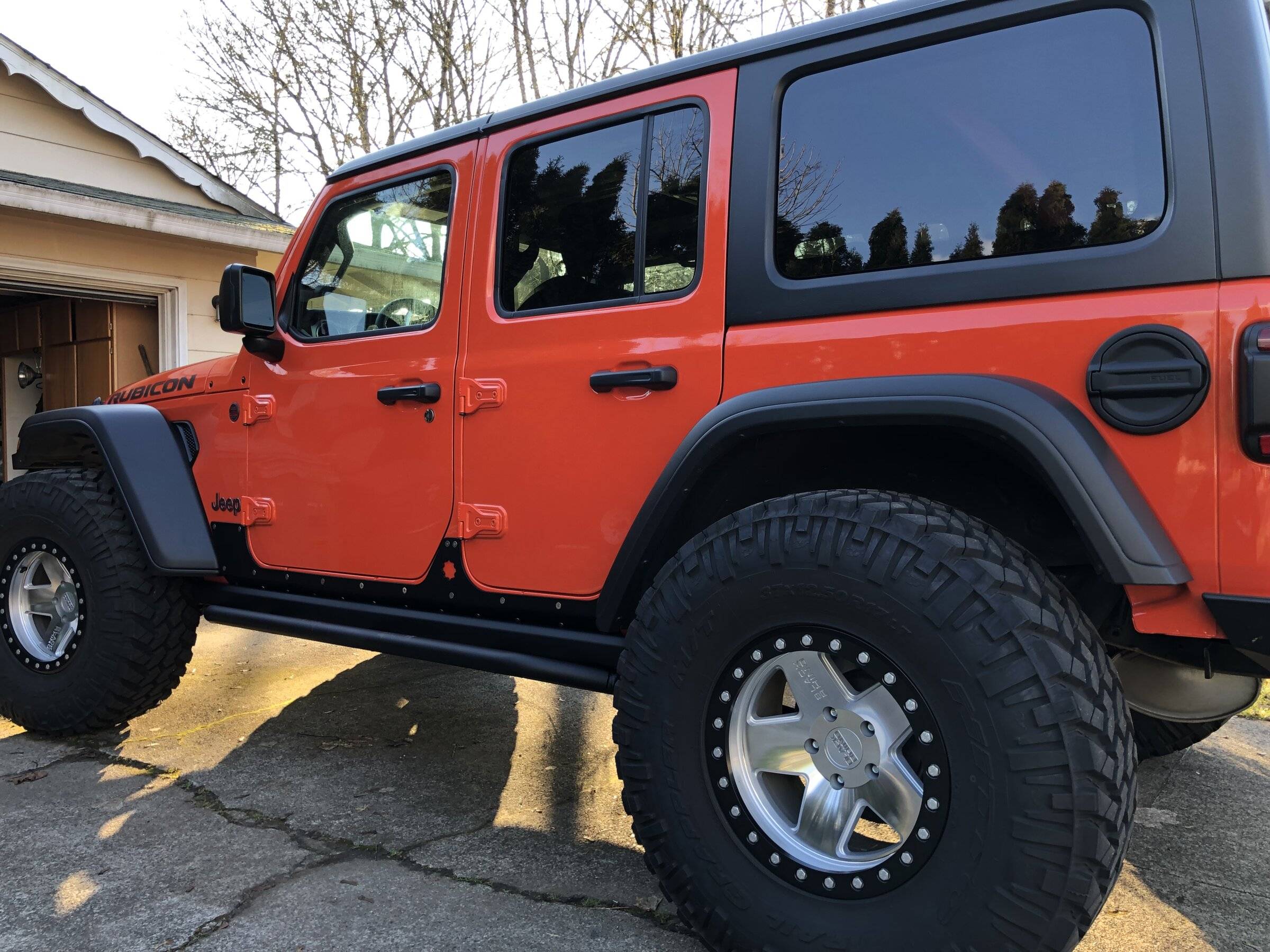

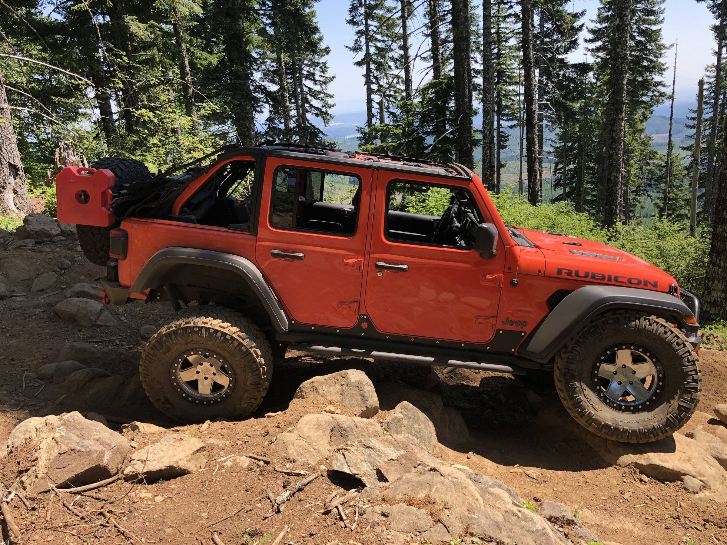

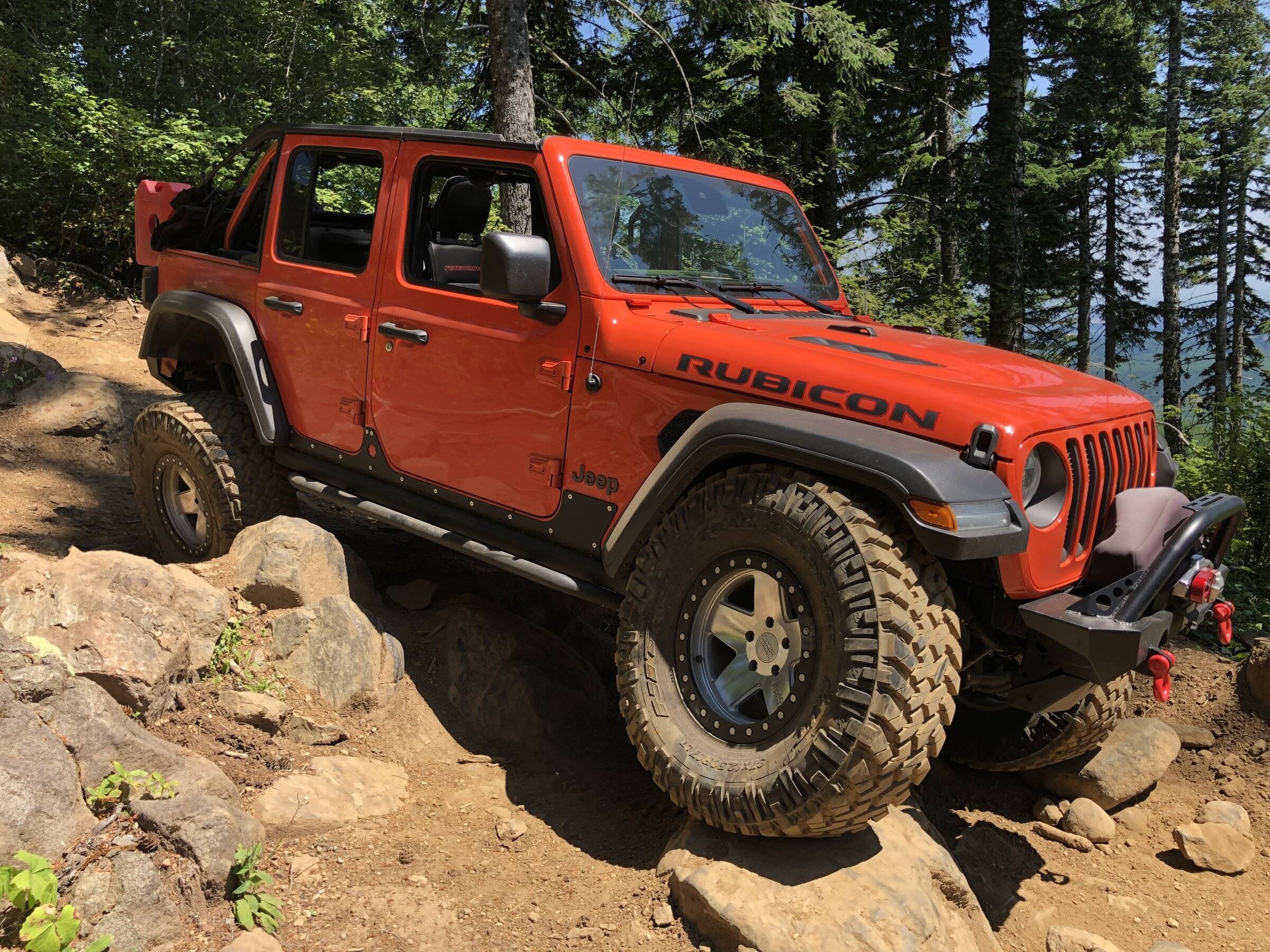

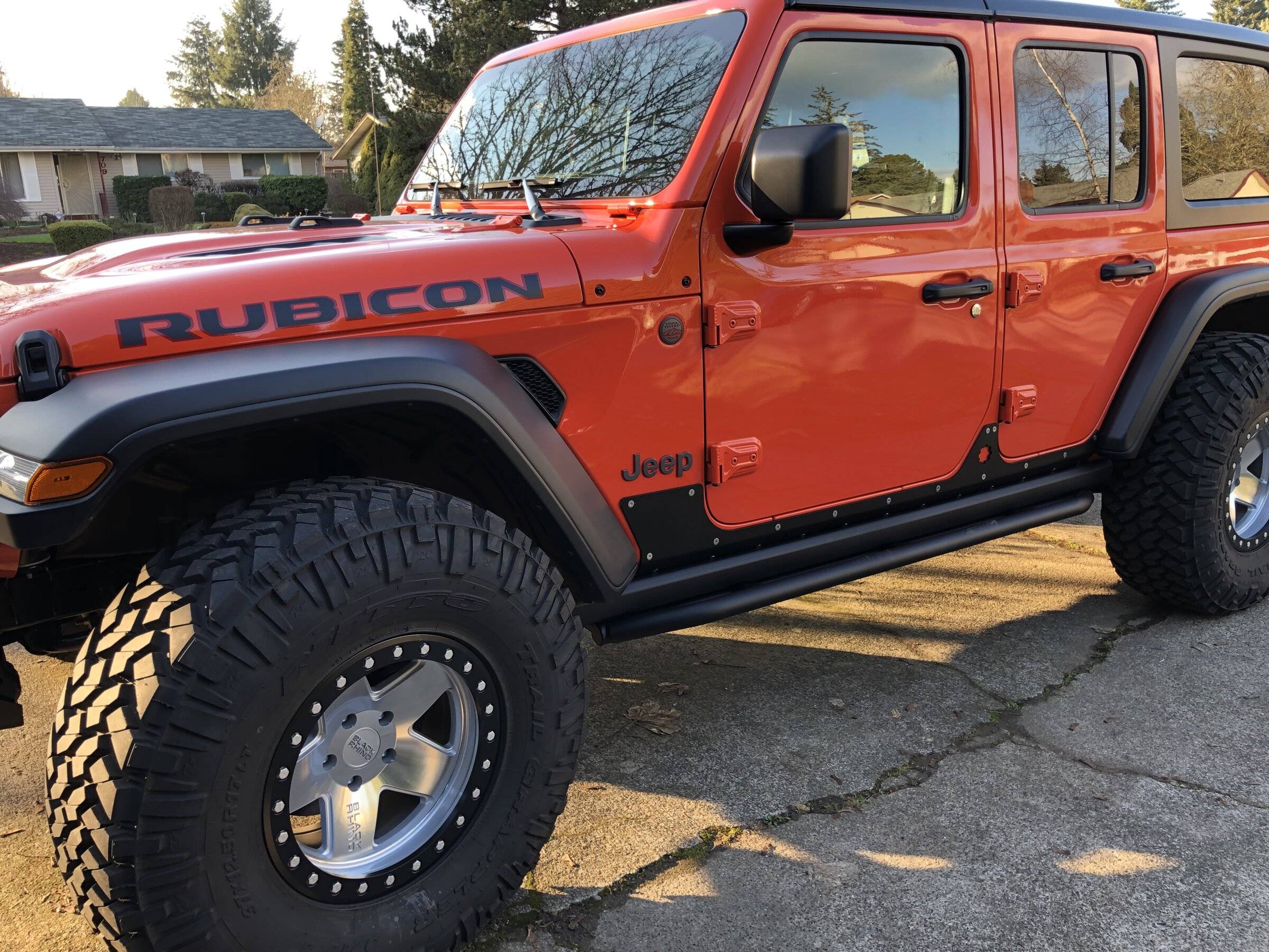

Jeep Wrangler JL LOD destroyer sliders issue 031CFAD7-0CC0-4D18-A875-3267193283BB
Jeep Wrangler JL LOD destroyer sliders issue 2F207B99-5B92-4760-A1B7-7A08FBA61CC1
Jeep Wrangler JL LOD destroyer sliders issue 32CD7B66-85D2-42B5-88E4-4D01B7B4C132
Jeep Wrangler JL LOD destroyer sliders issue 98A73D0C-86D0-4AA5-A0F2-9D1E67378BDB
The reality is any slider will flex, as will the surface it is mounted to. More gap is not necessarily better. Most won’t have the stomach for what I did (lots of drilling on that brand new Jeep body) but I run Ace sliders with Ace rocker protectors AND the factory rubicon sliders. Everything is basically 0 clearance, but the load gets spread out along a much larger surface so I can bash rocks with 0 damage. I was actually not impressed with the Ace products at all (terrible welds, shady powder coat, and poorly positioned mounting holes on the rocker protection), but they’ve been pretty indestructible. The 2 bottom photos are pre-lift, but the best close-ups that I have of the rocker protection. If you’re gonna wheel a $50k Jeep, don’t whine when you get a little body damage. I don’t blame LOD for a second, they offered you a discount for a different set of sliders, they didn’t need to offer anything. I don’t really understand what you mean when you say they left you hanging for 4 months, they don’t owe you anything. This activity causes damage, get used to it.

You have body mounted sliders. You might want to rethink posting your "solution" in a thread about frame mounted sliders. A Jeep's frame and body are designed to move relative to each other and if someone tried this with frame mounted sliders it wouldn't be pretty.
Oh, and you get extra points for being so sensitive to people whining about body damage. Nice looking Jeep BTW. /sarcasm/

Uhh, they are frame-mounted sliders. They bolt to the body mounts on the frame. There is still a tiny bit of room for movement, but impacts get spread to the entire rocker panel instead of one spot, and there have been plenty of impacts. Try again, harder this time.

No, they bolt to the body mounts and flex with the body. The LOD Destroyers mount to the frame and completely avoid the body mount. They spread the impact to the frame, assuming there is enough clearance between the slider and the body. Just sayin'

You realize the body mount is just an ear on the frame don’t you? The sliders mount to bottom of the solid ear, the body sits on top of the puck which sits on top of the solid ear. The ears don’t move with the body. Keep trying though.
a 50K Jeep? Where do you find that!
I agree with what you say about damage, this has been the hardest decision on my build, my wife is even making fun of my Indecisiveness, BTW your jeep looks great!
