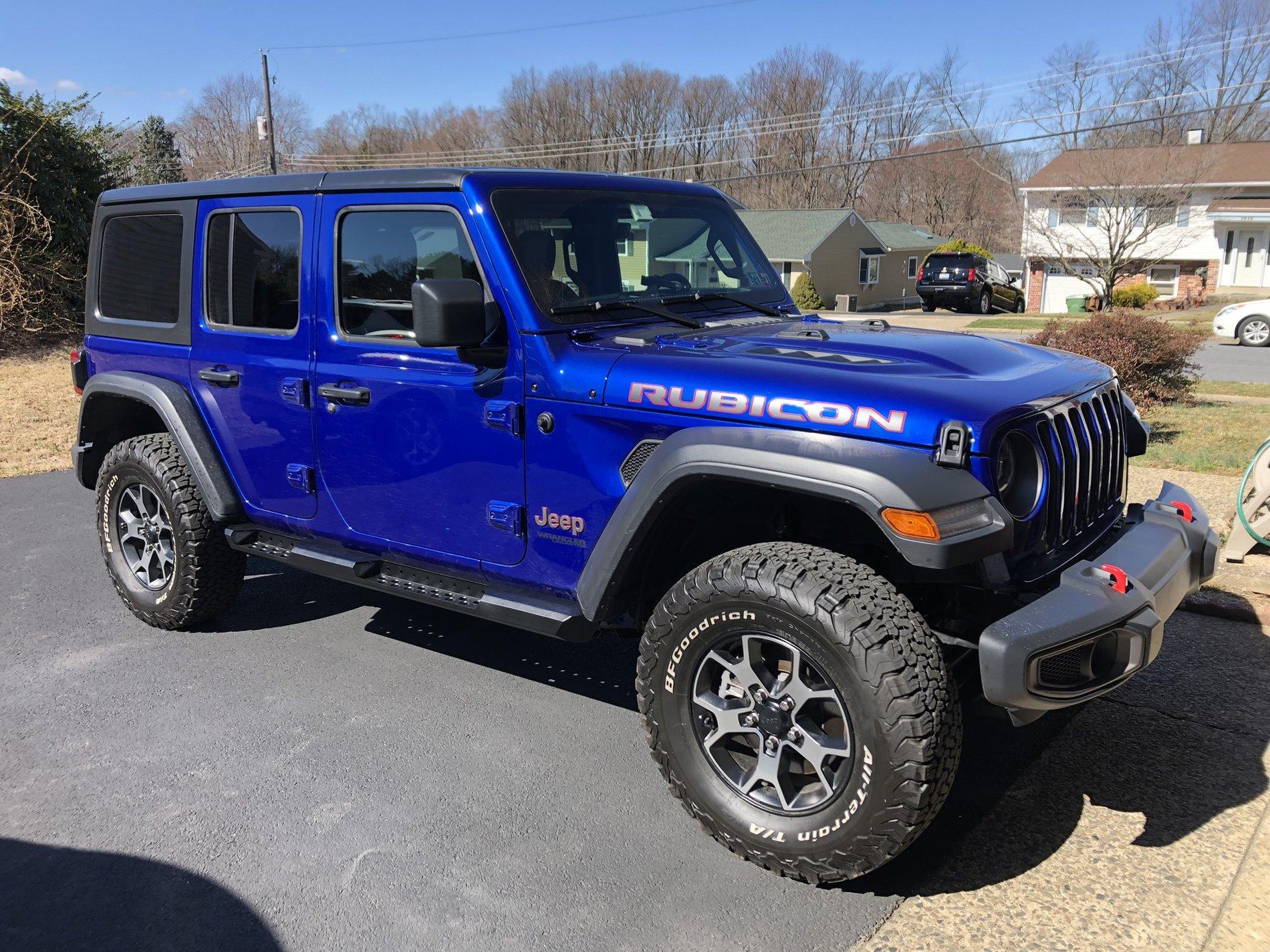

Make sure you have the right hex bolts. I installed a pair last week and received the wrong ones. Went to a machine shop to get the right ones. Check out this thread.
https://www.jlwranglerforums.com/fo...ling-lod-signature-sliders-broken-bolt.24658/
Yeah, I read that thread last week and confirmed I had the right bolts before I started, but thanks for the heads up anyway. Bolted them up this morning with no issues. No idea on the torque values though. Drilled for only one of the three optional bolts (the forward most one with the long bolt). I’ll drill out the other two and install the self tapping bolts later.
