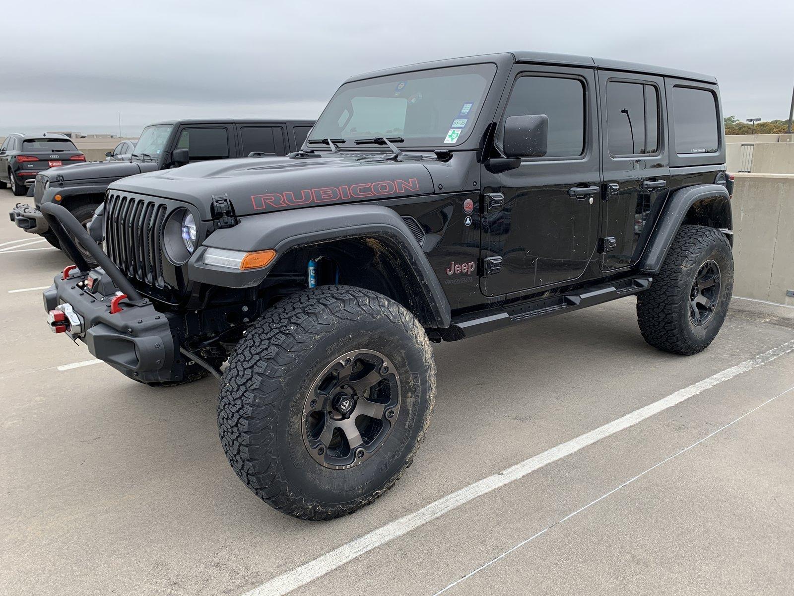

Installed.

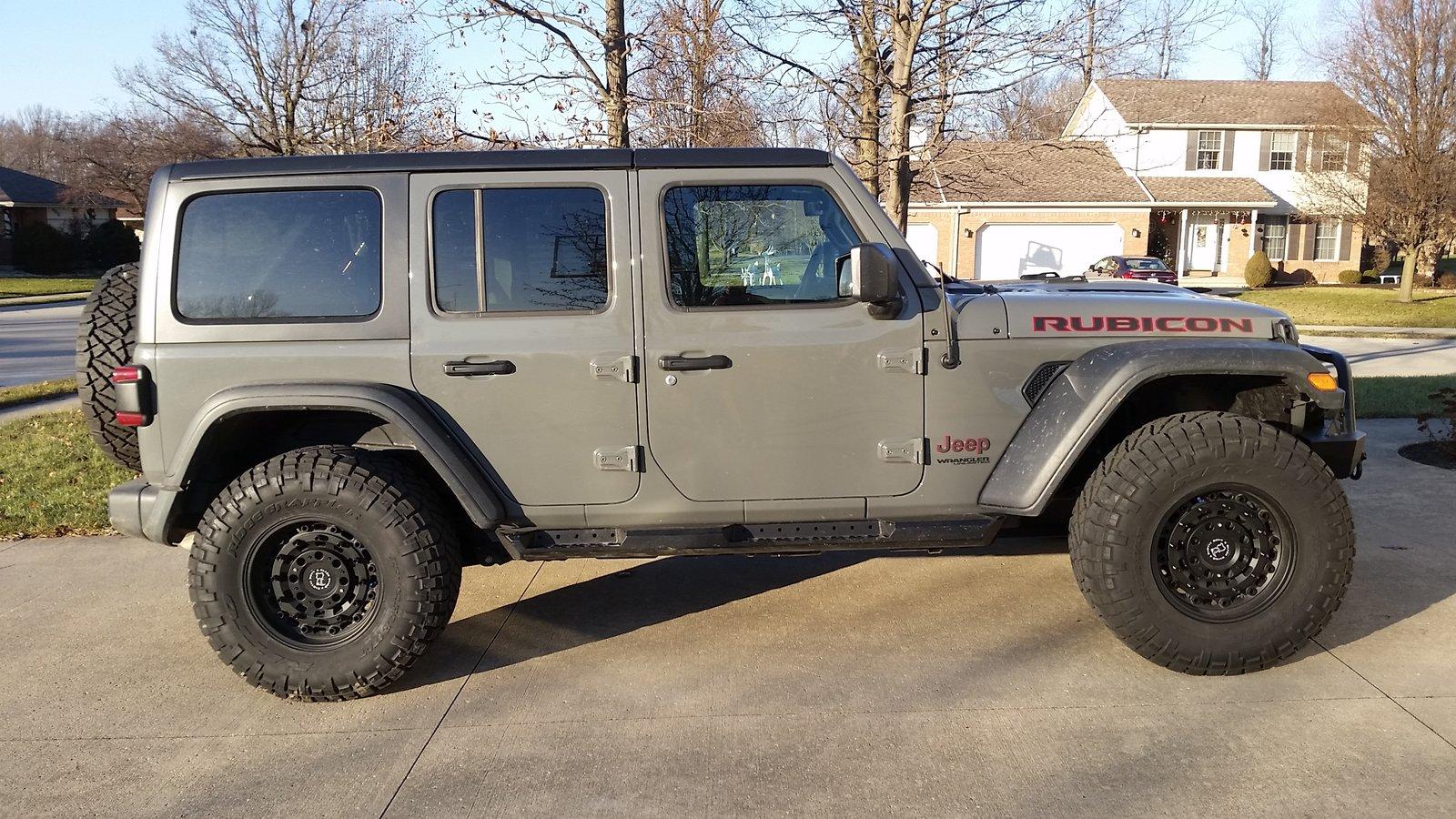

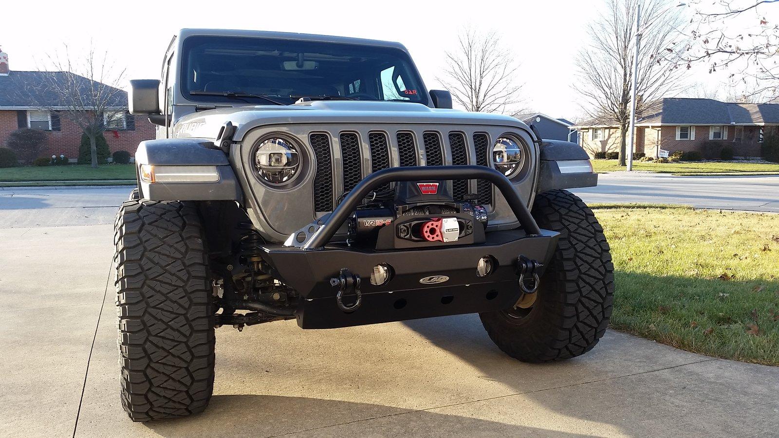

Incredibly happy with my LOD Destroyer sliders and Destroyer stubby bumper!!! The fitment and packaging on the bumper was 100% top notch, one of the best aftermarket installs I have done. The family loves the easier access gained with the sliders while also providing major protection. Win Win from LOD!
Glad to hear it! Your Jeep is looking AWESOME!
