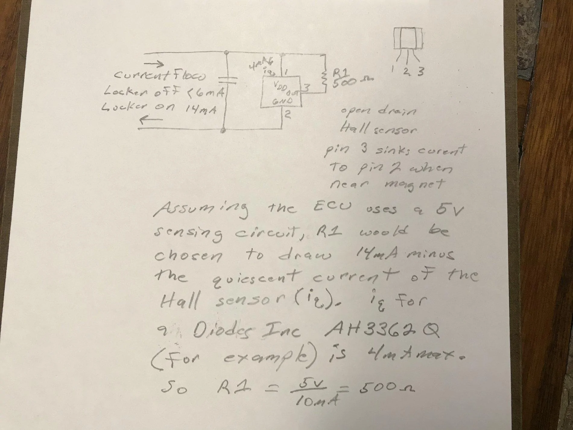

I’d sure like to investigate one of these sensors, to see if we couldn’t identify the specific components in there. Hall sensors are made by many manufacturers. I would expect this position sensing to use a very simple type Hall sensor. I also assume it’s the Hall sensor itself that’s failing, but wouldn’t know that for certain before troubleshooting one.
I imagine it may be difficult to acquire a failed one, since it goes back to FCA if the axle is being replaced under warranty. But, if anyone out of warranty has a failed non-potted sensor and sends it to me, I will do my best to find a fix for this.
Hall position sensors are not what I typically work with, but I have been doing circuit design since 1984, and have many contacts with component manufacturers, Hall sensors Included.
Does anyone know of this sensor ass’y communicates over CANbus, or does it emulate a simple switch closure? How many wires go to the sensor itself?

Awesome, thanks for pointing me to that. Much groundwork has already been discovered! Attached is a crude sketch and rationale on how we might emulate the currents measured by CaJLMetalHead.
We’d have to verify what voltage is present at the sensing wires, to select the right R1 value. We’d also have to land on the right magnetic Gauss trip points. There are various part numbers having different trip points, etc.
R1 may very well be integrated inside the TE proprietary Hall sensor, explaining why we don’t see a discrete resistor on the pcb.
”R1” could be replaced by a regulated current sink circuit, to make the sink current independent of supply voltage.

good job.. unfortunately, I do not own a Rubicon so I cannot further test the interaction between the module and the sensor.. I did some search for Hall Effect sensors with similar characteristics as the one I found in the sensor module.. and I found a few... but then I gave up because I needed to reassemble my axle housing and also because I naively thought FCA was going to solve the issue in short term... LOL.... this is so pathetic.. having to replace an entire axle because of a simple sensor..
I wonder if Jeep Cares has better access to the current state of this issue... is TE Connectivity going to release the sensor to the market ? are we going to be able to buy the sensor from MOPAR or other sources?
I actually think the addition of the sensor to the locker is a really cool feature allowing the computers to know if the locker is actually working ... pretty neat.... now, TE Connectivity... please fix the damn sensor! LOL

I see Diodes Inc makes a specific line of Hall sensors for this application. They use only two pins, and switch the supply current between a low and high value, based on proximity to magnet.
Here is a link to a datasheet:
https://www.diodes.com/assets/Datasheets/AH323xQ_AH327xQ.pdf
Now if we could identify the correct Gauss operating point to pick the right part number. I’d guess these are the type of sensor in our assemblies. Digikey has these for just over $1 at quantity of one.
Any other electronics people out there to either concur or offer different thought?

I agree. Isn’t that ridiculous, to replace the whole axle ass’y! Geez.....
I interact with a few component distributors and a couple TE people. I suppose they couldn’t officially share much if anything about the specs on that TE sensor. But I am going to ask.....
