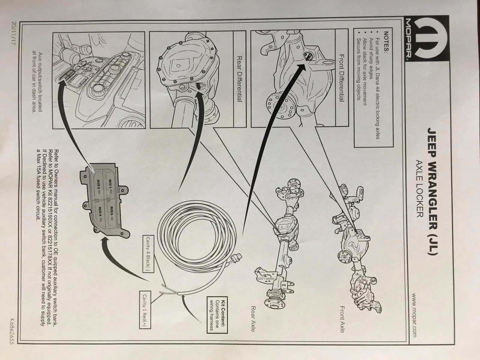

Thanks...This is very helpful! I jist bought the mopar aux switches and 2 of these locker harness kits for my jlus to wire up the lockers while adding takeoff jlur axles.
According to my dealership, no, he said Mopar wouldn’t sell something that voids warranty.Will this not void your warranty?
Not a big deal for me, just a “service axle locker” message when start engine then goes off, a little chassis symbol on above fuel gauge, no beeps, buzzers or dings. But if this is something that would bother you then you can get the tazer jl mini, the new firmware is going to have enable lockers feature, I think it will be out next month. Its great though, it’s nice not having to crawl to be all locked up.A Mopar branded harness that throws a code on the dash and doesn't use the locker engaged indicator properly? That's odd. Cool mod. But odd that they'd sell something half-assed like that. Usually the Mopar stuff is more expensive because it makes everything work like it came from the factory that way.

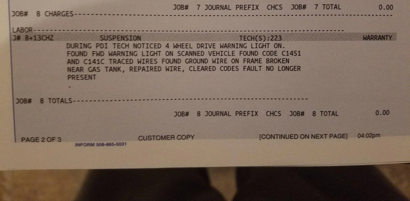

I had the same issue after installing my switch. I thought it was odd that a factory Mopar switch would create an error code so I brought it to the dealership for my first service and have them check it out. They were able to fix the problem for me and said they found a bad ground wire that was causing it. Then they cleared a code and I haven't had a problem ever sinceNot a big deal for me, just a “service axle locker” message when start engine then goes off, a little chassis symbol on above fuel gauge, no beeps, buzzers or dings. But if this is something that would bother you then you can get the tazer jl mini, the new firmware is going to have enable lockers feature, I think it will be out next month. Its great though, it’s nice not having to crawl to be all locked up.
