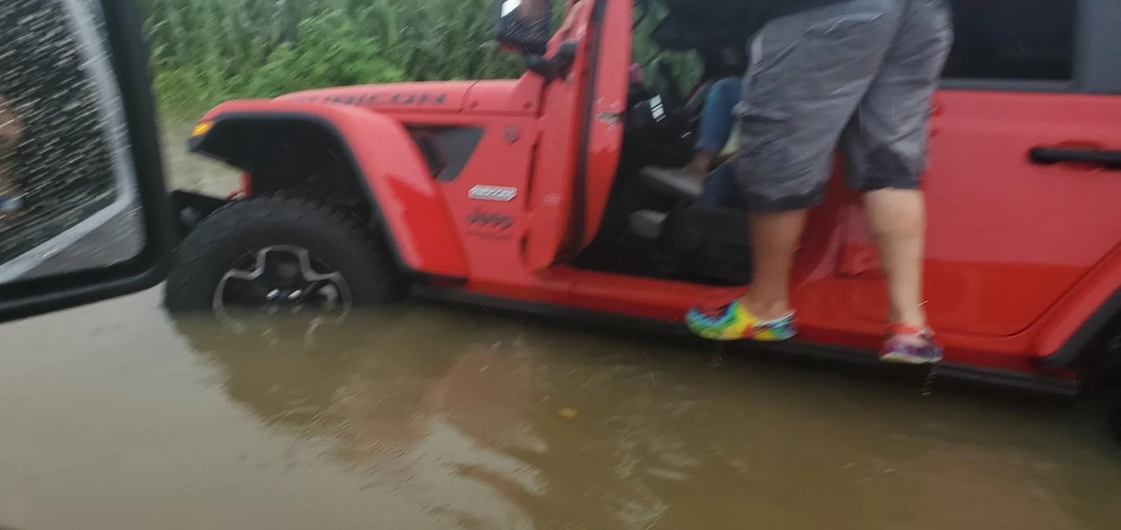

Looks and sounds like water somewhere. I'd take a bunch more pics of every side and angle. I'd consider talking to your insurance company. I know someone who drove through a flooded viaduct and their car developed intermit electrical issues afterwards. The insurance company totaled the car because of it. It was a 8 month old car.

The batteries are located on the passenger side, the auxiliary under the fuse box. At the angle the Jeep appears to be in, it’s possible water entered where it shouldn’t have and caused a short.

Even if @philowood flooded out his JL, that wouldnt explain all the electrical gremlins, unless the water got into the fusebox. I don't know how watertight the fuse box is.
This is a BSG setup...etorque. The extra battery is under the rear left passenger seat. I am betting it has a faulty seal. OP needs to check battery voltage for fluctuations....
That is what I was thinking. Also, not sure how high the water is on the right side, but I think the BSG itself is on that side and somewhat near the middle of the engine. Wonder if water could have enter the BSG?

I have a 2020 Rubicon, we got into some water yesterday, and the whole jeep shut down and locked itself. It took us a little over two hrs to get her to start again. Once started, the electrical was a hot mess, the dome light flickered on and off the whole ride home, turn signals went out, cruise wouldn't work, couldn't get the lockers to lock, couldn't get into 4wd, couldn't get into neutral. left us totally stranded. I thought this is what jeeps were made for?? Does anyone have any input?? Thank you
Looking at that picture it is leaning to the passenger side, I bet it’s way deeper on the right side. Look at the angle of the bottom of the drivers door to the water. Hope it dries out ok.
