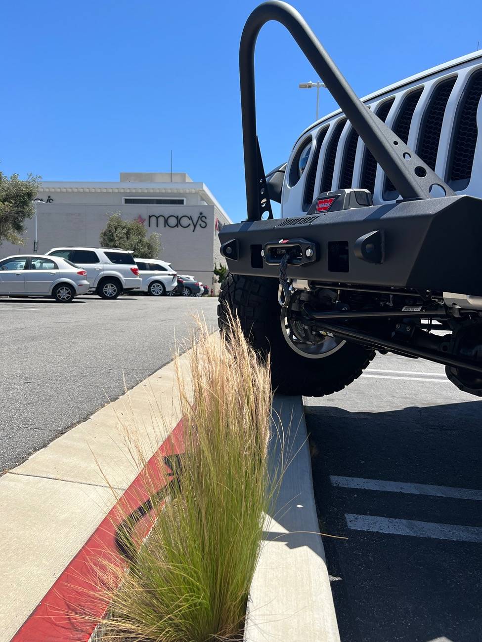

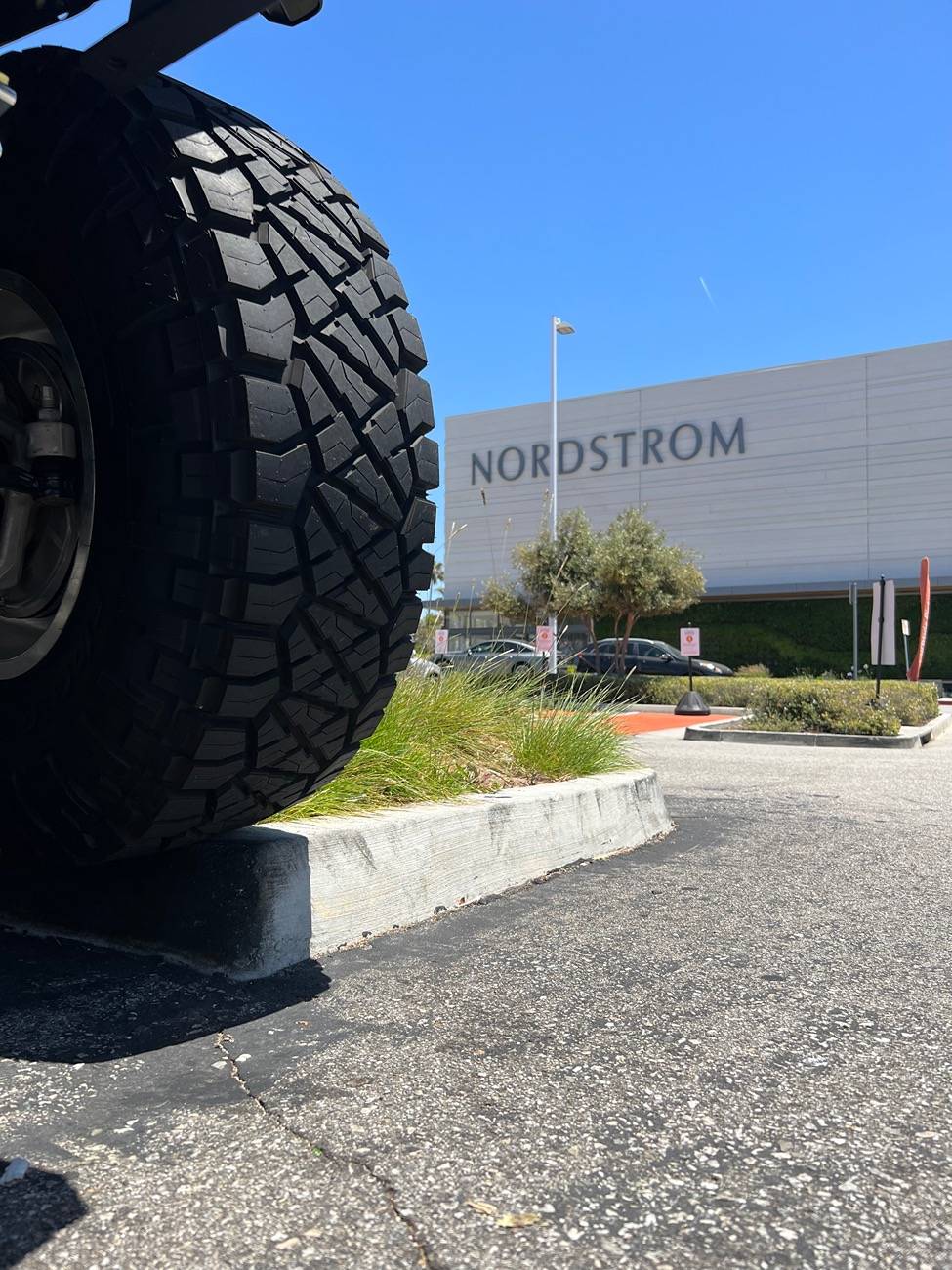

Hell yeah, it can handle it! You should see it decline down hill on the spiral on the parking structure. I could post a video on that if you would like to see it.
Yes i would lol. There are plenty outdoor trail videos. But what we really are missing is the mall performance videos. How am i supposed to know what reactions i will get from people on mall trails.
