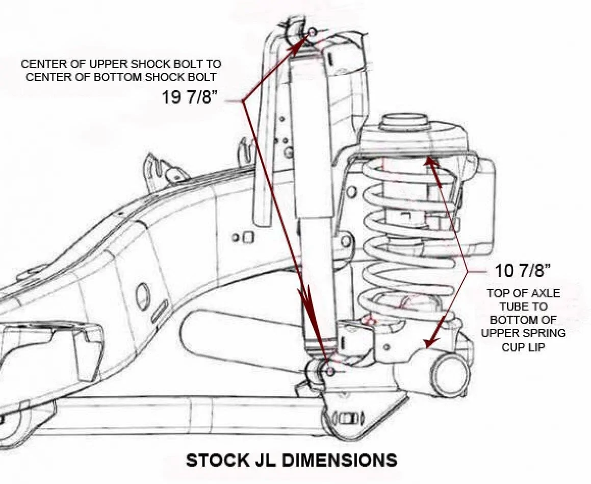

I have a 2024 jlur and an AEV lift and my front axle (and rear) are centered within 3/8" front and rear 1/8" and I I have about 3.25" lift based on this diagram. visually you can not see 3/8" on my front axle and any time you are driving and your suspension is working the axle is moving in either direction any way.
Most measure about 1/4" off center per 1" of lift. Should be more than 3/4" in your case but who knows why it isn't? My JT was off by 1/2" with just a 2" spacer.
What’s your height from spring perch to axle….?
the one I installed on my buddy's xtreme is the same as mine. I neglected to measure either one prior to the lifts so not sure where they started from as far as axle center goes. I took every other measurement but failed to measure axle center stock.

just a bit over 14 1/8"
That drawing that you have is a sport/sahara, Rubis are 11-1/4 to 11-3/8 factory height… so it’s likely you got less lift and that’s why your axles only shifted 3/8 “ …..at least this was the case with mine, and a lot of the Rubis I’ve lifted, however I haven’t lifted a ‘24 yet, things may have changed….
I'm wondering if the xr track bar is longer or the axle bracket hole is corner toward the drivers side to compensate for the 1.5" factory lift? If that's the case you are probably closer to 1.5" lifted over stock and therefore 3/8" off center tracks. I'm guessing if you throw 3" plus at a sport the axle will be off by 3/4" or more.

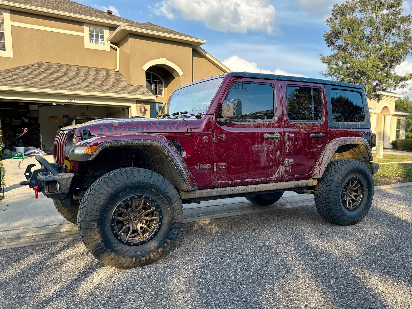

I know people are going to shit on it but I have to throw Rough County out there.
I went with the 3.5 lift on my JLUR. Besides coils and shocks, it came with an adj trackbar, adj lca’s AND a new front driveshaft. All for under $1500
For daily driving I like it better than stock. I’m 95% on the road. If you aren’t going off-road, it’s perfectly fine. Off-road, eh the bushings make some noise and it’s ok. I still haven’t diagnosed some of the noises I hear when on trails but for the price I feel it’s a great start.
