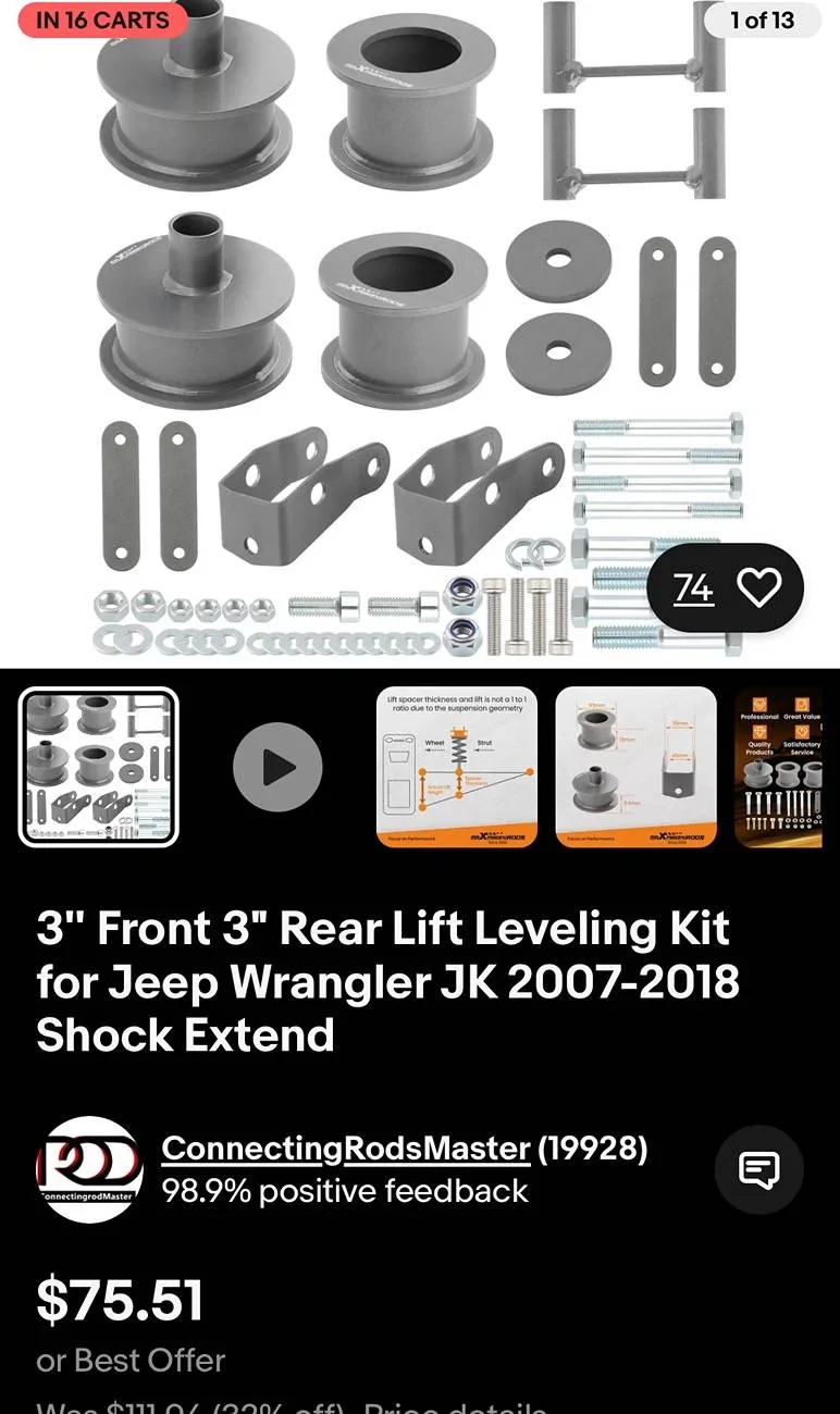

Define smooth ride?
3" lift on a leveling kit would completely alter the suspension geometry. The vehicle body would be off center to the passenger side, and the coil spring may pop out on a sharp turn. Hitting a small rock may feel like hitting the curb
