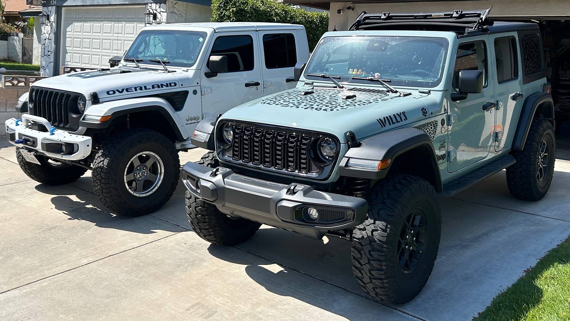

For reference, my wife’s 24 Willys 4 door is lifted 3.5” on 37s. It’s MORE than enough for that size tire. 1.5” for 35s, and 2.5” for 37s would work just fine.
Jeep Wrangler JL Lift Kit Recommendations IMG_6735
We do wheel our rigs and the extra inch comes in handy, but if you’re not trying to flex like crazy over speed bumps then stick to 2.5 inch.
