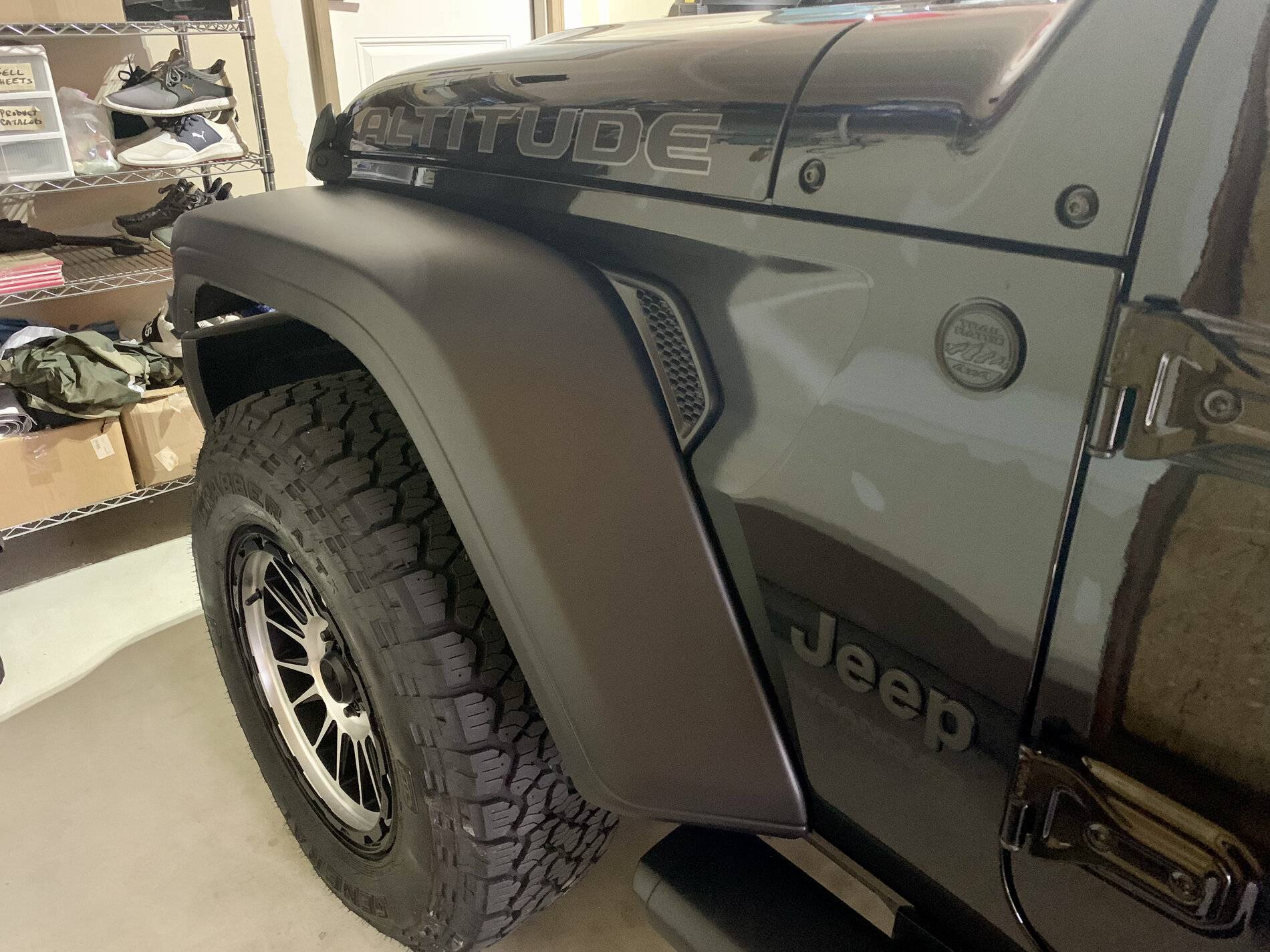

I have 33’s as well and did two stacked .5” Teraflex spacers on the 4 corners for a 1” all-around lift. My Sport Altitude has the same shocks as your Sahara. Rides great. It’s my wife’s DD and she has noticed zero difference in ride quality. Sorry I don’t have any quality pics yet, just did lift on Monday. But here a couple quick pics.

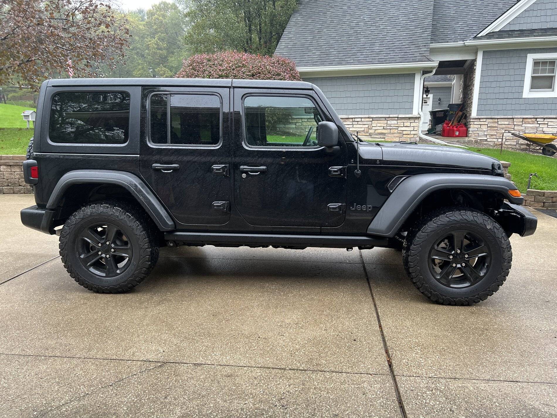

Im running 33’s on the stock 18” wheels with the Teraflex spacer kit and the extended bump stops (not necessary but I already bought them). Everything else is stock and it rides great. I considered the Rubi takeoff method but for now decided to just go with spacers.

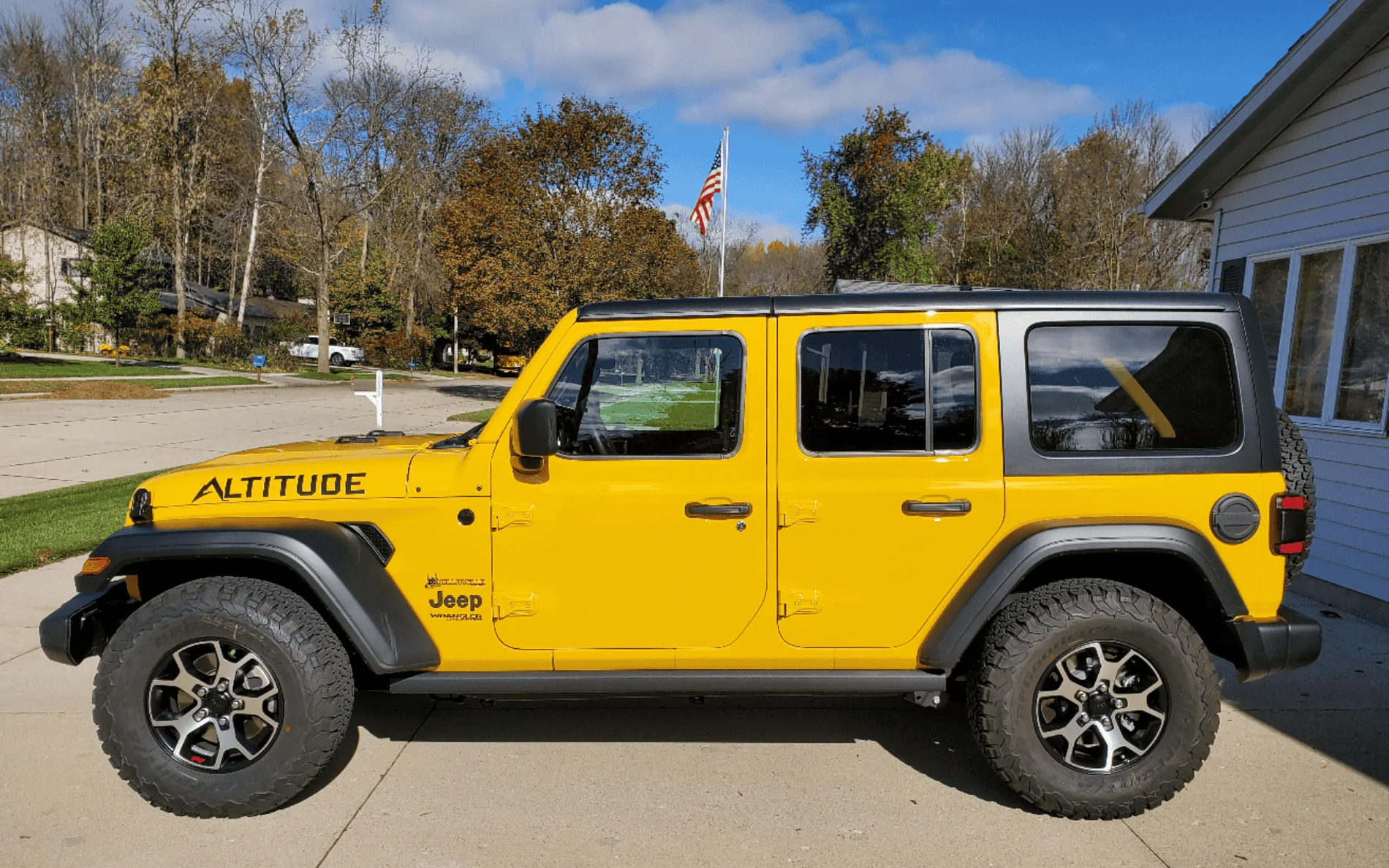

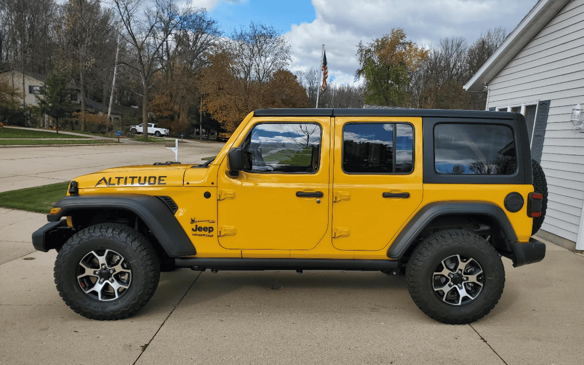

I just installed the Terraflex 1.5" spacer lift on Tuesday. I'm running Rubicon take-off 33's on my sport altitude. I'm not planning any off road with this one, so I just did the spacers. If you will be going off road and flexing it to its max, then you should consider a spacer kit with proper bump stops, sway bar end links, and longer shocks. AEV 2" looks good for that. Those Rubi shocks with just a spacer lift would be close.
I didn't go Rubi take-off springs because I wouldn't know exactly what I was getting for height. I'd need to install it and then go back and add spacers to get where I wanted? No way I'm interested in doing all that. The spacer lift was a known before install. I also had 1" of rake that the Terraflex kit balanced out nicely. It's now 1/2", but it looks much better to me.
I don't have a lot of miles on the lift yet, but I had it up to 80 plus mph, and everything seems normal. I didn't really notice any wondering in the steering, but I am driving a 250 mile round trip this Sunday. If I notice an increase in steering wonder due to the reduced caster on the front, I will install the longer LCAs you've heard about.
Here's a before and after:

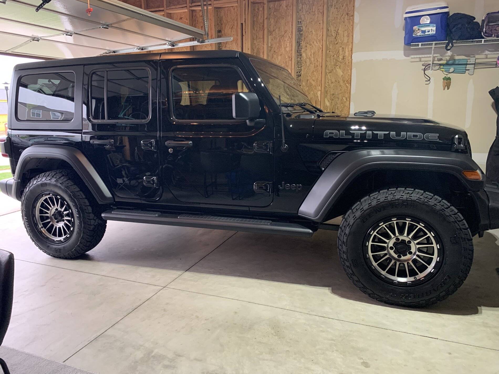

Rubicon springs & Rubicon shocks are just a bit firmer than stock Sport setup, after a couple hrs driving you probably won't even notice much difference. The Fox 2.0s are a noticeably firmer, but in a good way. More control over washboard type terrain, or small road imperfections, and much more travel when you're doing off road duty that requires articulation.
I'm 100% happy w/ the Fox 2.0 purchase, and that combined w/ the Rubicon springs, Mopar lift LCAs, high fender kit, and newest cast iron steering box I've got a great handling 2dr JL, one that I can go 80 mph on the hwy without worry. Also having a low center of gravity build that isn't as prone to get death defying off-camber as higher lifted 2drs. When I get my 35s on (in my shed just collecting dust) I'm still hoping the overall performance on & off road will be similar. I may have to go w/ some more bump stop though as I was into the inner fender liners just a bit, but it was a pretty challenging time

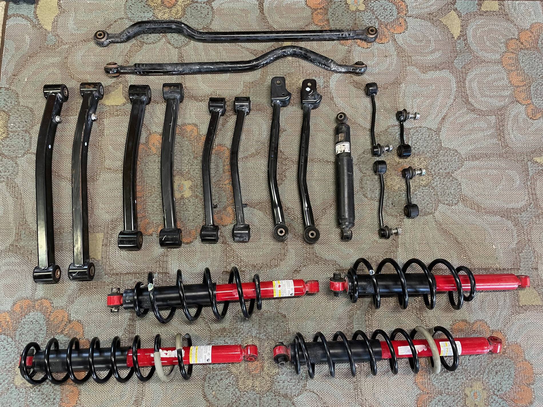

As far as lift, I have a 2dr so it's a bit easier to get by w/ shorter tires. It really comes down to what you plan to do w/ your JLU. What you might consider is running Diesel Rubicon springs or springs from the 392 Rubicon, these should net about 1 to 1.5" more than regular 4dr Rubicon sets. Might also look into Rubicon fenders or a high fender kit like mine to allow more room (and keep a lower center of gravity)
The Diesel Rubicon setup
https://www.jlwranglerforums.com/fo...on-on-2-door-sport.40700/page-17#post-1722911
The 392 setup
https://www.jlwranglerforums.com/fo...l-where-do-the-springs-go.82499/#post-1726132
And the price of the 392 springs are a bargain (at least for the front pair)
https://www.jlwranglerforums.com/fo...l-where-do-the-springs-go.82499/#post-1726569
And my setup as it is currently
