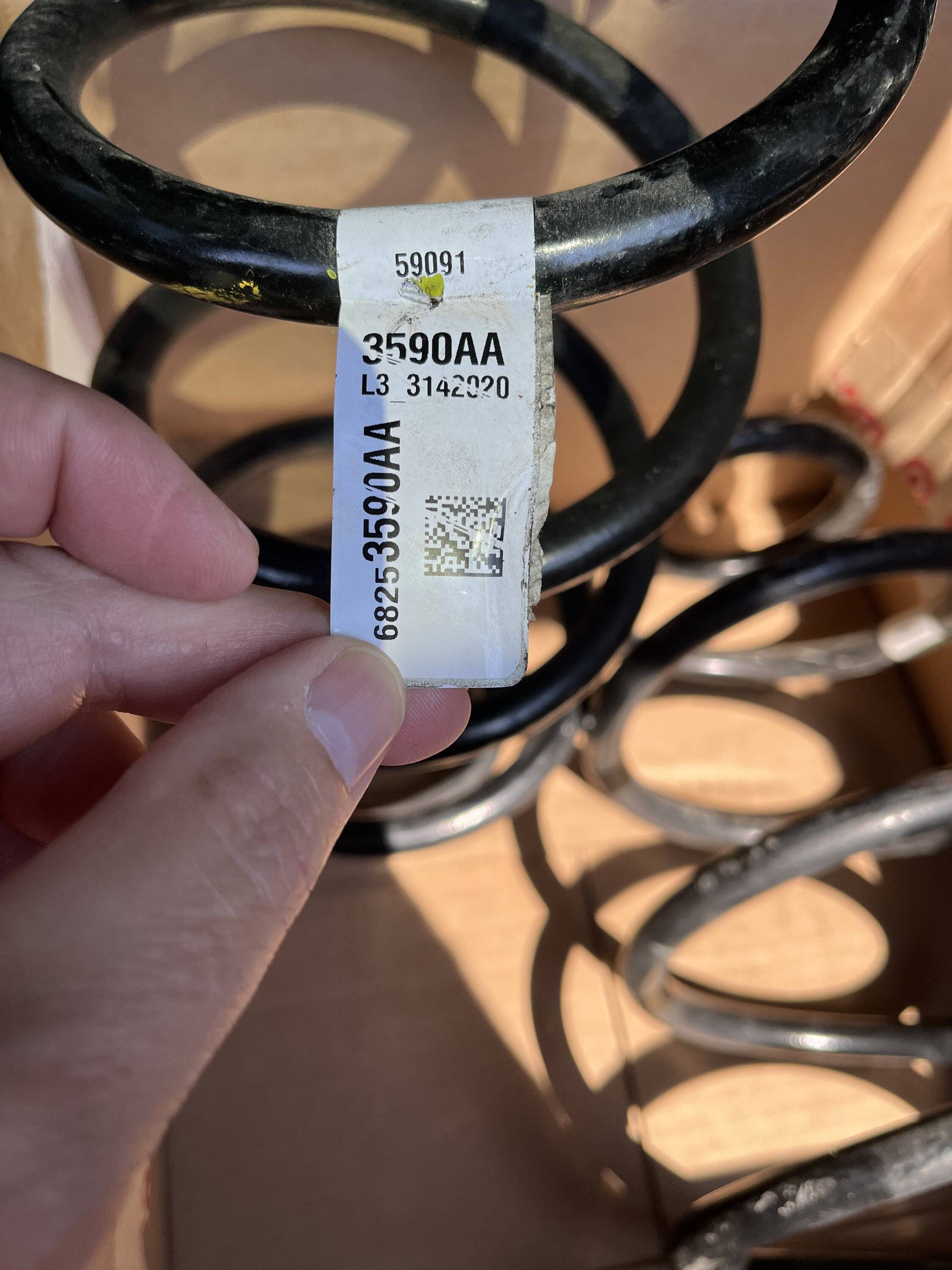

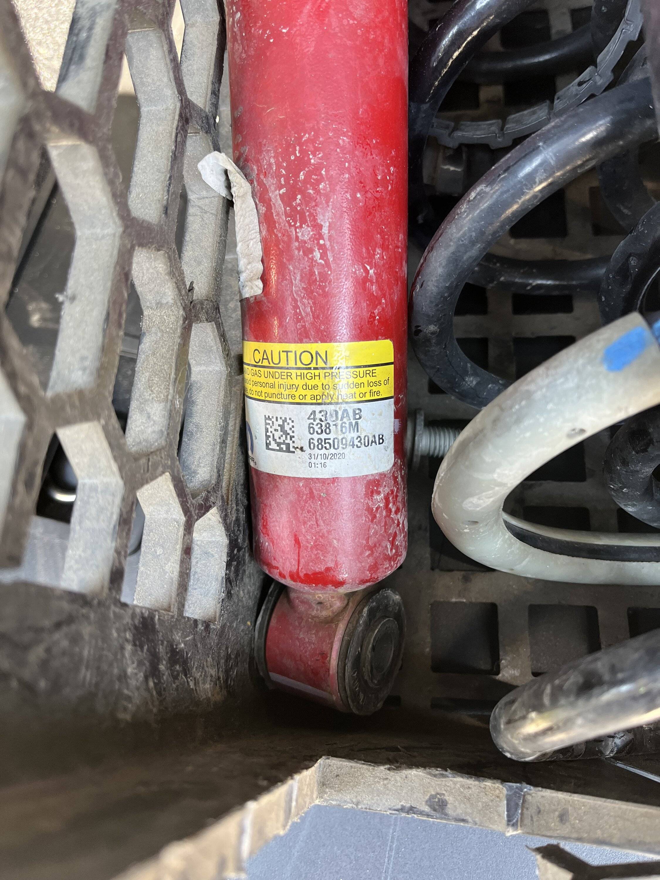

JTJeep
Jun 21, 2021
Maryland
2021 JLU Sport S

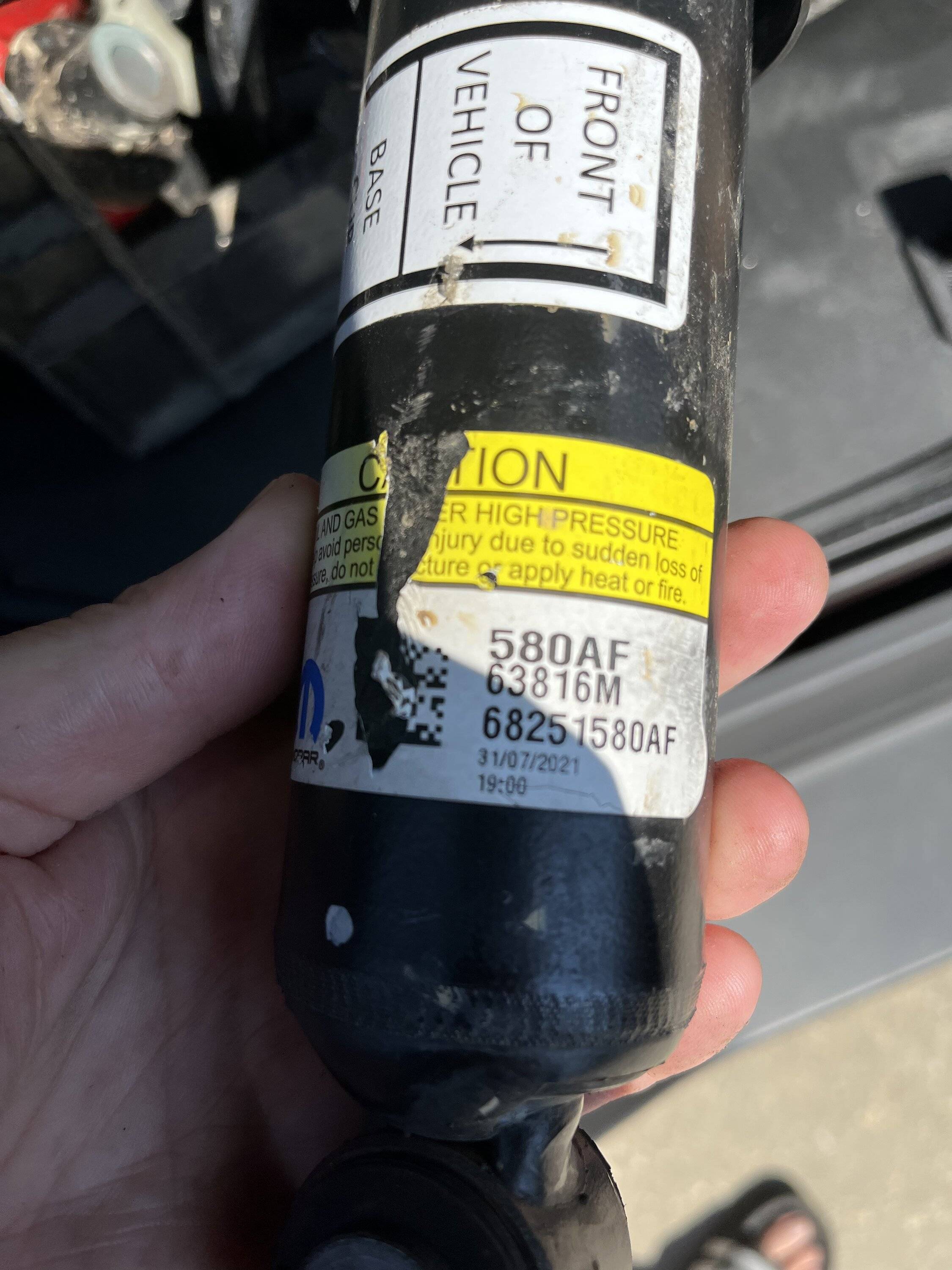

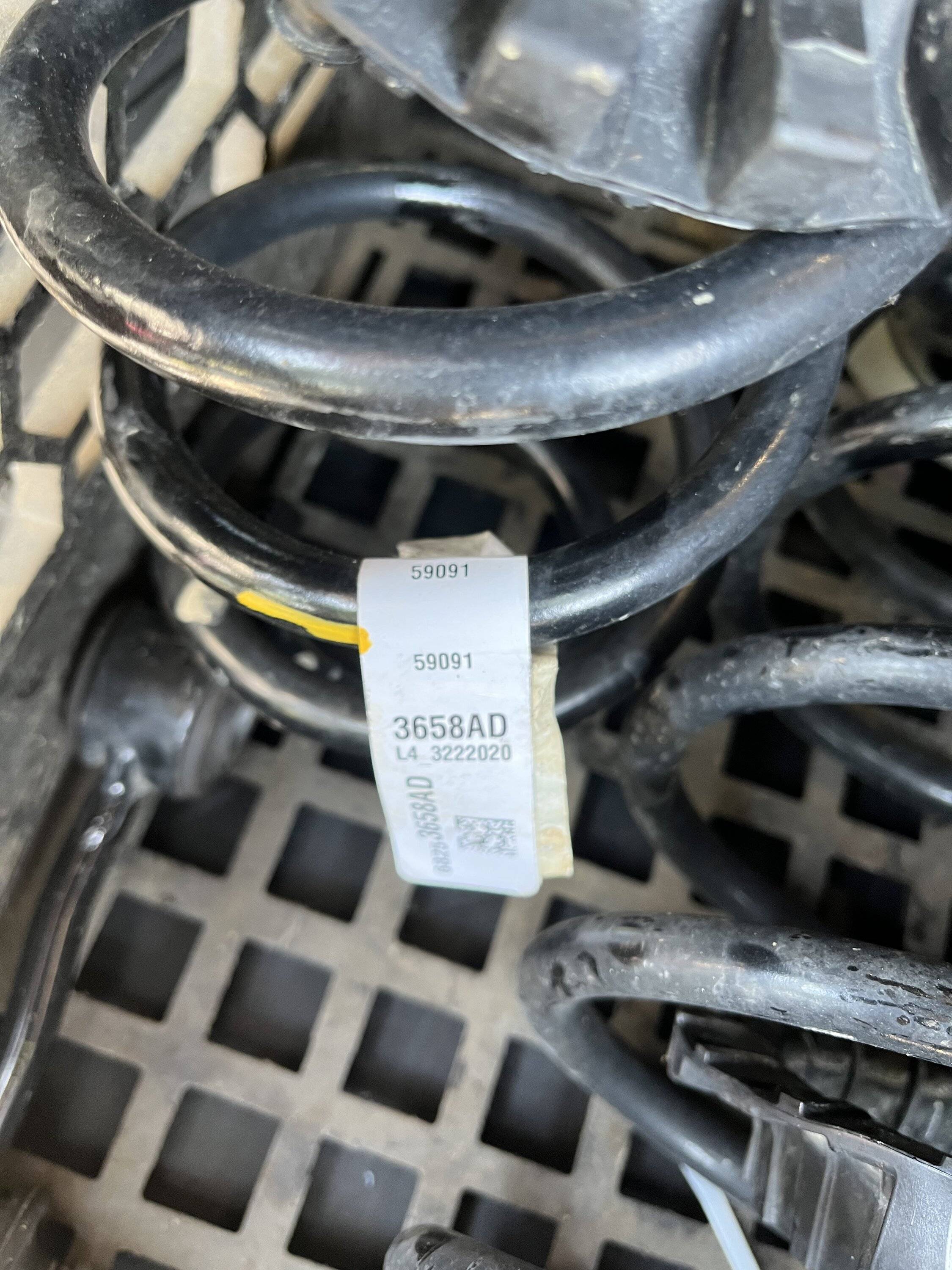

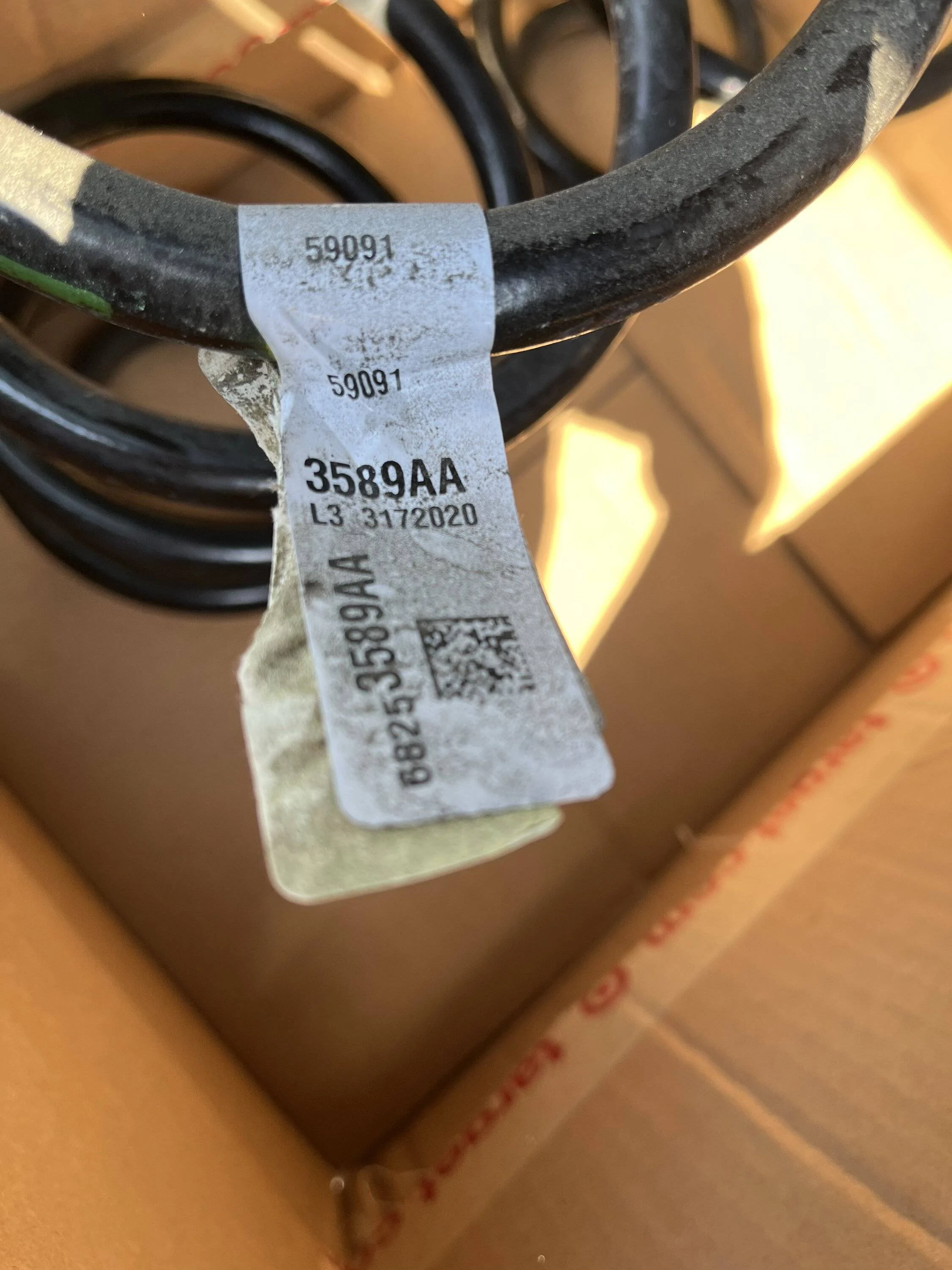

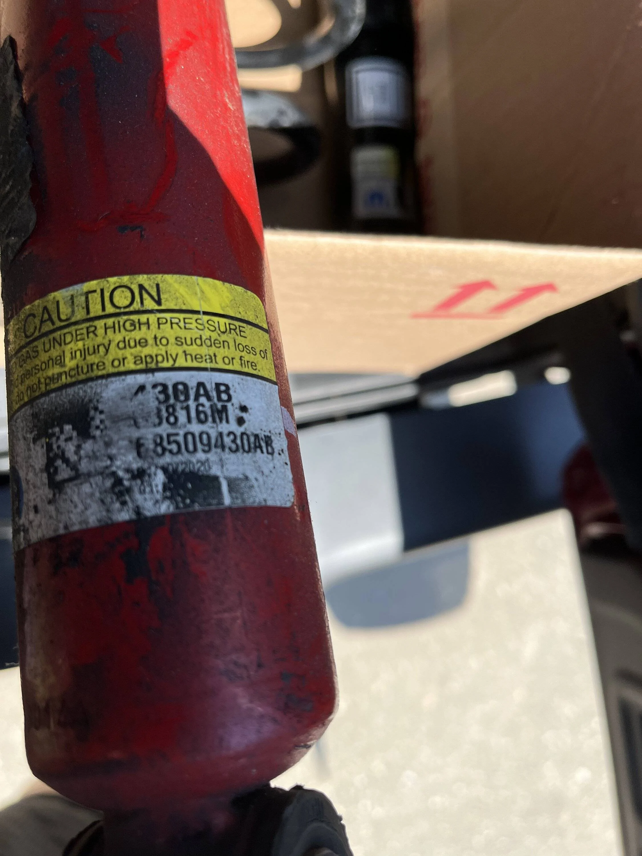

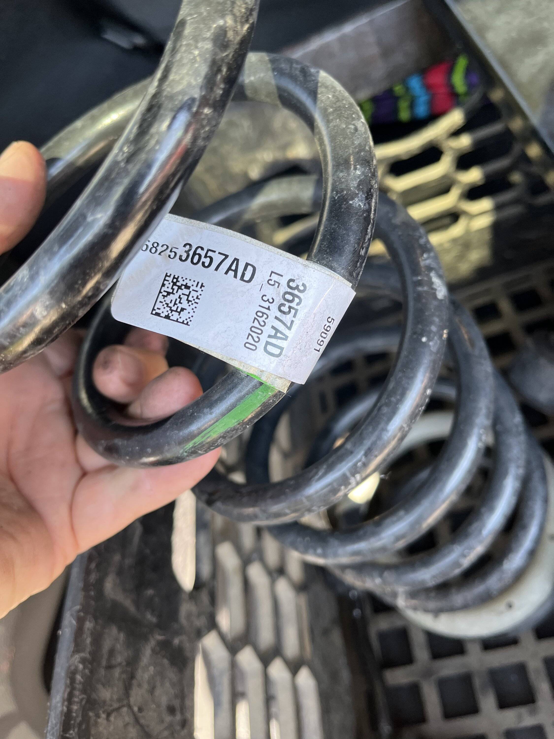

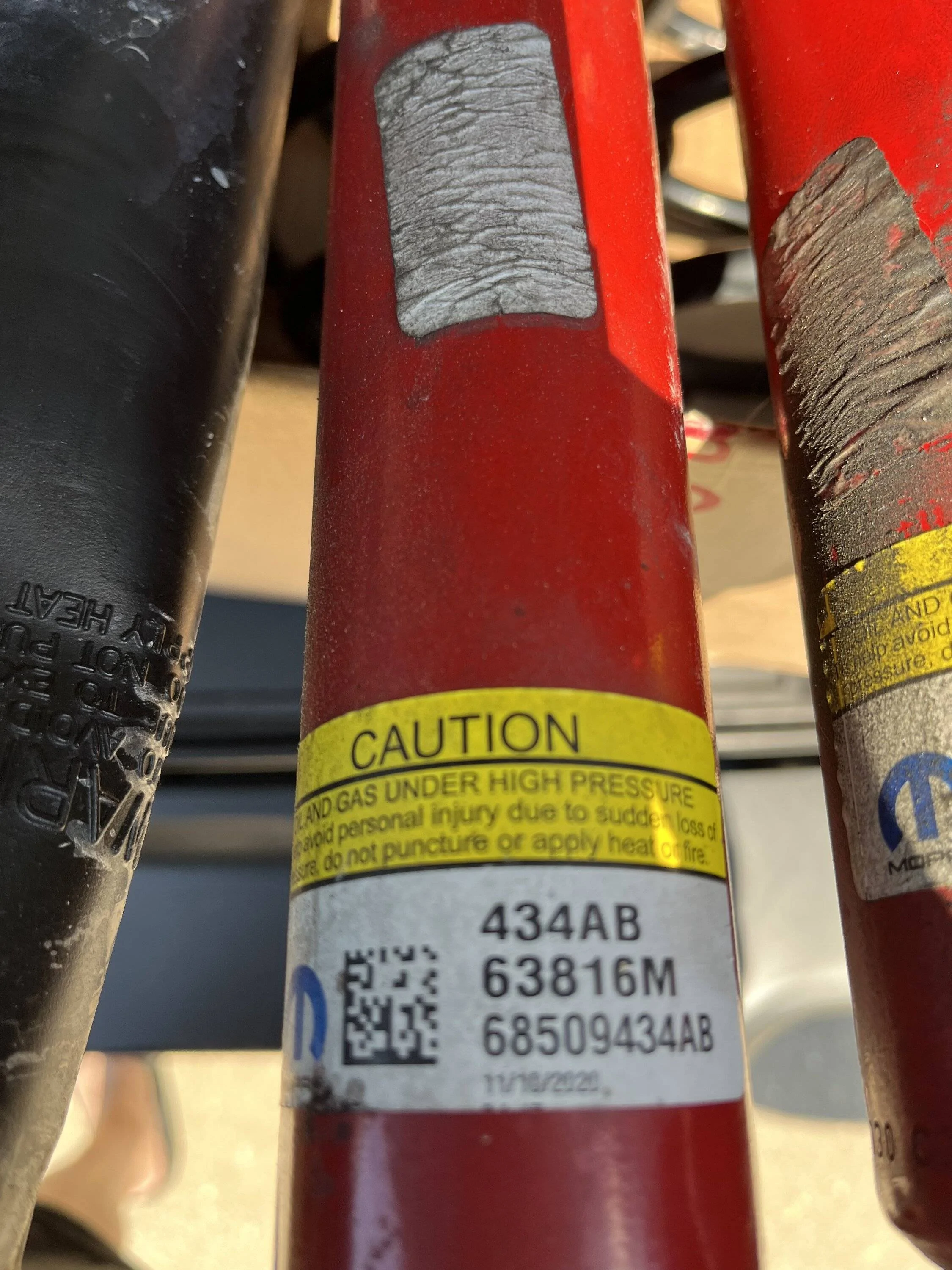

These are the parts I have. As far as I can tell the springs should work, not sure about the shocks.

TheBirdie72
Dec 16, 2021
5,389
25,731
Rhode Island
2021 Jeep Wrangler Freedom Edition 2 Door
Those parts should give you some lift, yes. The ones you really want for max lift are the 60/61-90/91 spring set (4 dr rubi with hard top and tow pkg), or a set from a diesel. I actually was the first to use a 4xe takeoff suspension, and it worked great. Again, I’ll defer to @blnewt our resident rubi takeoff professor. But what you got should give you a solid 1.25 to 2 inches. And the rubi takeoffs an upgrade vs the stock sport / pucks.
