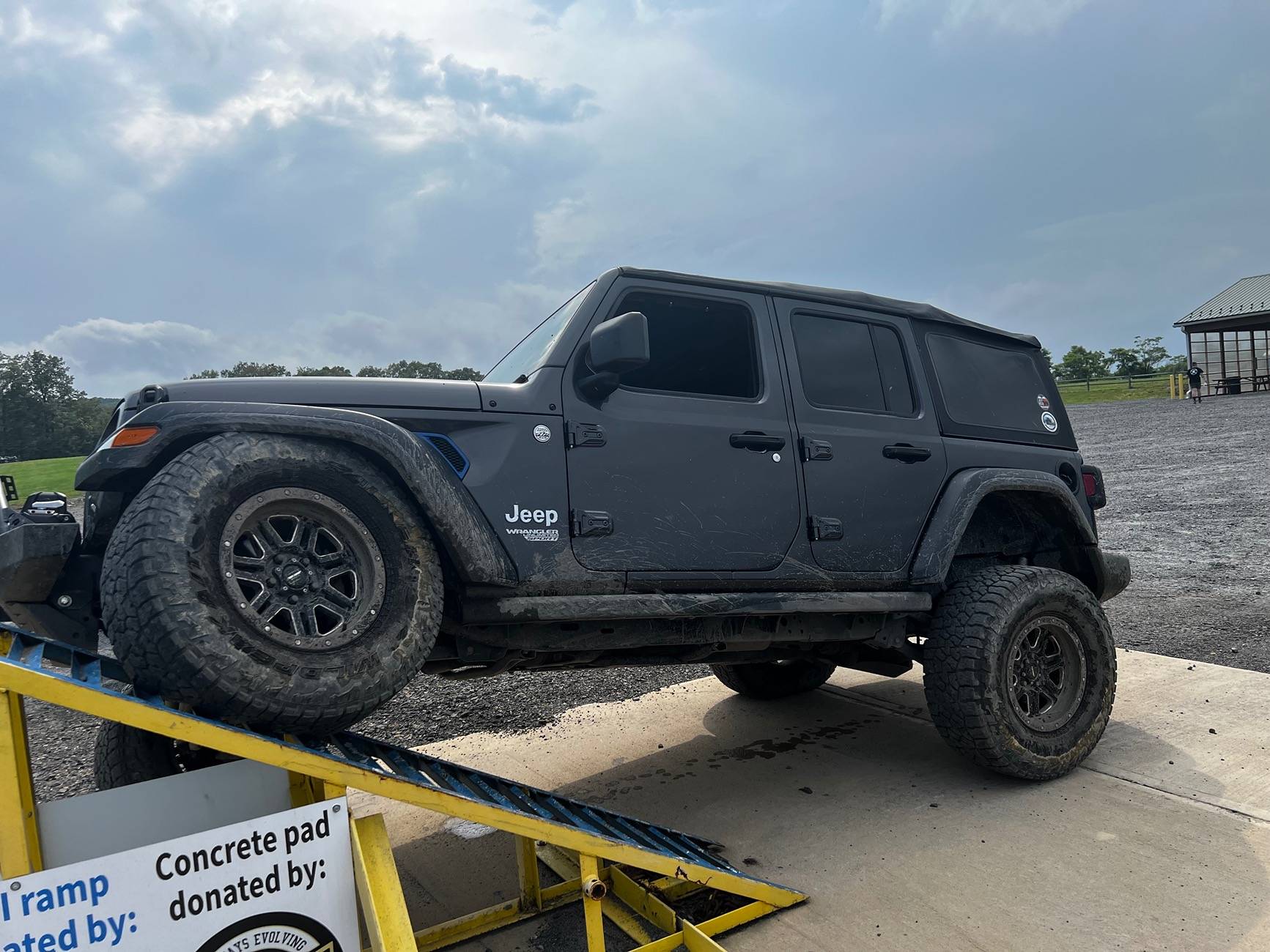

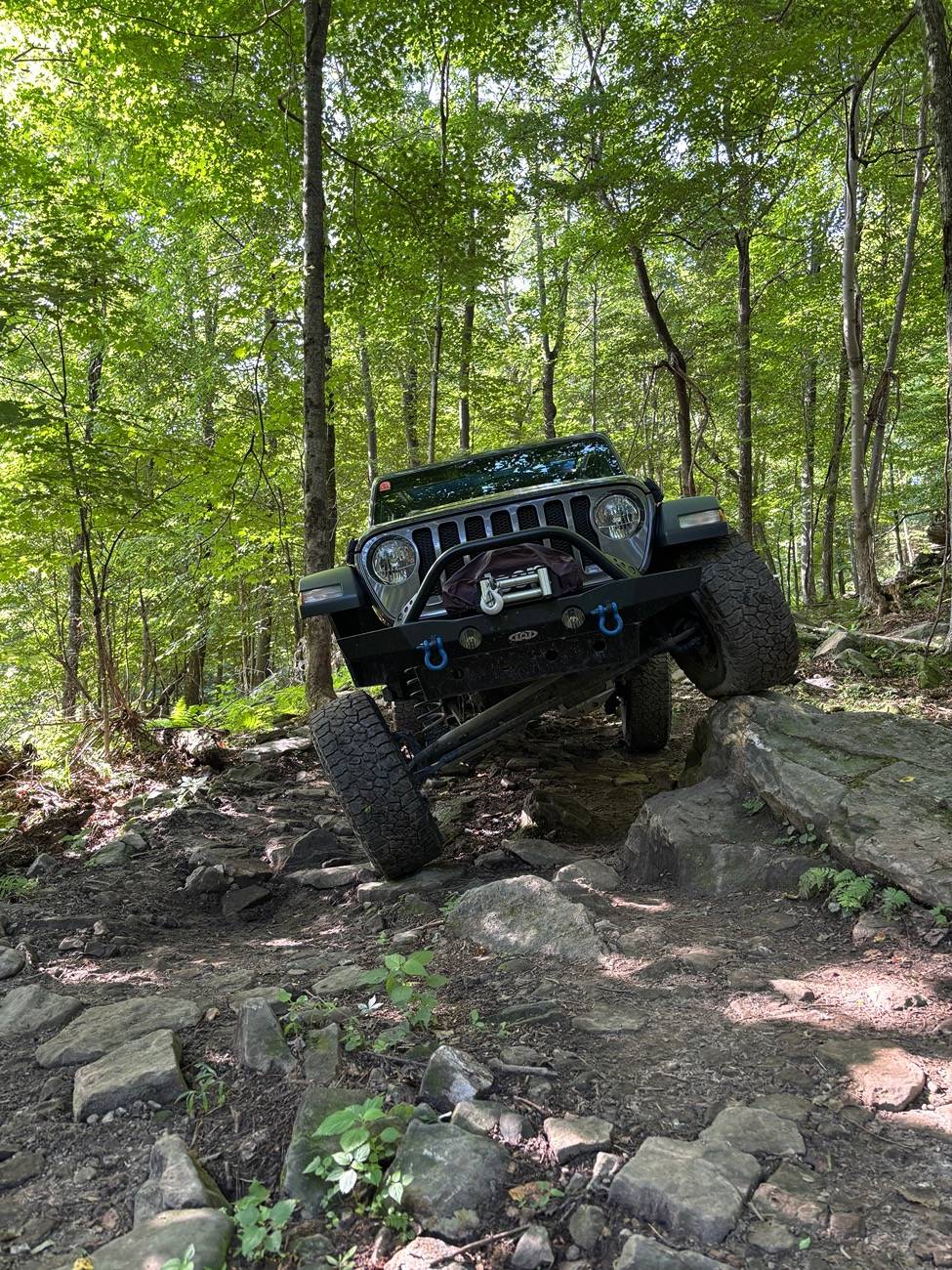

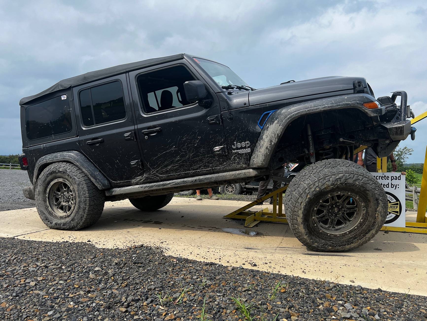

If you are in a budget and want 2-2.5” get someone’s factory XR springs and a set of shocks and some longer LCA from mopar. I did this with a Teraflex spacer upfront to level it out…whole thing was less than $300. I can’t speak for 37’s but I have a really decent amount of flex…I’m not competitive with extreme full suspension set ups but still pretty flexy
Jeep Wrangler JL Lift Recommendations :) IMG_3168
Jeep Wrangler JL Lift Recommendations :) IMG_3169
Jeep Wrangler JL Lift Recommendations :) IMG_7289

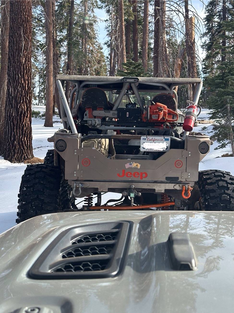

I wheel with this guy on 43s. Makes my 37s seem…inadequate
He can probably drive that thing through Little Sluice with one hand while eating an engine burrito.
