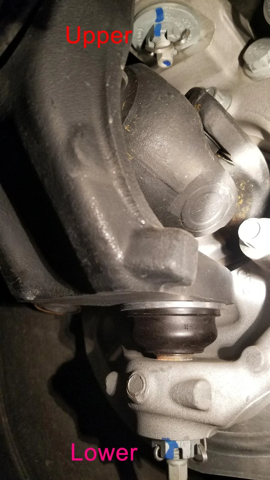

Many of us have found finger tight ball joints on our JLs. Are the cotter pins on the 4 front ball joints perfectly bent on your JL or do they look mangled like a human bent them? If they look perfect bent from the factory then the torque has not been checked.
That’s a good question. I will show my husband this and have him check. I’m now on my second third stabilizer and still have the issue. Clearly it’s nlt fixing my problem
