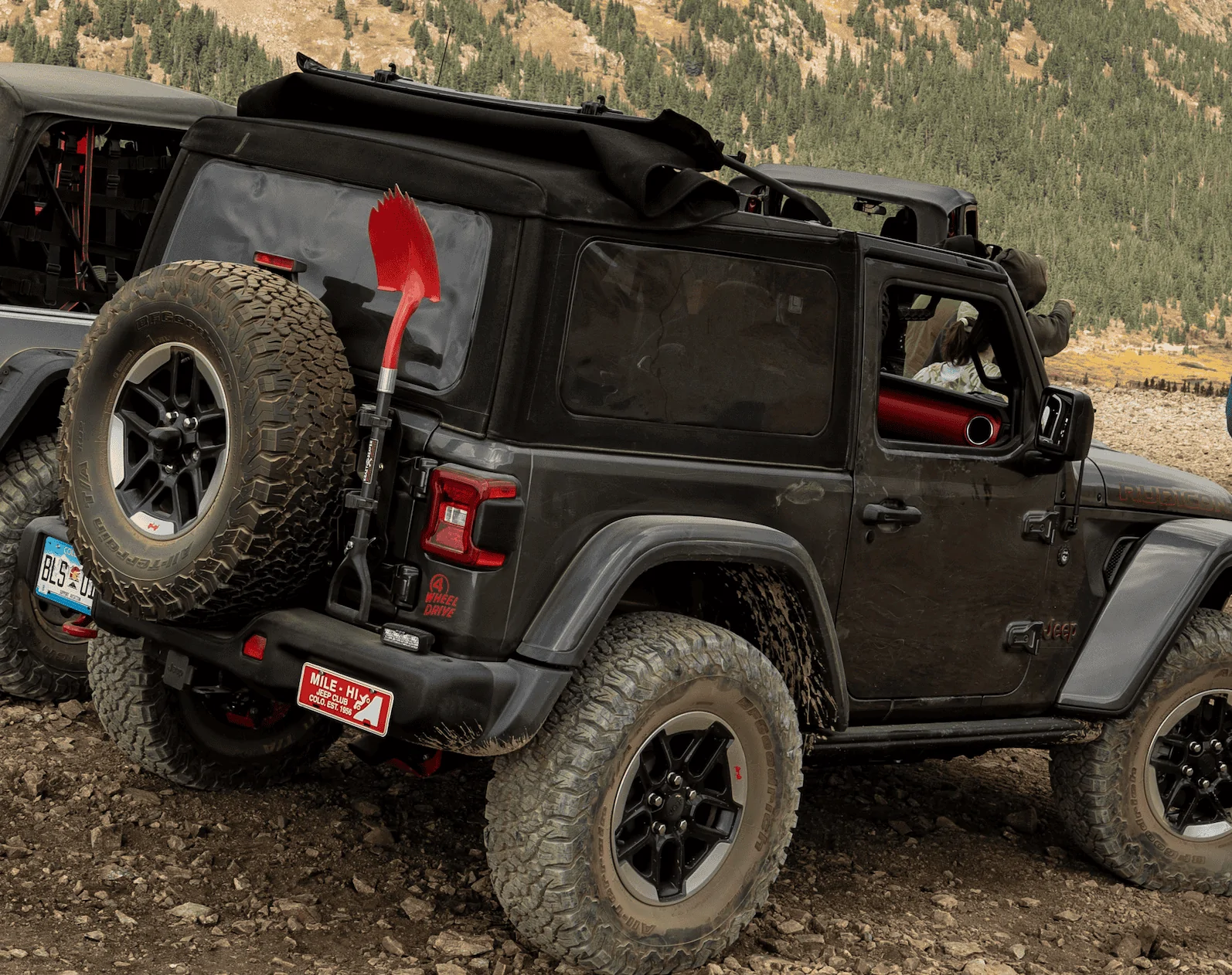

Is this custom? It looks slick - I'm curious what you've done here.
In regards to this post, the original poster got back to me with some info about their shovel mount.
AirportDave said:
The shovel mount was a modification to the Teraflex JL hi lift jack mount installed on the tailgate. Rather than use the bolt studs on that mount for a high lift jack, I justolted in two QuikFist straps in intead, and used that to secure the shovel. I'm sorry I can't send pics since I don't own that Jeep any more.

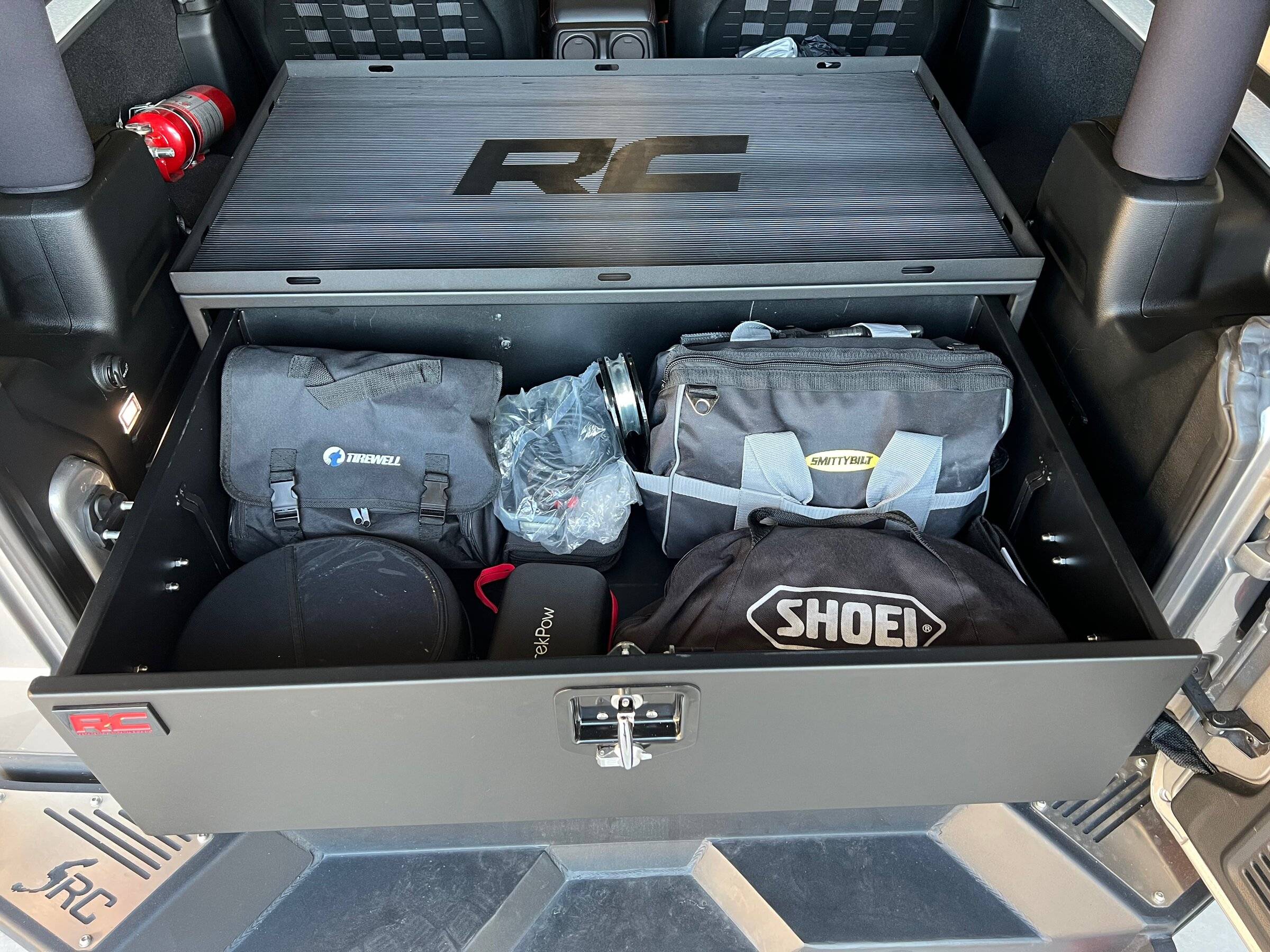

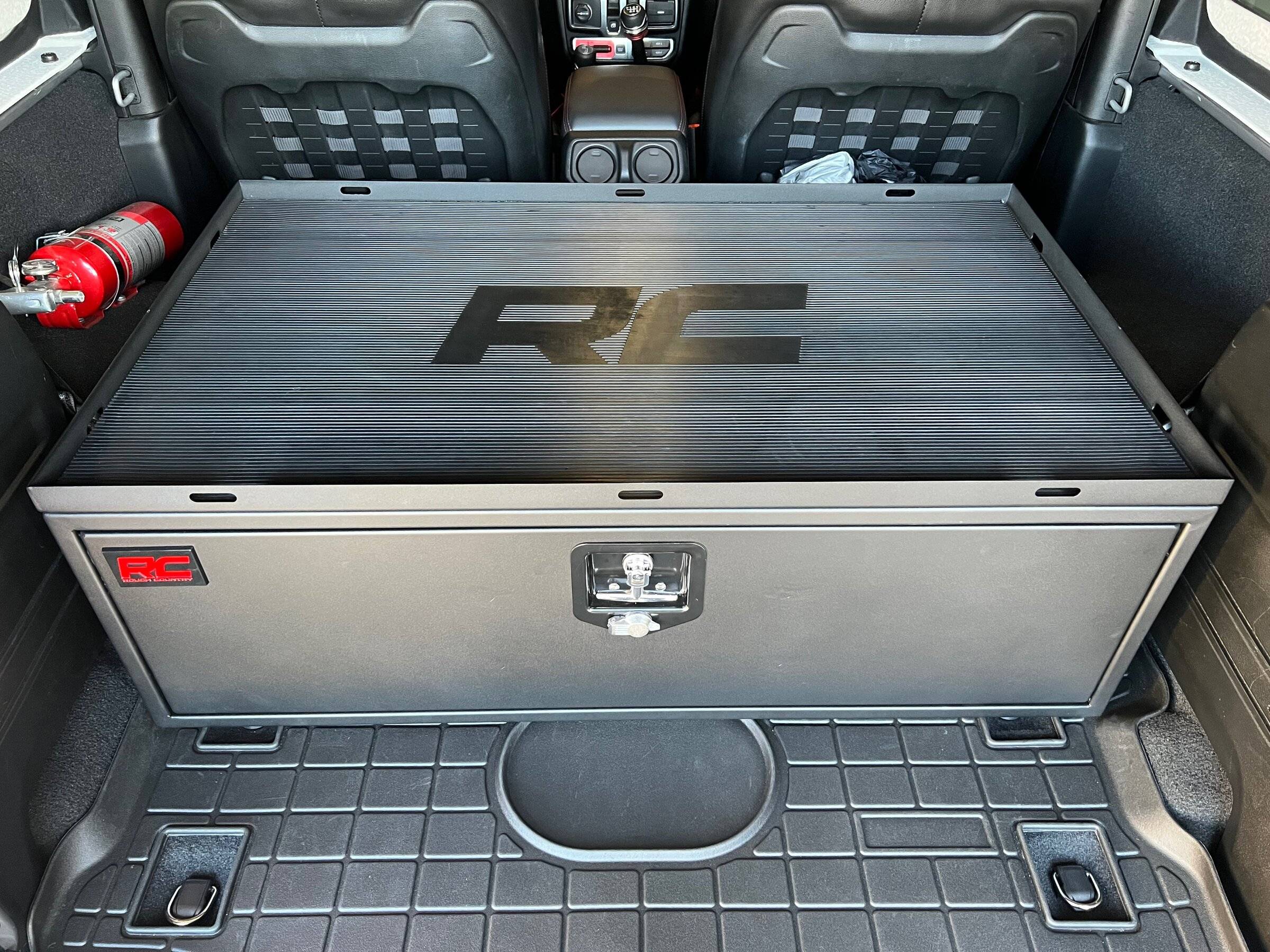

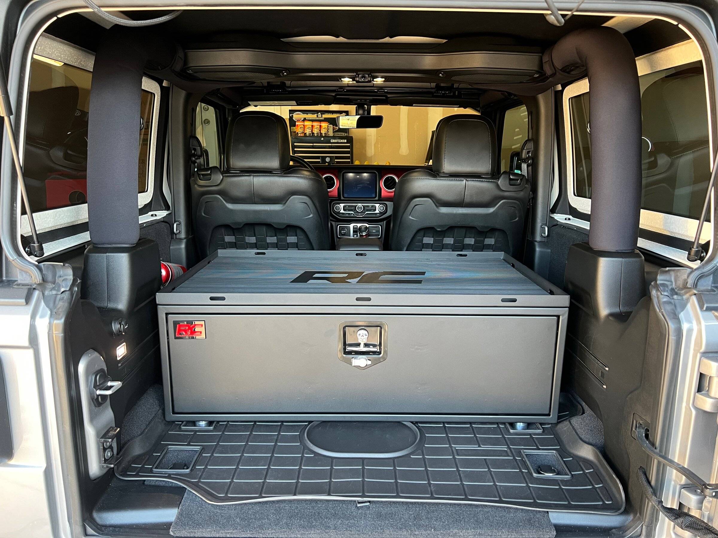

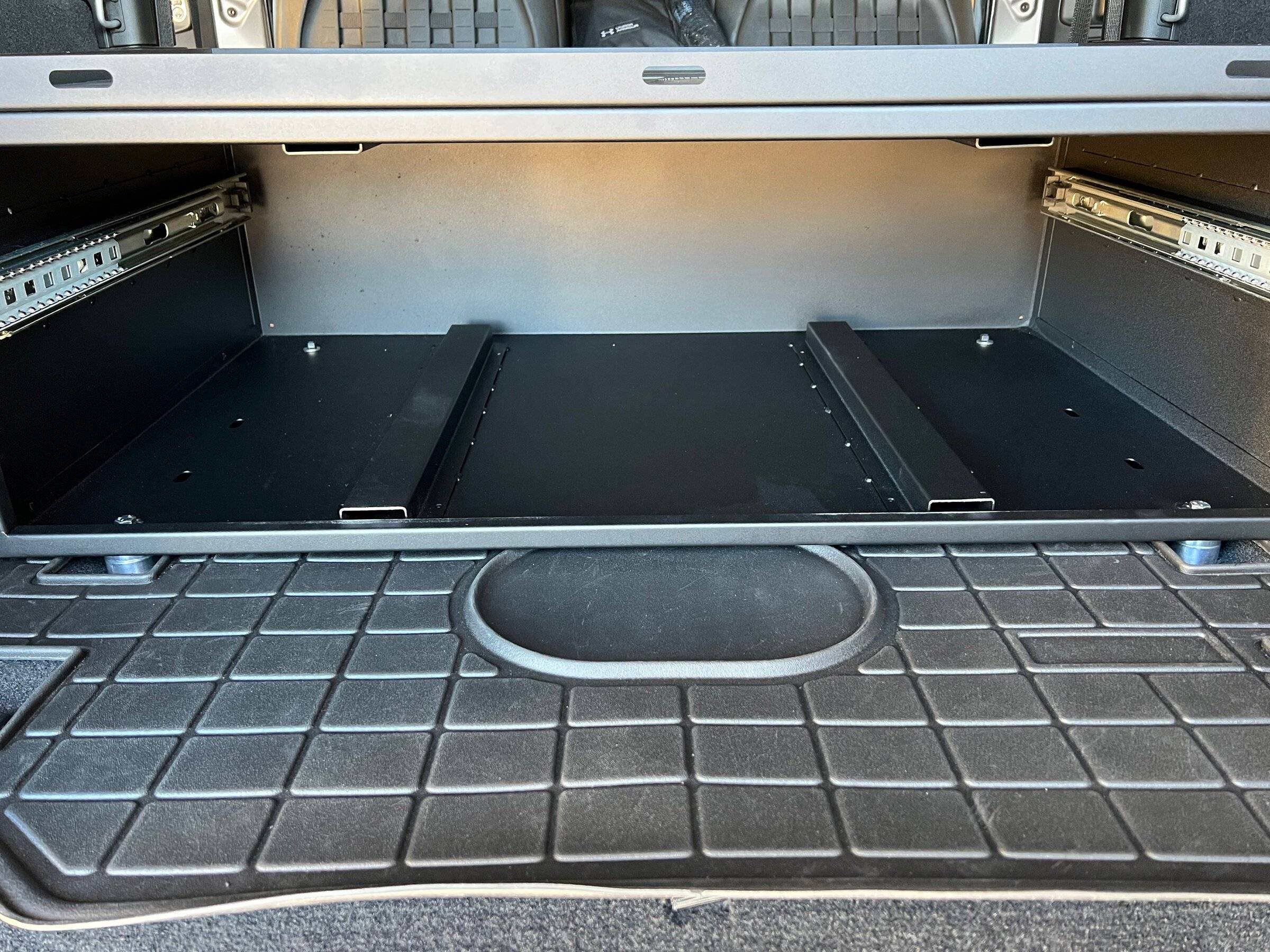

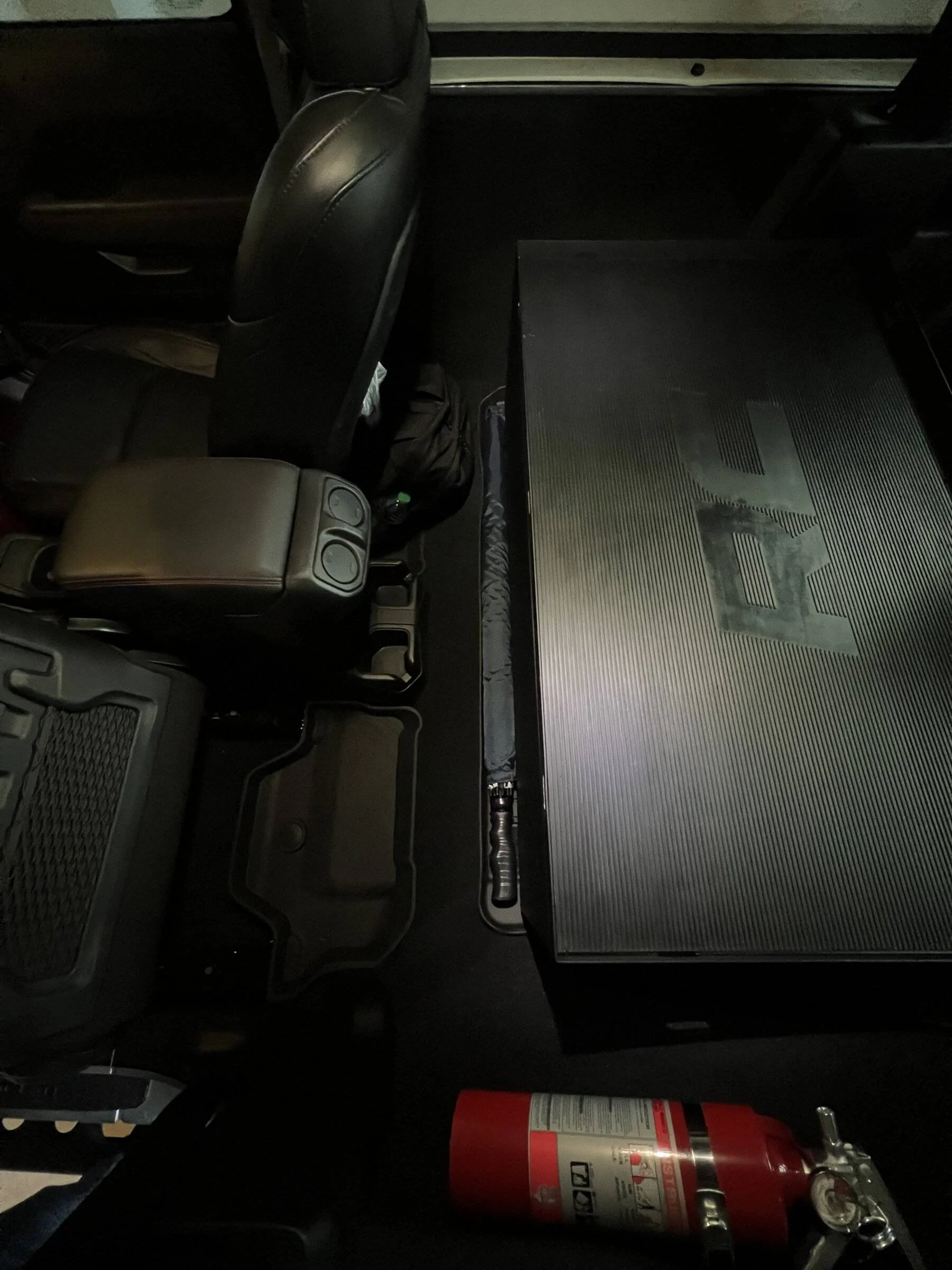

I posted this on another thread, but posting here since it's on-topic. Recently installed the Rough Country storage box/drawer in my 2 door. Their site says that it works in the 4 door or the 2 door, and it does, but they don't explain how it's supposed to be secured in a 2 door. I have an e-mail out to them asking, but no response yet.
I improvised.
It comes with 4 spacers and 4 bolts that are used for a 4 door installation. For mine, I had to use 2 spacers on each side to secure the front of the box (which is toward the back of the Jeep). This also meant that I had to go buy longer bolts.
For the rear of the box, it would just be resting on the steel hoops where the rear seat latches. This isn't ideal; not to mention it will tilt up when the drawer is fully extended.

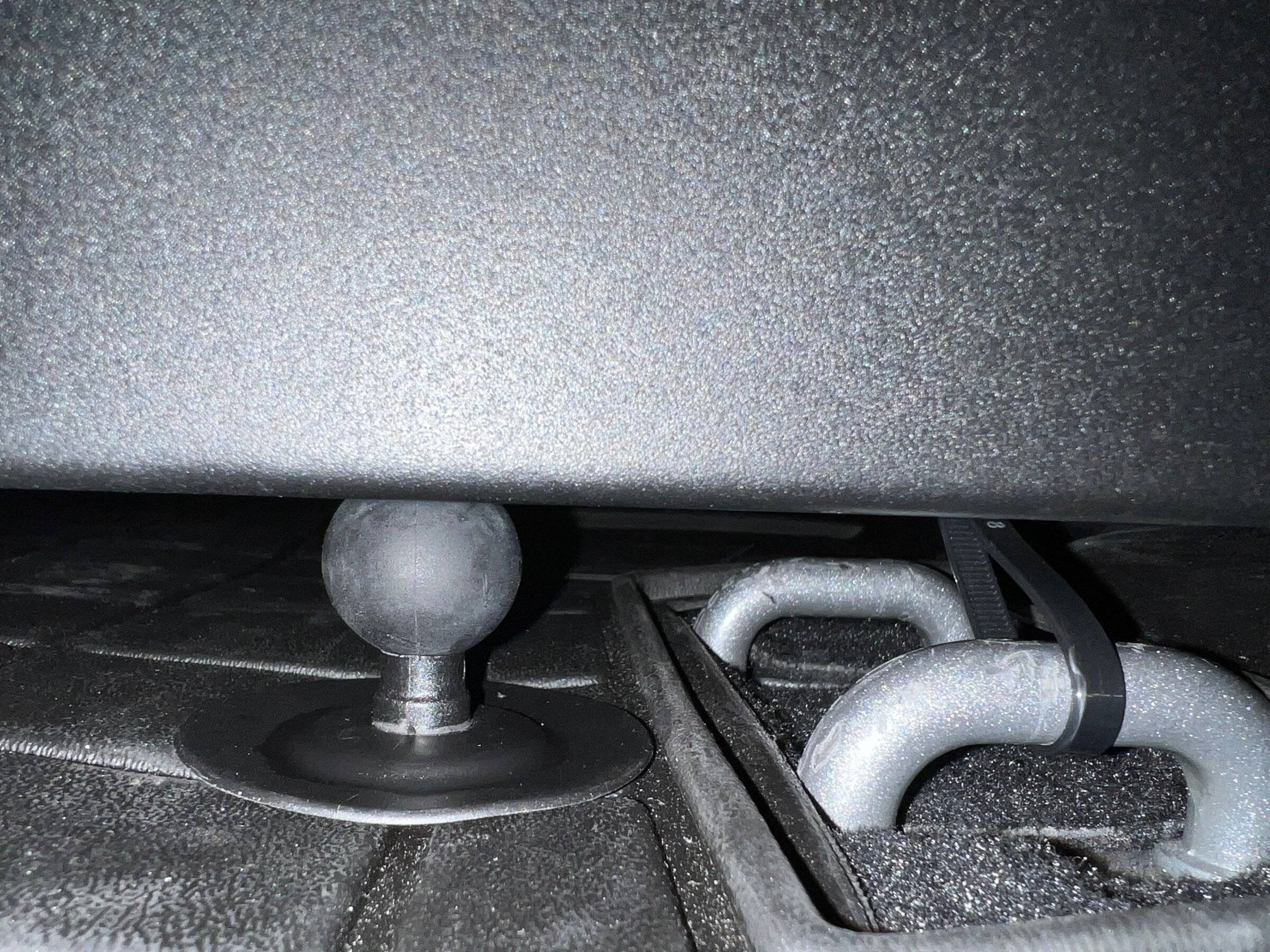

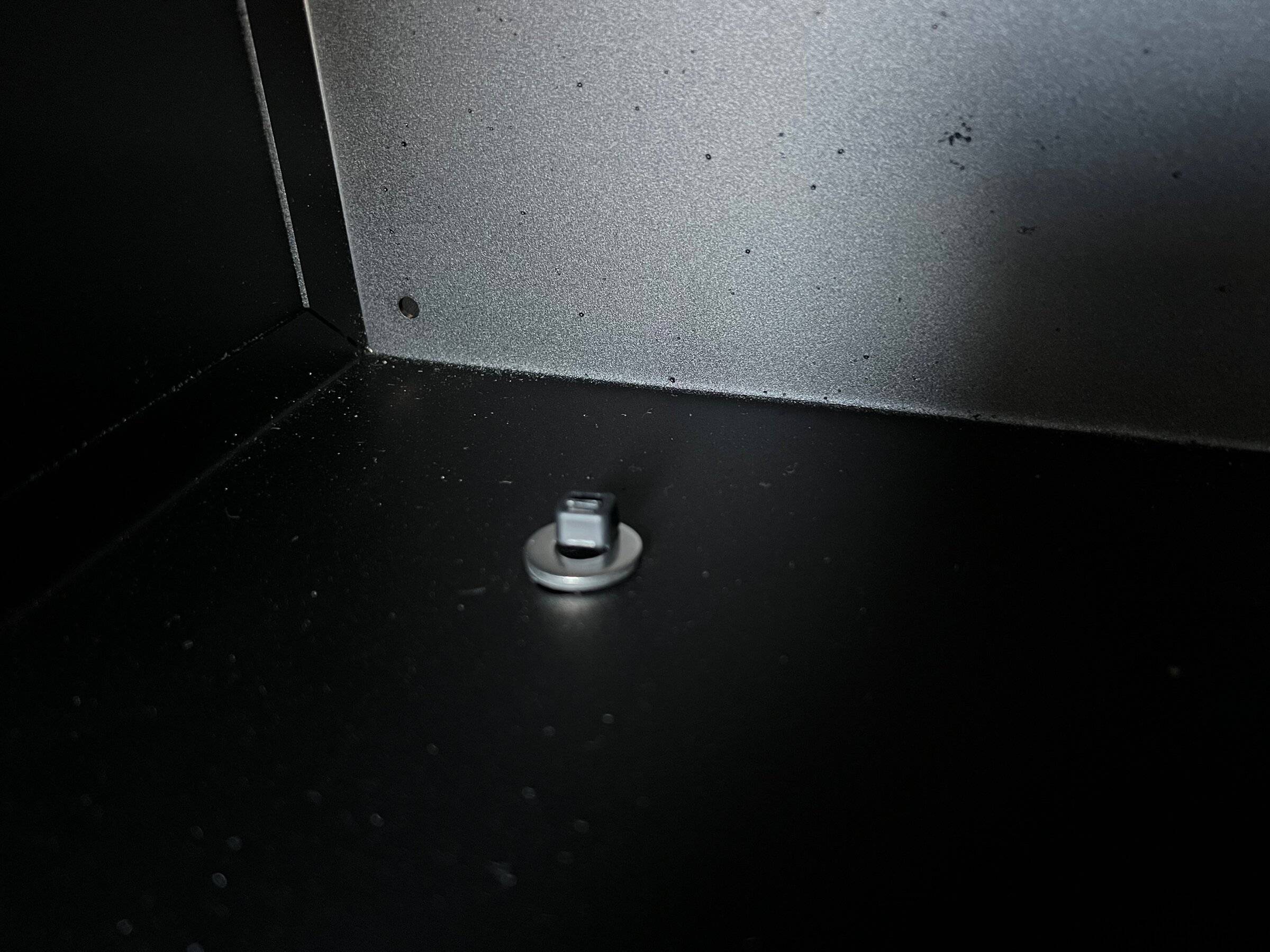

I had some leftover RAM flat-surface base mounts from a prior vehicle, and those worked great to support the rear of the box and allow it to clear the steel hoops. Then I used some heavy-duty zip ties and washers to hold the rear of the box down. It's working well, but I will probably try to find a more robust way to secure it down in the future. Plus, I'm waiting to see how Rough Country did their 2 door install....
Installed in this manner, it does still allow access to the under-floor storage area in the back.

I saw an install video for a 2 door, and they removed the rear hook loops on both sides. Then the spacers go where the bolts were, then the box is set on top of those. The drawer removes, then the bolts go through the bottom of the box, through the spacers and bolt into the threads for the loop mounts.
We're considering one of those, so I'd be interested in hearing how it holds up.
It mounts the box right at the rear, close to the tailgate.
My only issue with that is, it covers the rear tub/storage area if you have one.
EDIT:
Oh wait, I think I see what you mean now. When you say they removed the rear hook loops on the back, you mean they removed all 4 of the tie-down points in the rear, and just used those to secure it. Those indentions for those tie down points are deep though, so a single spacer on each one wouldn't work.
So that pushes it all the way to the rear door of the Jeep and makes it end up in front of the rear seat latch loops.
Yeah, I'd rather have the open space at the rear of the Jeep instead of behind the front seats.
This still gives me some space behind the seats as well.

EDIT:
So that pushes it all the way to the rear door of the Jeep and makes it end up in front of the rear seat latch loops. Yeah, I'd rather have the open space at the rear of the Jeep instead of behind the front seats.
Yeah, that was the video I saw. Nothing on the floor, no mats, just the 4 spacers and bolted through the spacers to the floor. It puts it darn near flush with the rear door, and the seats are flipped forward I think. On the 4 door pics, on their website, they show it moved forward using only the front two of those ring attachments, with a small space to the rear and one set of rings showing. Fits easily behind the rear seat of the 4 door. They pull a pair of the more forward hooks for the front bolts.
If you look at their install instructions, you'll see they install into a 4 door, but if you look at the bottom of the box when flipped up, there are several mounting holes. Using the 2 holes to the rear on either side, will bolt into the 2 door hook locations. Being 23" deep, I don't think it will clear the rear seat of the 2 door, but would with the seat folded.
The reason we're considering it, is if I mount the box to the rear, I can make a solid platform in front of it to put the dog cushion for puppy transport.
Our Jeep is going to be an escape vehicle for all the family members, including the queen of the fur people especially.
