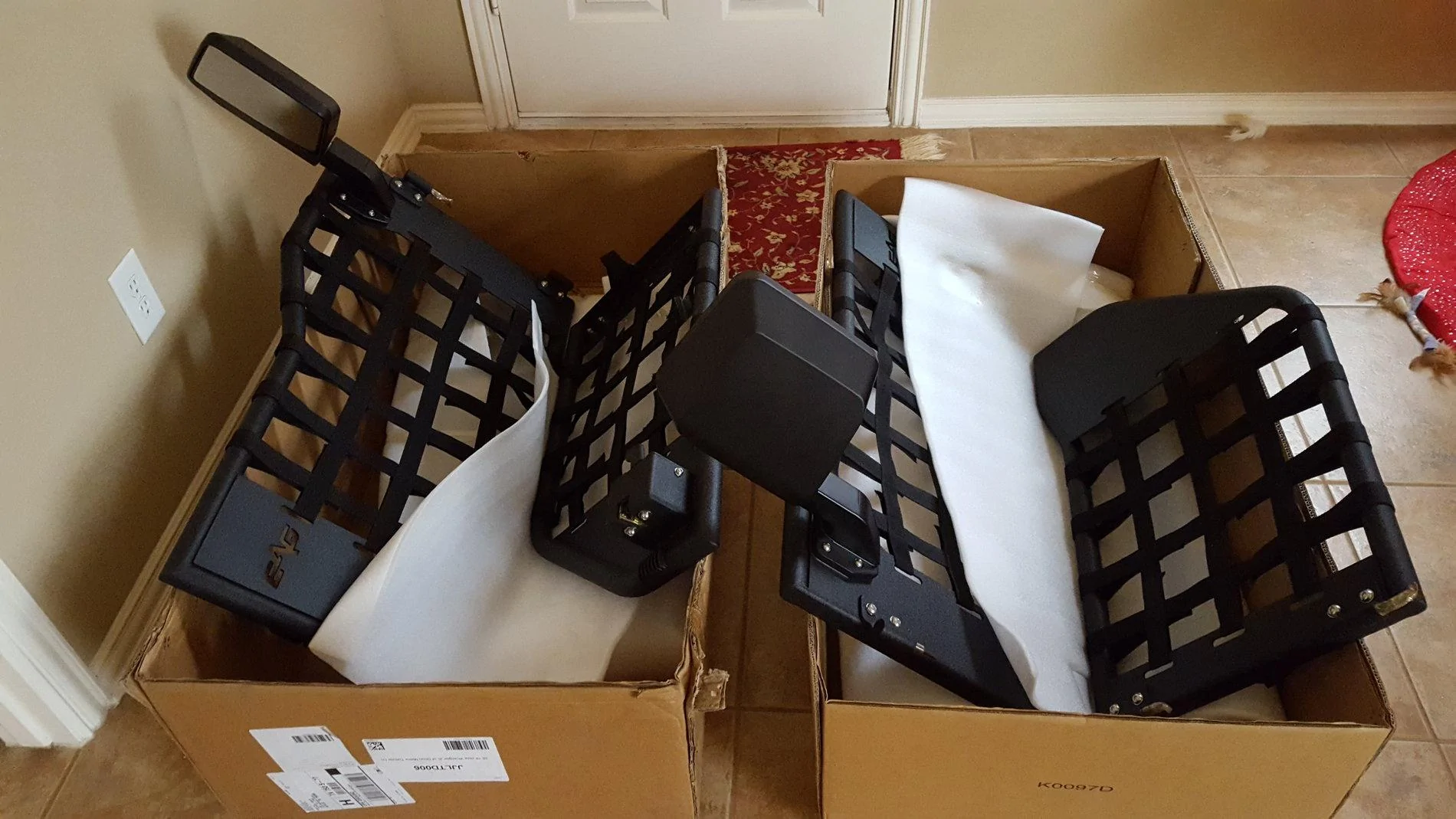

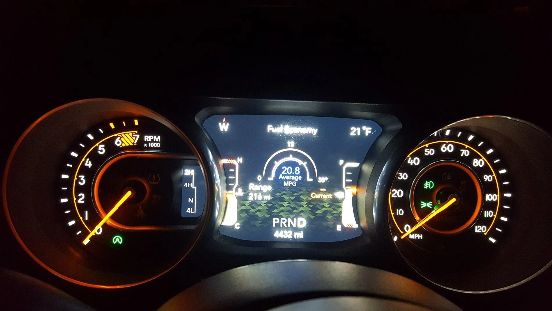

My cold record is 21 degrees Topless. Will I open Jeep in the rain no. Leather and rain don't like it. lol, I get more stares from Non- Jeepers when its 30 degrees and I stop at light windows down and Top open. :) they stare like I'm a nut. I still see Jeepers closed up driving here when its 40 55 60 degrees. Your Jeep was the first one I saw on the forum with Doors off and Topless. My x-mass present is still sitting waiting for a break on rainy days. Vicious Off-road doors. I can't wait to see how Jeep looks topless with them on. Have you thought about some for your Jeep?
