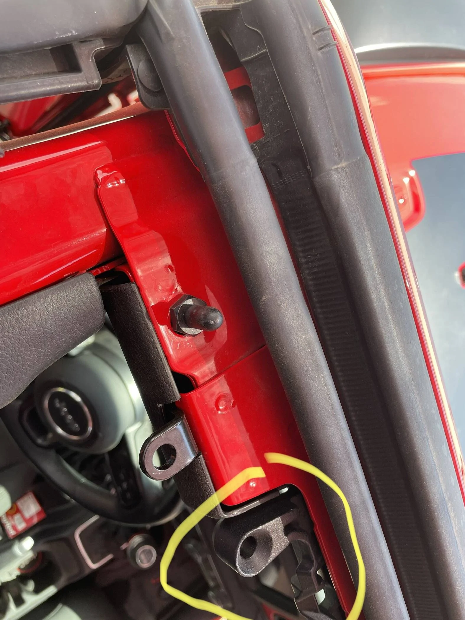

Just fyi, you will need the targa brackets for the softtop to latch to and you will have to remove the locator pins from the header in front to clear the softtop.

If you are going to run a softtop then you will need the targa brackets and remove the pins in the picture above. To put the SOT back on you just have to put the pins back but the targa brackets can stay in as they don’t interfere with the SOT.

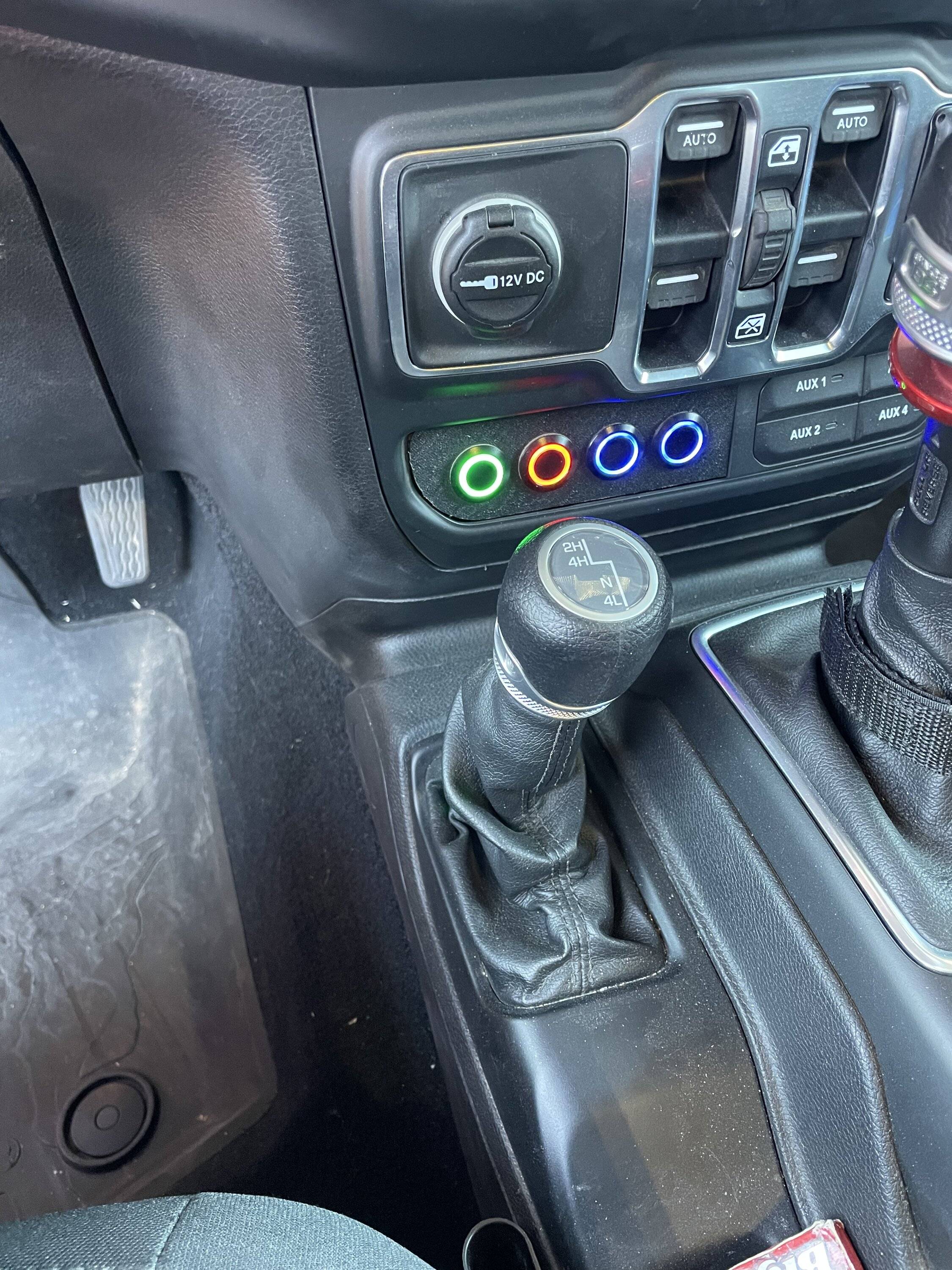

I have done a few other things to make swapping between the tops easier, I removed the SOT switch from the windshield molding and installed these to run the top, green is open and red is close.

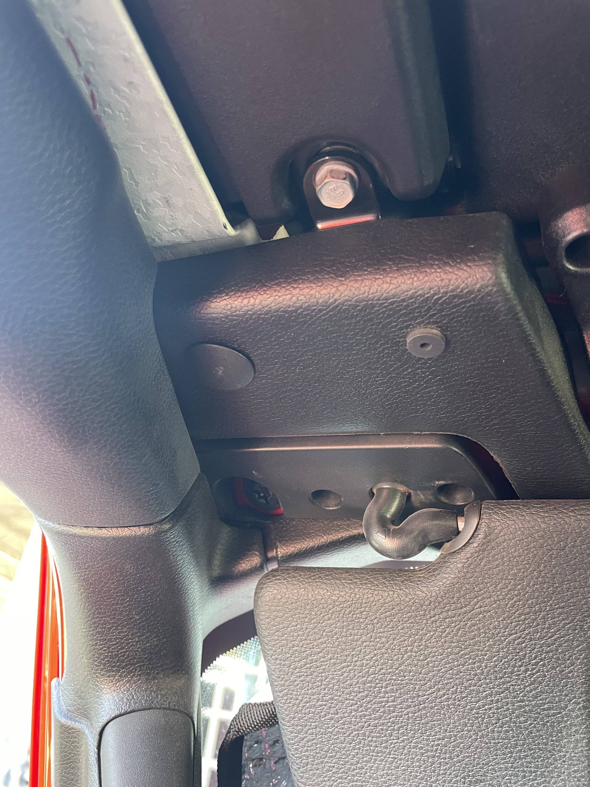

I also put a regular windshield molding in and drilled a hole to make installing the stricker bracket easier.
Jeep Wrangler JL Sky One-Touch Power-Top removal issues? 5F52BFD5-A458-4903-9921-AAA76A54089D
I put a plug in the hole for a cleaner look.
