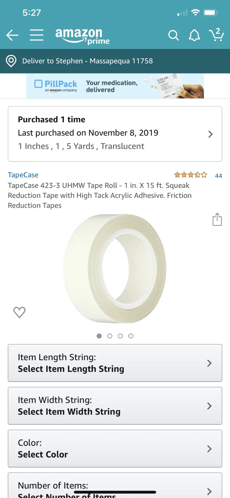

Polyethylene tape worked like a charm. No more squeaks and the latches close even smoother than before. I. have plenty extra for any local JL’s that want to stop by and use it:
Does the tape still work?

Did this fix the issue? And what kind of tape did you use?
It's sold on Amazon... search for TapeCase 423-5 UHMW Tape Roll 1 inch
According to others in this thread, it works.
I've ordered it and it arrives tomorrow.
I'll update everyone on whether it works for my 2020 Sahara.

Just got the tape today .... annnnnnnnnd
...... it WORKS!
I feel like I should send whomever in this thread that figured that out a BIG check!
Today was the first peaceful, fun drive I've had in my Jeep since purchasing it.
I rode into work WITHOUT music so I could hear everything...
And after a very bumpy Atlanta city street ride, not a PEEP.
Completely quiet ride!
Thank you!
Now folks need to get the word out to the dealerships... such an easy fix.
