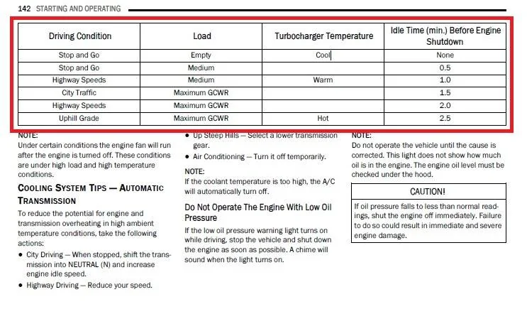

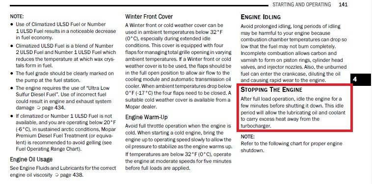

You don’t need to idle when you get home.
Screen shots from my Owner's Manual:
Jeep Wrangler JL Idling engine before start up and shut down 2.0 Turbo cooling 2
Jeep Wrangler JL Idling engine before start up and shut down 2.0 Turbo cooling 1

The 2.0T has a liquid intercooler. The separate circuit has its own coolant reservoir at the front of the engine bay.
Yes I have seen this it’s on the first page of this thread and in most situations most people are not going to be under load and will be ok to shut the car off without idle. Ive also said most turbo charged cars or jeeps… don’t require an idle period. So to reiterate and to be specific it’s not needed under normal operational use.
