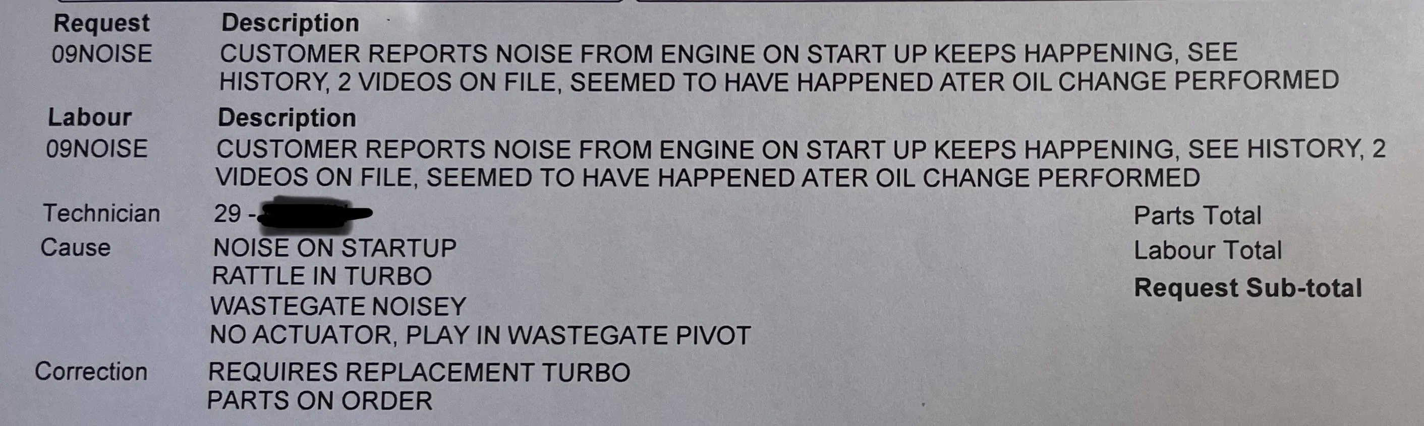

I noticed a new noise coming from the turbo whenever I turn the Jeep off (See Video) so I decided to bring it in for another look. They have determined that it’s a problem with the turbo and are going to replace it… must be common since the turbo is on back order up to 2 months!
Hope this info helps anyone with a similar issue and I’ll post after the repair to let anyone know if it solved the problem.
This is my rattle as well. There are two rattles being mentioned here. One is the turbo/wastegate rattle like I have. The other sounds like bad rod or main bearings. The turbo rattle is intermittent and stops when you rev it. That main bearing sound is like a cold constant rattle tapping that goes along with RPM. That’s a rotating assembly rattle - definitely NOT normal and I wouldn’t let the dealer off with adding an oil additive lol. The real rattle that’s coming from the turbo/wastegate is different and as stated above requires a turbo replacement.
Part finally came in and turbo has been replaced. Problem solved…. for now anyways! The dealer told me when they took the old turbo out it looked like it was just a loose nut inside the turbo that might just need to be tightened but not sure if that would fix the problem. Dealer always just replaces parts. Hope my info helps you guys out.

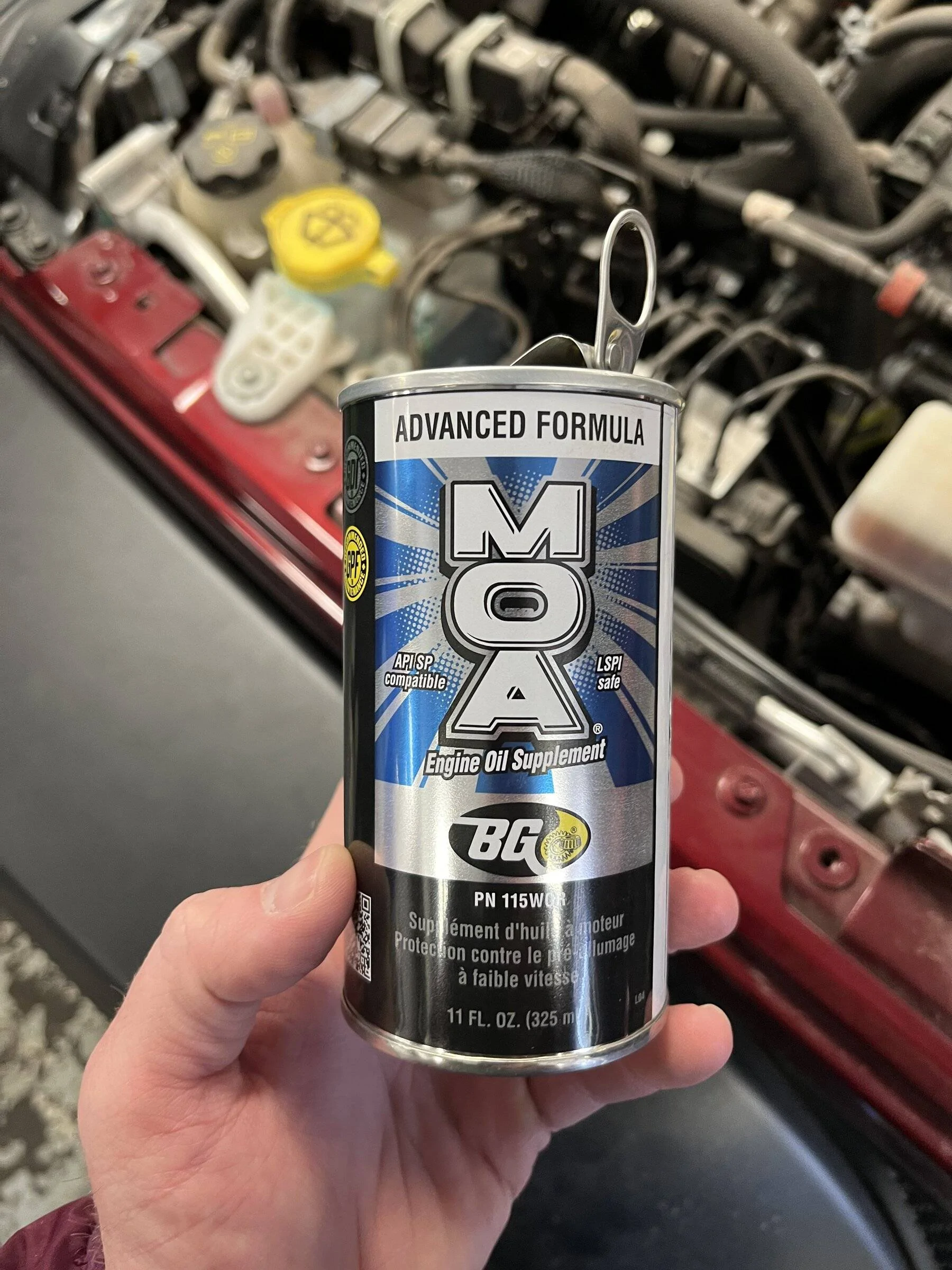

Our 2 do the same it's a known sound in the 2.0s. They sound like diesels. Nothing to worry about. Odd the dealer used an additive tho.

The dealer put an oil additive in the vehicle to clean the internal pieces.
I would have them change the oil to remove oil additive, as it is not recommended, should be nothing to clean with regular oil changes....
