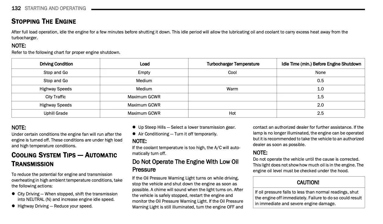

Here's the idle recommendations as outlined in the owner's manual. It follows several sections of information about the diesel engine, but such headings are labeled diesel or gasoline engine. This heading is not specific, so I take that to mean either engine with a turbocharger (2.0 included). Following the practice certainly can't hurt.
Jeep Wrangler JL Idling engine before start up and shut down 2.0 Screenshot 2024-06-17 at 08.07.06

Sorry, maybe I am misunderstanding. I dont see this page in my 2024 owners manual. I have to 2.0 turbo gas only. Is the chart posted in this thread for a different model?
Hey Matt, if you're referring to this chart:
Jeep Wrangler JL Idling engine before start up and shut down 2.0 1719933706113-yz
There is a freeway near me with a 70mph speed limit, about a mile long with a decent grade. My turbo inlet temp is over 1000*F for the entire climb. At the top It becomes slightly downhill for 1/2 mile, then my exit ramp to a stop sign. At that point, after light throttle and coasting, it's still reading over 600*F.
So they can get pretty hot, significantly hotter than either oil or coolant temps, especially under load. That heat then takes some time to be carried away.
Granted I'm watching temps an EcoDiesel but I think the temps are similar. Lacking a gauge, I'd say those idle times are sound guidance for anything turbocharged. I have the Banks iGauge and try to let mine idle until the turbo inlet temp is under 450*F. Which, by the time I get to the house is between 30-60 seconds depending on air temps (it has been ~100* outside lately).
