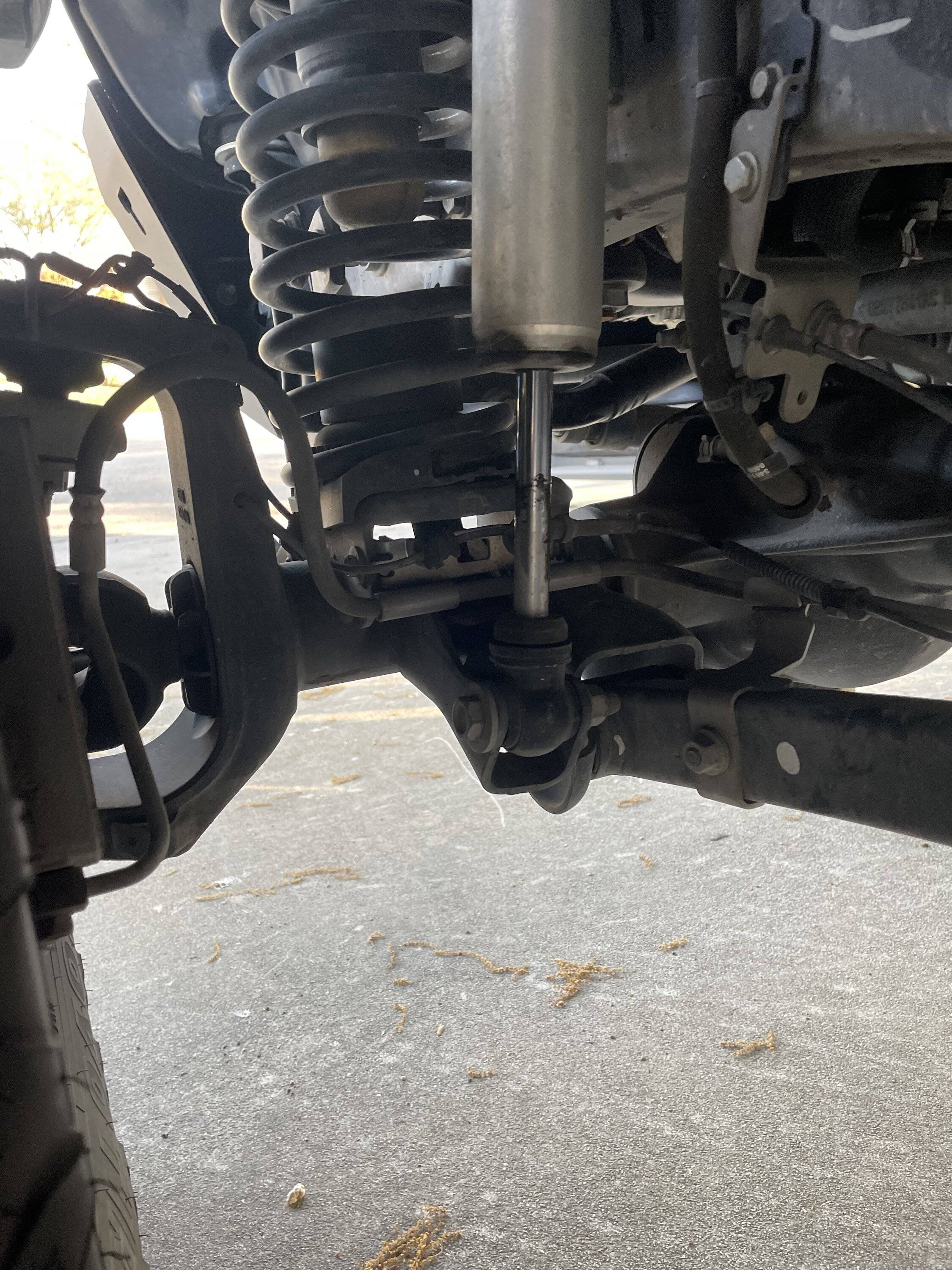

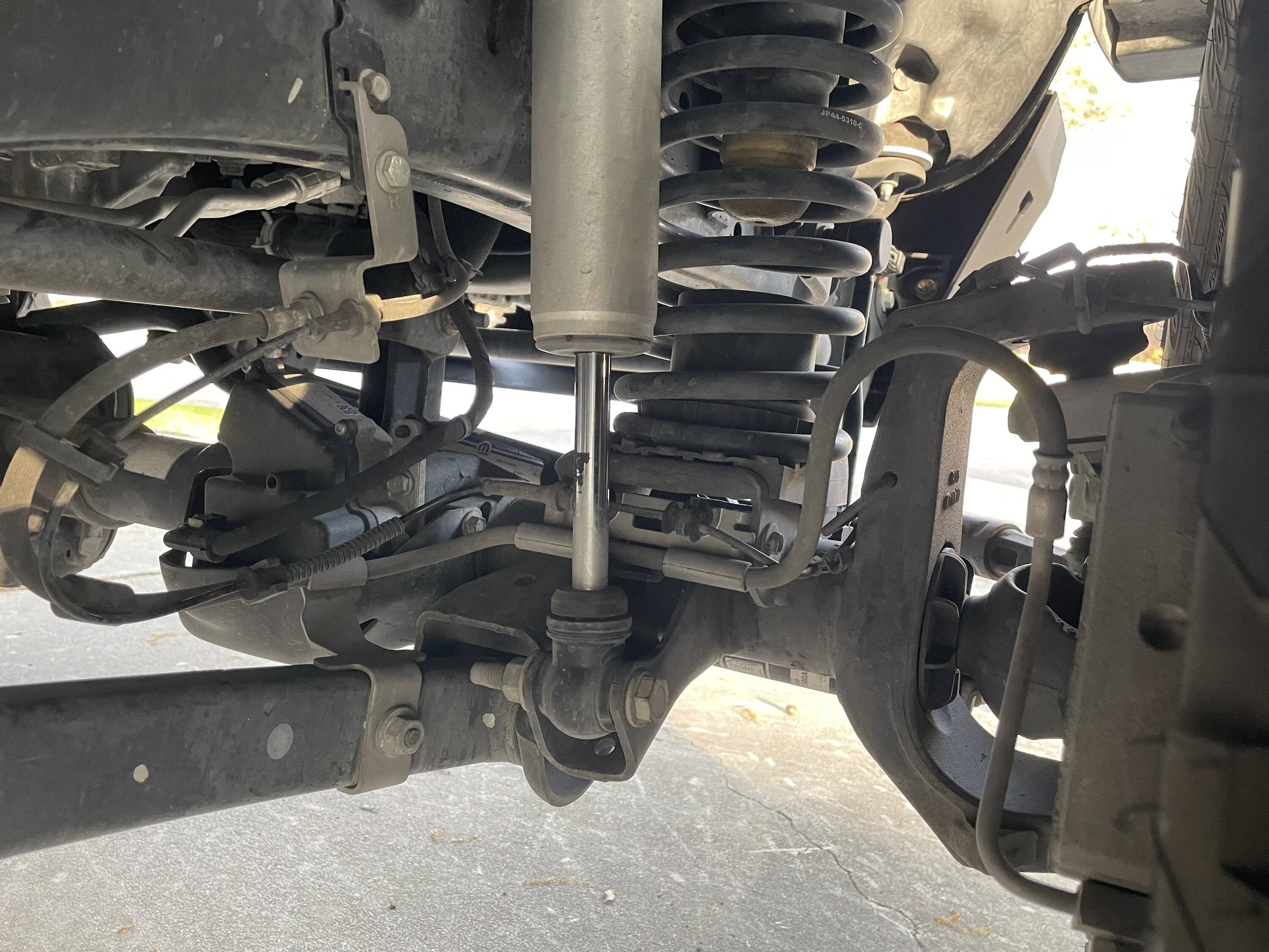

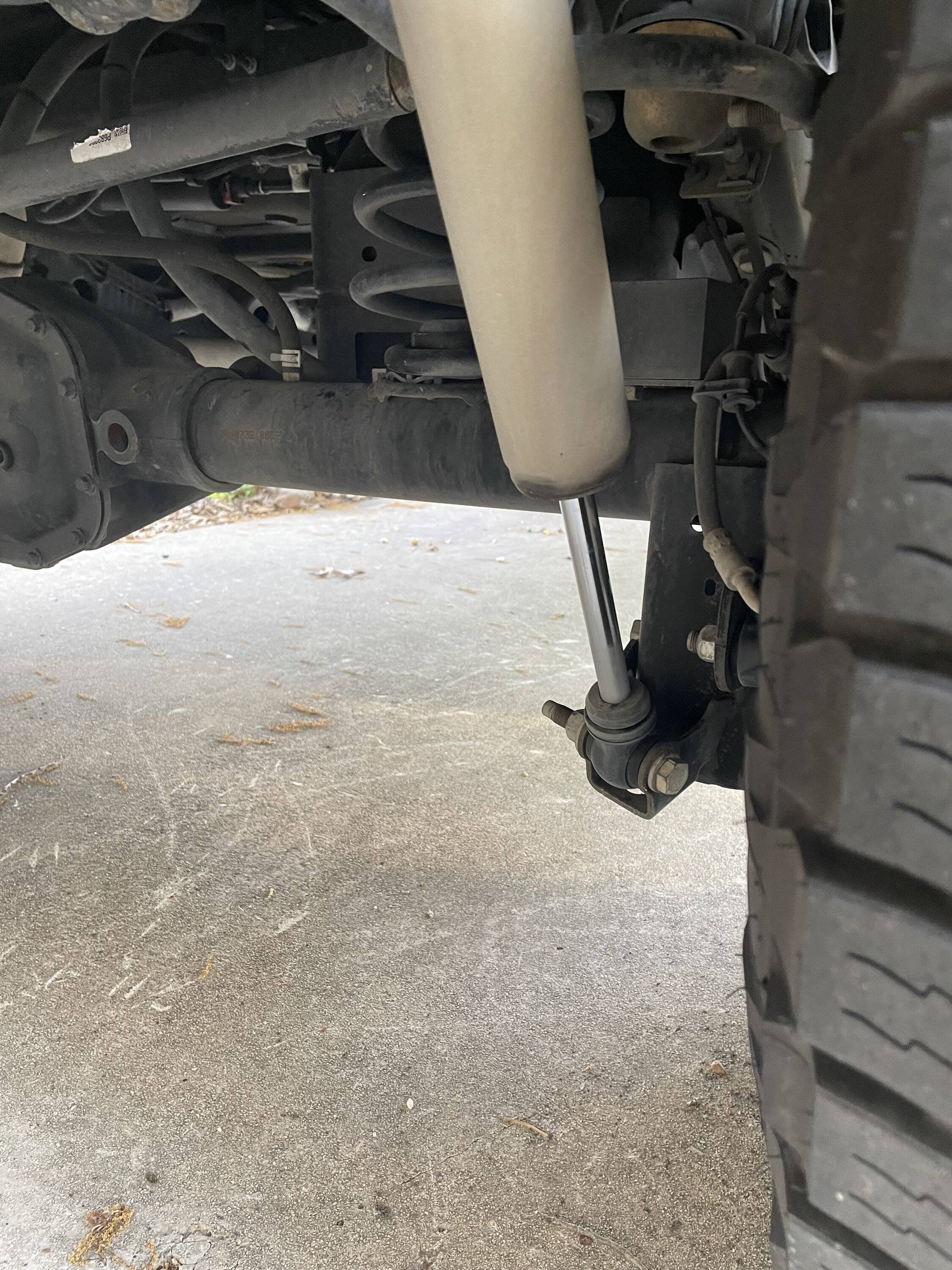

I tried searching but struggled with the search engine. What is the general consensus on the status of three of my fox shocks. From a dynatrac lift.
It's hard to tell, because your images do not show the bottom surface of the shocks where the chrome shaft protrudes, but it looks like the 1st shock & 3rd shock are leaking oil which usually indicates blown shock seals. I have the same issue with my Fox shocks from a Mopar kit. Time for an upgrade.

Only thing I notice is that your rear shock lower bolt is mounted the wrong way.

if you have any doubt, why not ask Fox?
you may be able to send them back for a rebuild/service; their Service Intervals are actually remarkably short. (should i have said 'shockingly'?)
you might even be able to have them re valved however you want.
