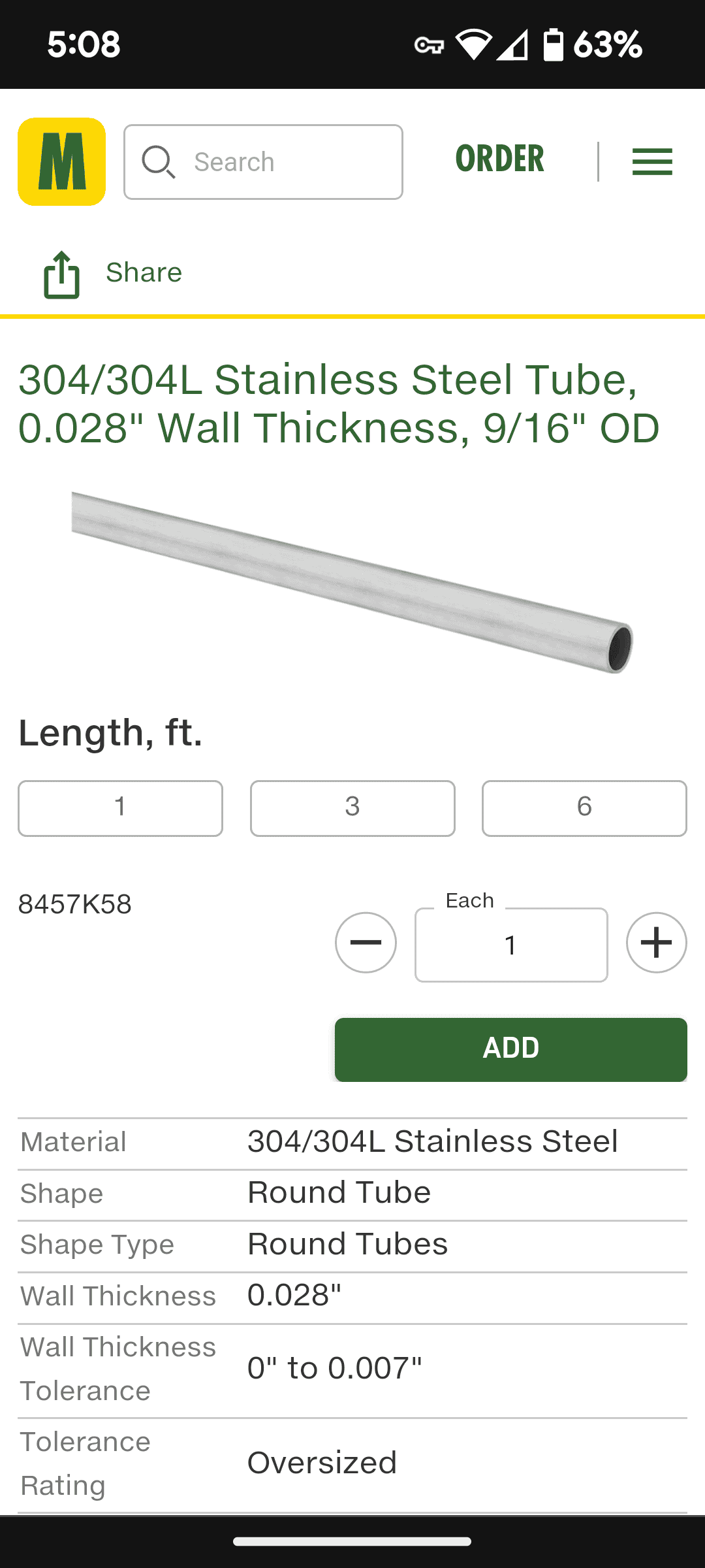

Got the upper bushings pushed out easy enough. Issue is pushing the new one in. Any tips or tricks getting the new one in? McMaster Carr has stainless tubing to use as a sleeve in the lower mount

I used a heavy weight bearing grease. Alot of force with vise and a piece of tubing. It was fun, not too bad.

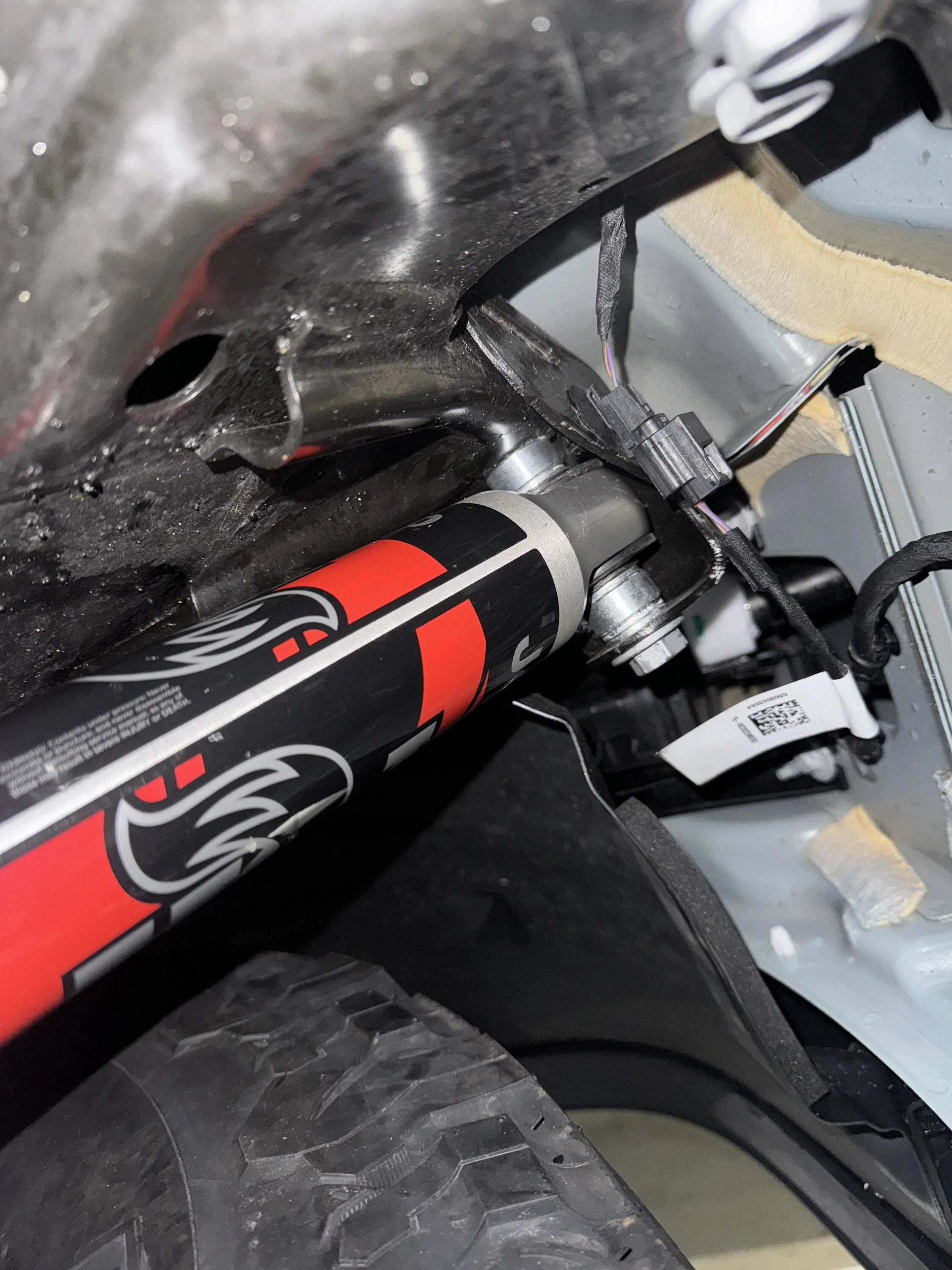

I thought I would help inspire some people.

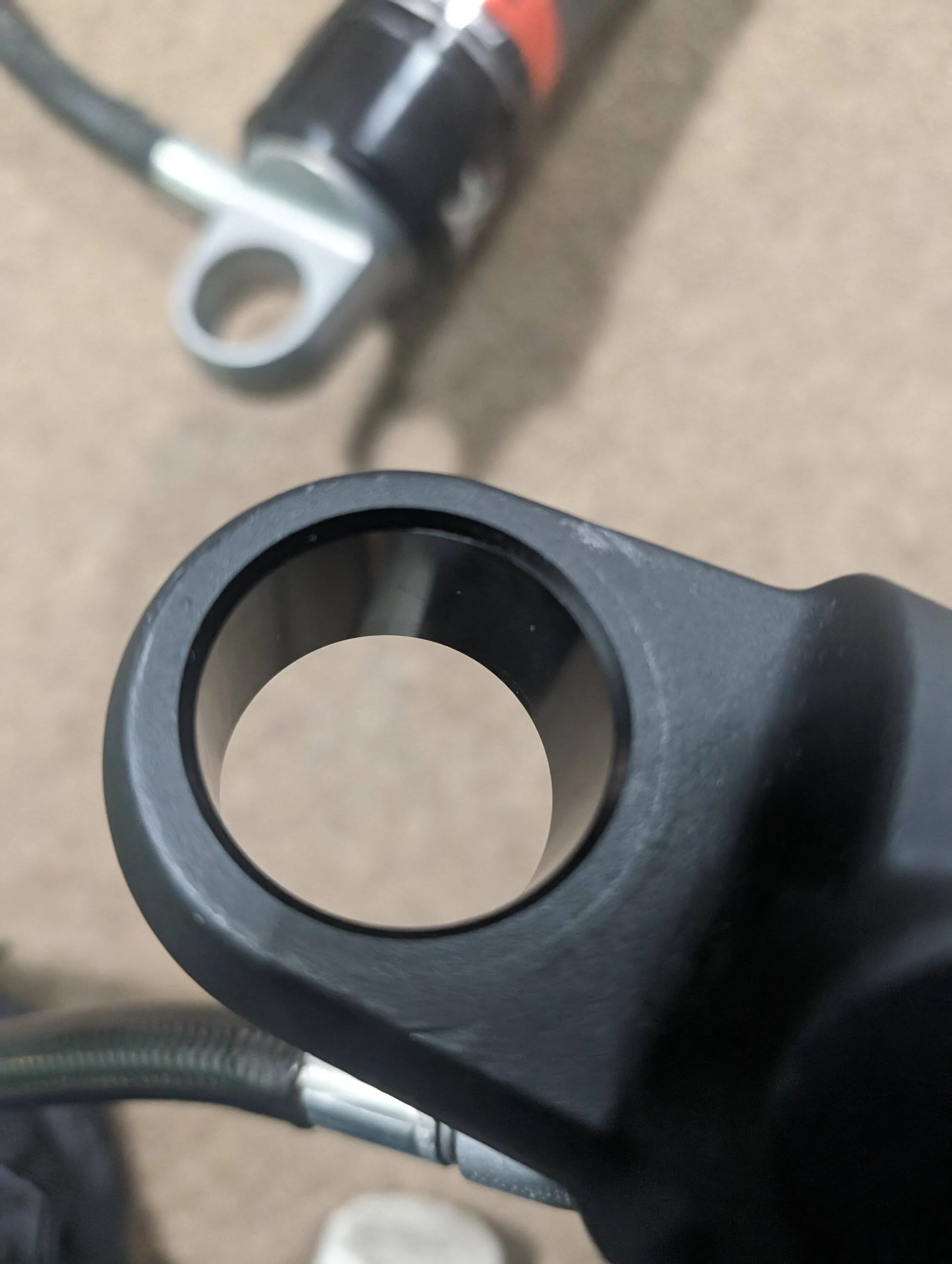

So after some data gathering through forums and folks from Fox and AccuTune- these shocks will work best with the same or similar rate as the stock springs. I wouldn't recommend these if you have varied too much from that:
Here's an idea I had and used and worked perfectly and took all of the slack out.
To Recap:
1- Fronts fit on with no issues.
2- Rears can be finessed (please refer to photo below).
so I recommend to do this:
- The shock eyes on the rear measure exactly 0.545" in Diameter
- an M12 Bolt, which is the same diameter bolt as what the shocks use measures 0.450"
- you need to take in the gap of approximate total of 0.0900"
So, you need to find a spacer that can take up that slack.
I made my own. You can get 22-gauge stainless steel sheets from Home-depot. I bought some aviation snips/sheet metal sheers from Home Depot.
the Circumference is approximately 1.60", so you need the length of your spacer BEFORE you cut the piece out to be this. Then you need the width of your space to be an approximate 1.5"
I went to Ace hardware and bought 1/2" ID spacers (about 0.625" OD) and some M12 washers. Worked perfectly.
Please see below for my homemade spacers.

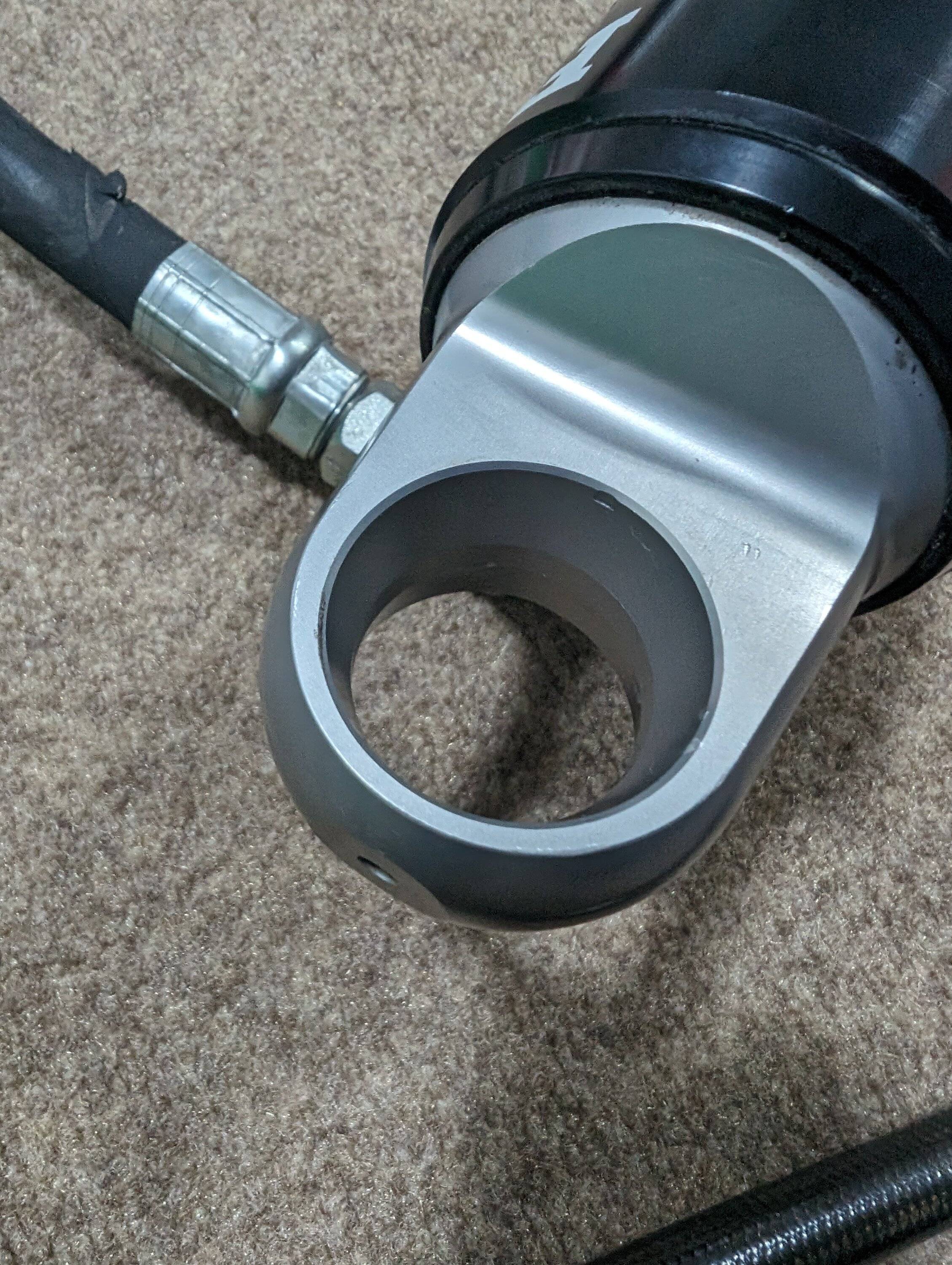

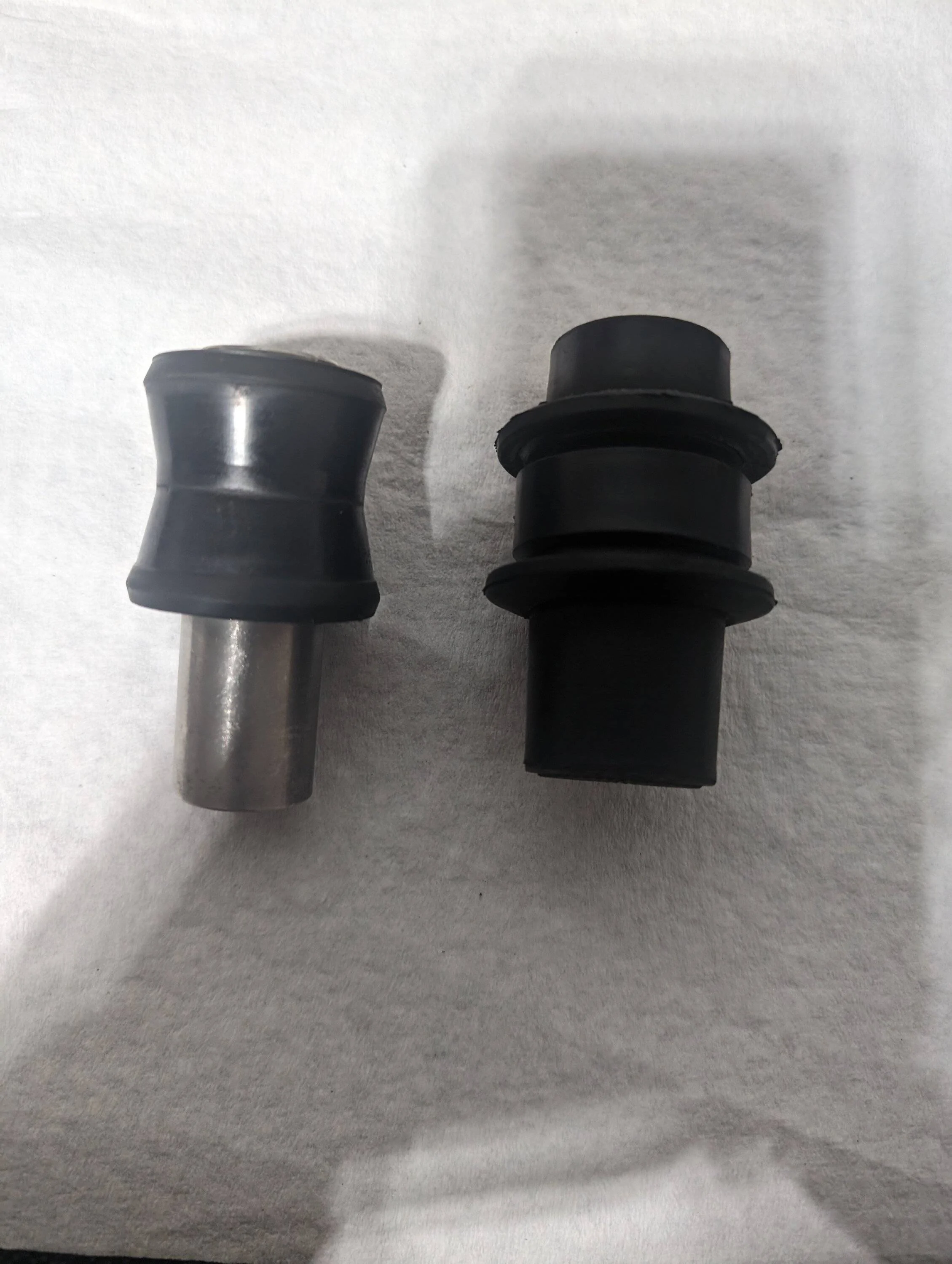

I am actually taking my Mojave shocks and installing them on my wife's wrangler high-tide. I pressed out the old Majave bushings (front and back) and I am ordering bushings from the Fox Performance Elite 2.5 Series Reservoir shocks for a JL. Unfortunately, the bushings are different.
dayusmc
Dec 30, 2023
148
108
Jersey Shore
2020 JL
Update, the OEM Mojave and the Fox Performance 2.5 elite shocks have different style clevis. The OEM Majave shocks have straight through bushings, the Fox Performance 2.5 shocks have a hourglass shape bushing.

If all you're concerned with is the Id of the majave bushing you can sleeve it. I had an earlier post, stainless steel tubing from McMaster works perfect. The ID fits the 12mm bolt perfect.

Not just the ID, but the rear bushing offset. Also my bushings (in my Mojave shocks) are a little beat up, so I want to replace them. Unfortunately they do not sell the bushings separately from the shocks...

After a lot of digging...
Mojave Shocks in JLU
(2) Mopar Part # 68274895AA – Rear Upper
(2) Fox Part # 014-11-044 – Front Upper
I was lucky enough to get someone that was willing to look up the part drawings and check the dimensions of few different shocks to compare them...
