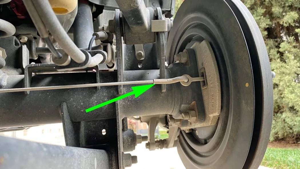

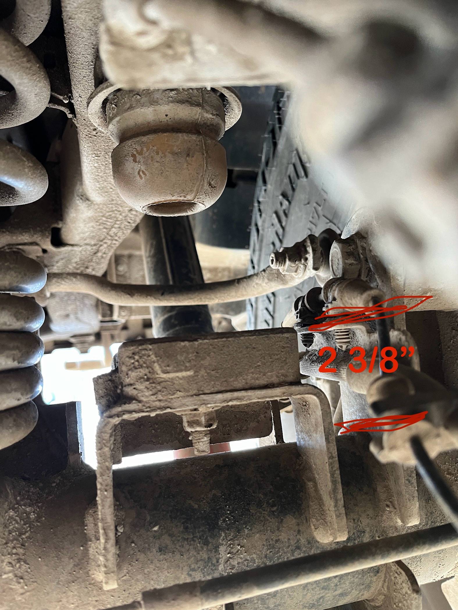

It's 1.25" blocks, in addition to the axle bracket that's already 1" taller than a standard JL.
Jeep Wrangler JL Gladiator Fox shocks on JLUR? img_0134-jpe
Standard JL (ignore the arrow)
Jeep Wrangler JL Gladiator Fox shocks on JLUR? 23-rr-brake-parkin

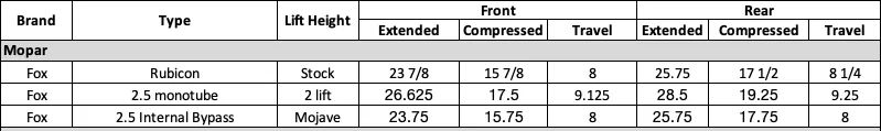

I said if your Jeep is lifted you need shock extensions. The stock Rubicon and Mojave shocks are short... If you lift the jeep, and you have short shocks they will be toped out.
Let's look at my Jeep's front suspension. I have a Rubicon lifted with a 1" spacer. I have 4.75" of bump travel and 2.63" of droop with stock shocks, and according to your chart the compressed/extended lengths of Rubicon/Mojave shocks are effectively the same. Accutune recommends 1/3 to 2/3 of the shock should be up travel, which is a range that I fall in.
Let's say I take your advice: " If your JLU is lifted at all you will need to run shock extensions". I'm going to assumed 2" shock extensions. The shock will have 2.75" of bump travel, and the fully compressed shock will leave the axle 1.5" away from touching the bump stop. The compressed length of the shock is 15.75" + 2", but there's only 16.25" between the upper and lower shock mounts.
So how do I fix it? I could add 1.5" bump stops. Coincidently, the XR has 1.375" taller front bump stops, which is likely close enough to function well with the shock extensions.
