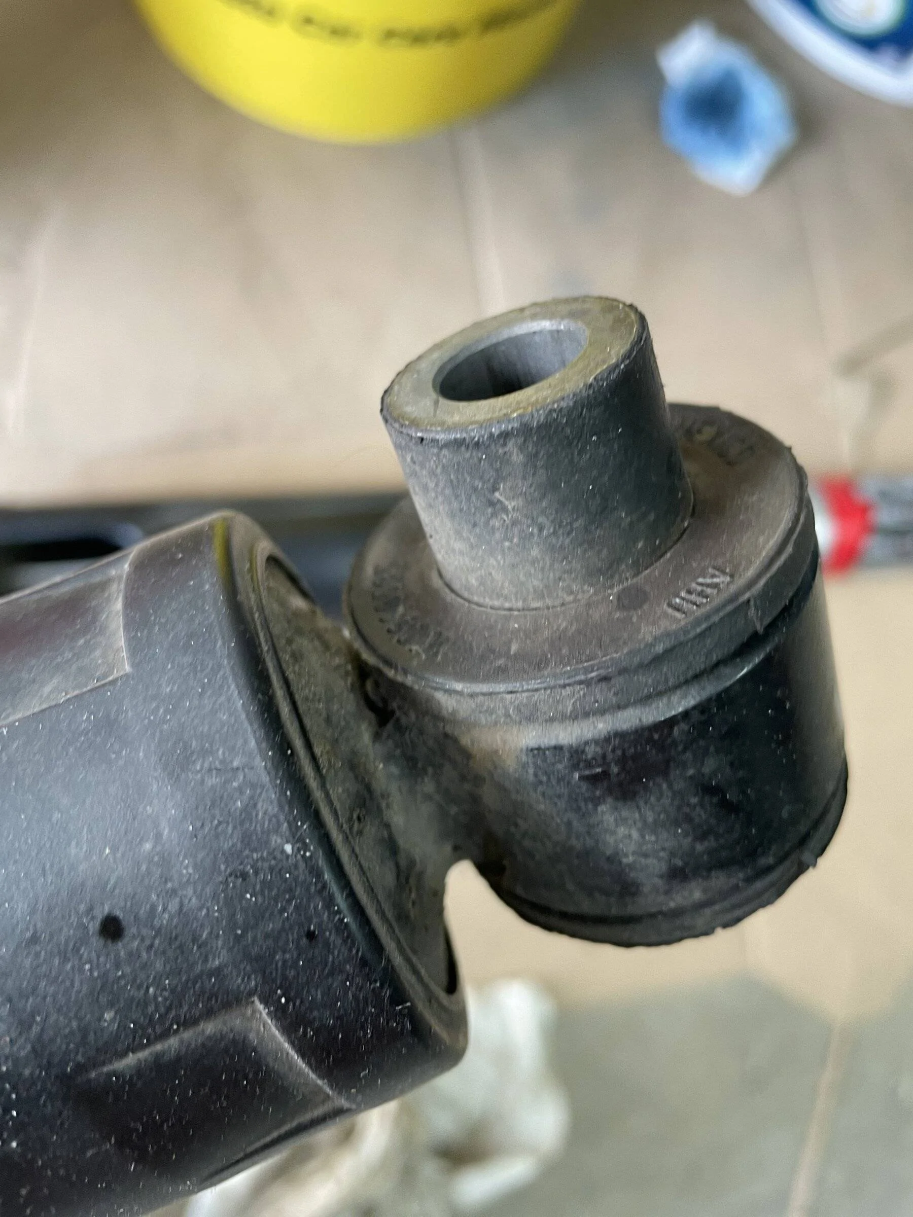

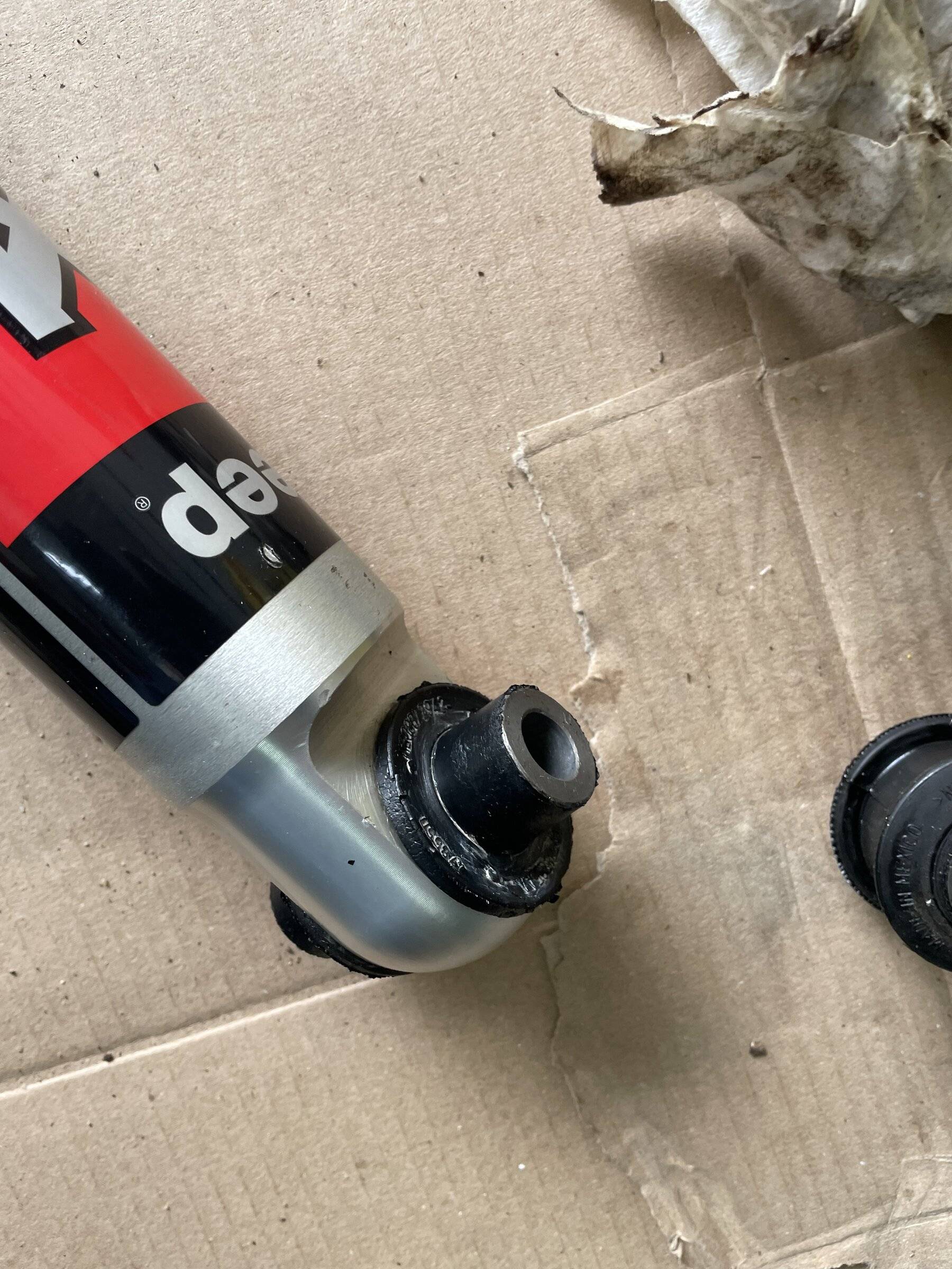

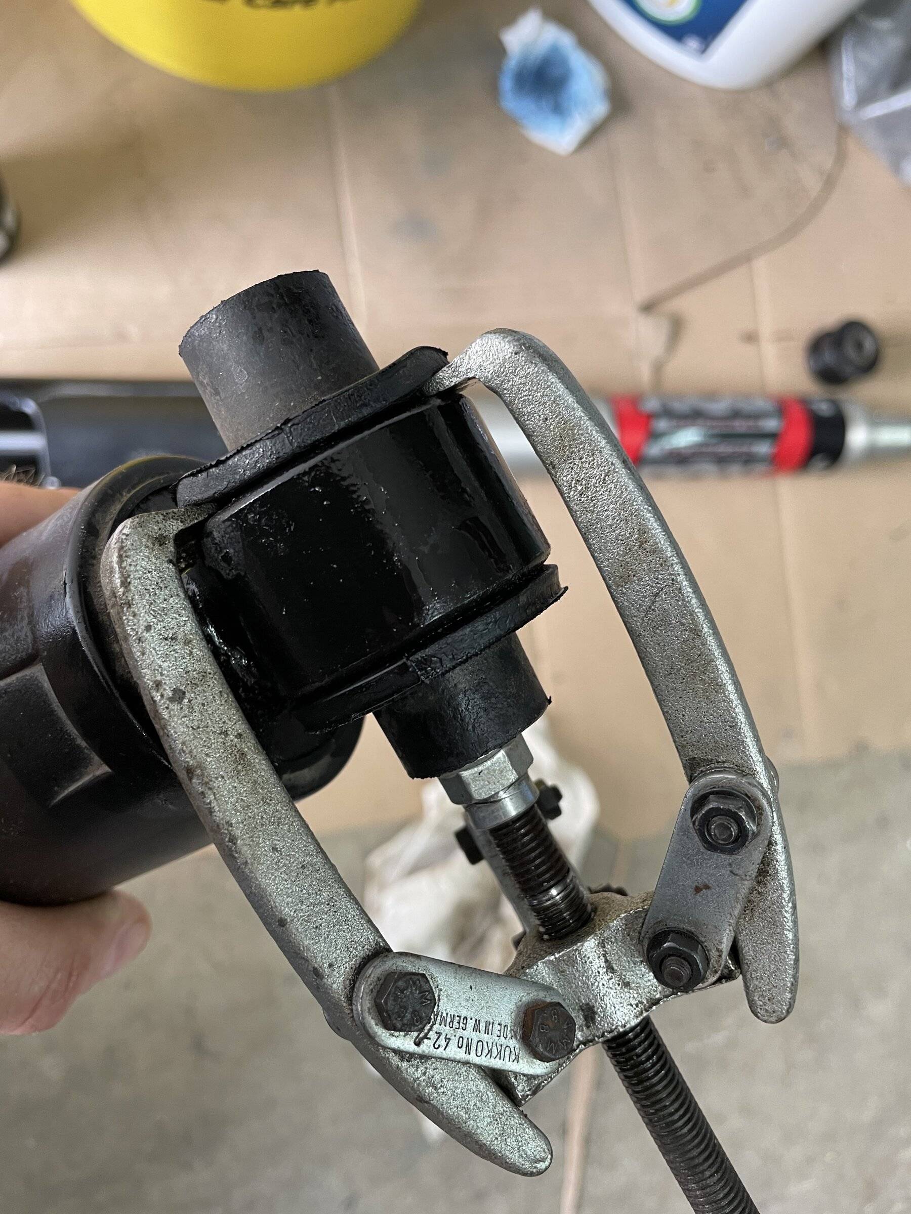

:) I got a set of Gladiator shocks now here in Germany.
i swapped the upper rear bushing with the oem Sahara Shock bushing.

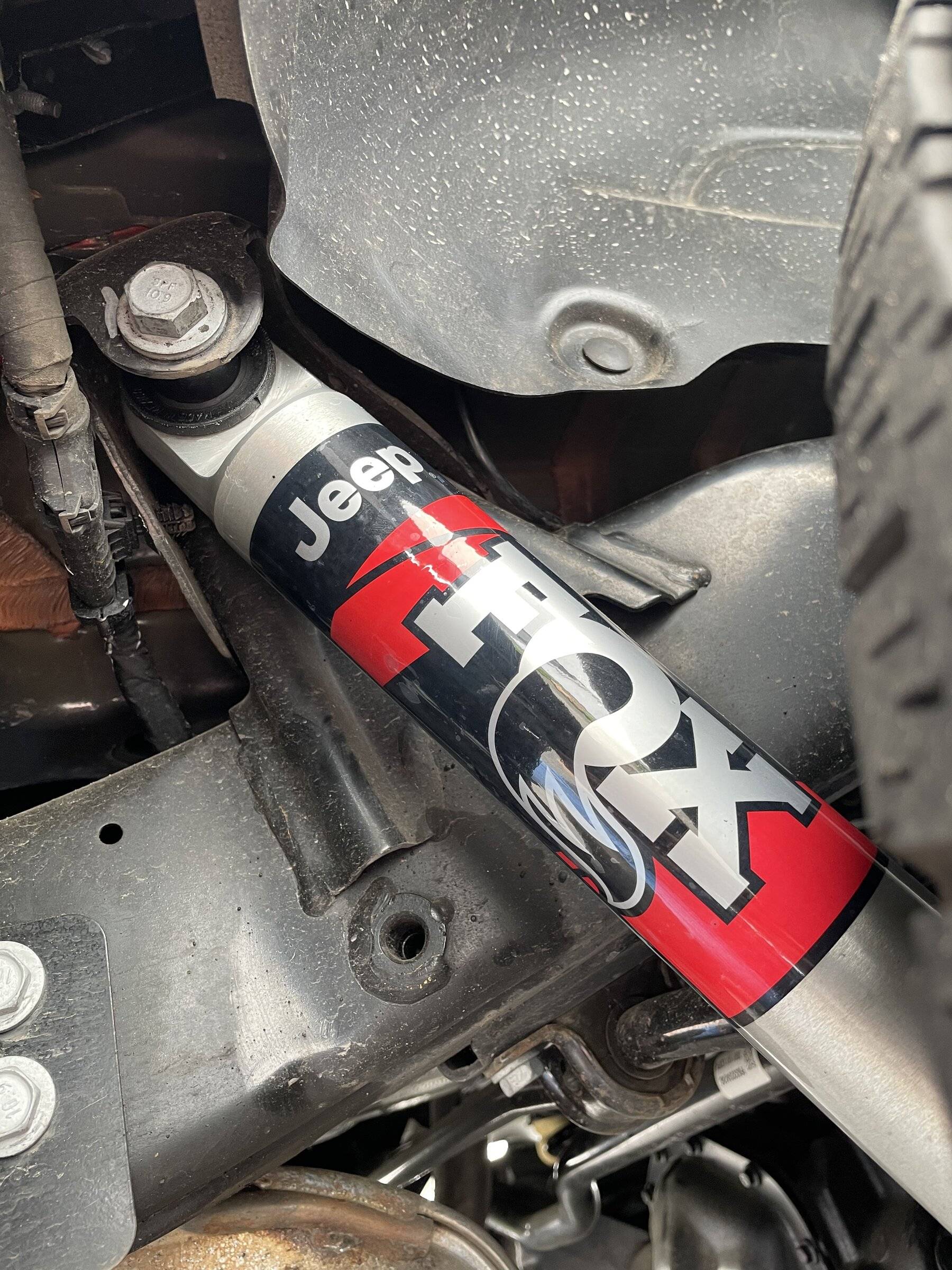

Do we have photos of the plastic dust cover direction… the front shocks have the opening facing to the front right? And the rears?
also I will maybe Ignore the 14mm hole in the bushing and just use it as it is with the 14 mm screw.
Will share first 4XE driving results soon.
would be great if someone could share photos of the dust cover direction front and rear just to be sure.

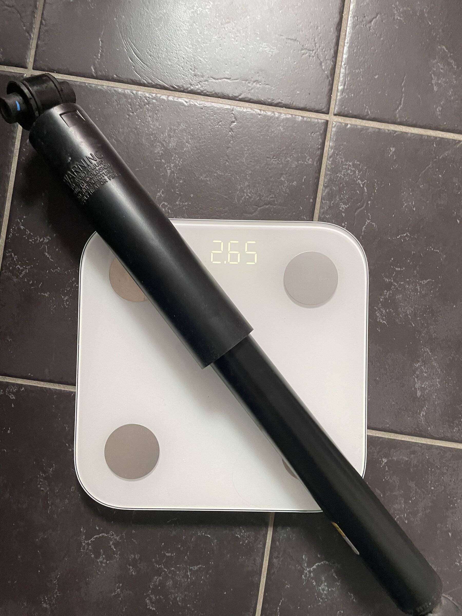

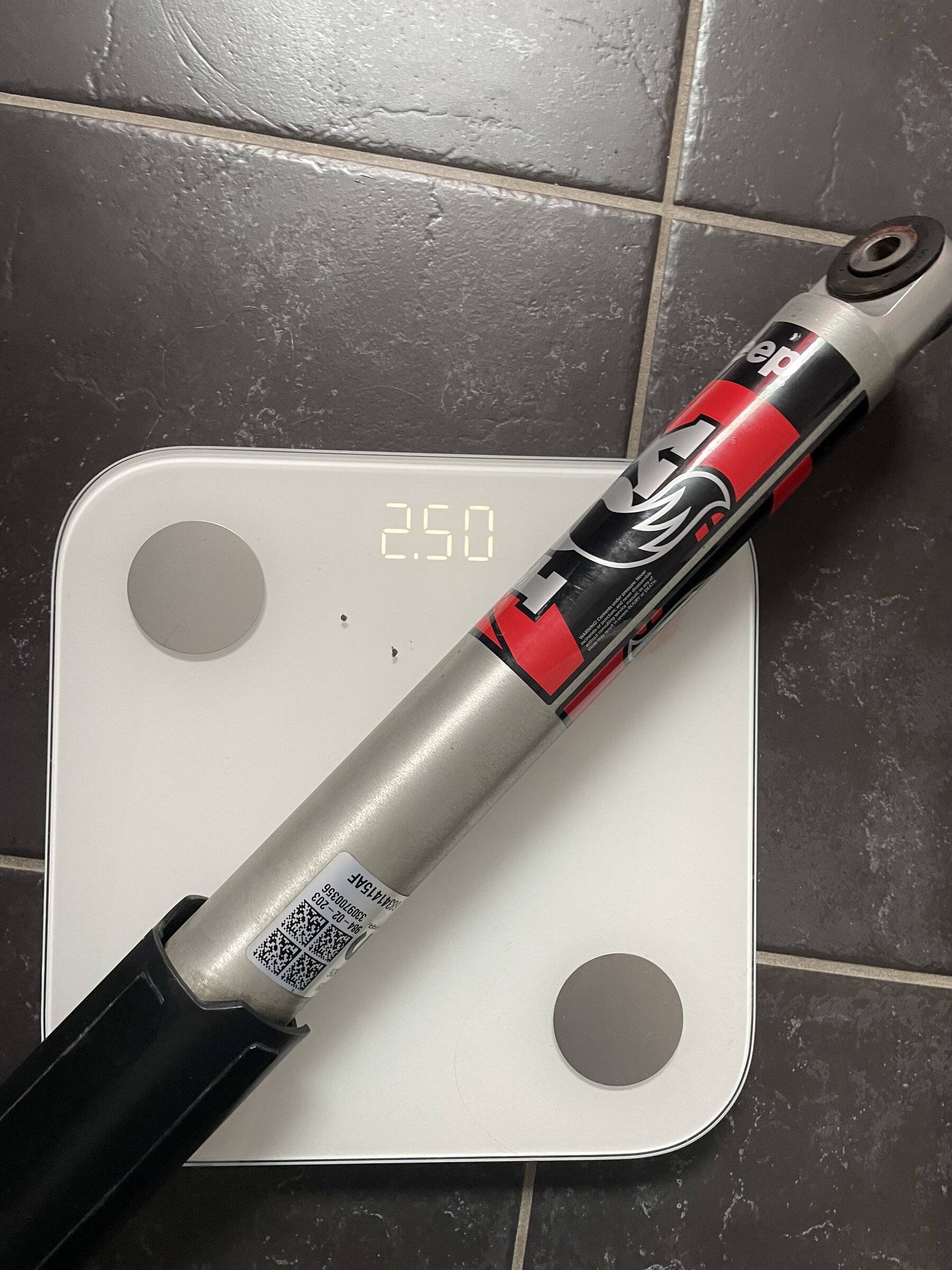

All installed… so on a Sahara 80th Anniversary Edition 4XE I would say those are really comfortable shocks… I need to tr some faster tests I think those are better with short hard bumps on the road.
and all are lighter than stock ones … steel vs Alloy
Greetings Monty
