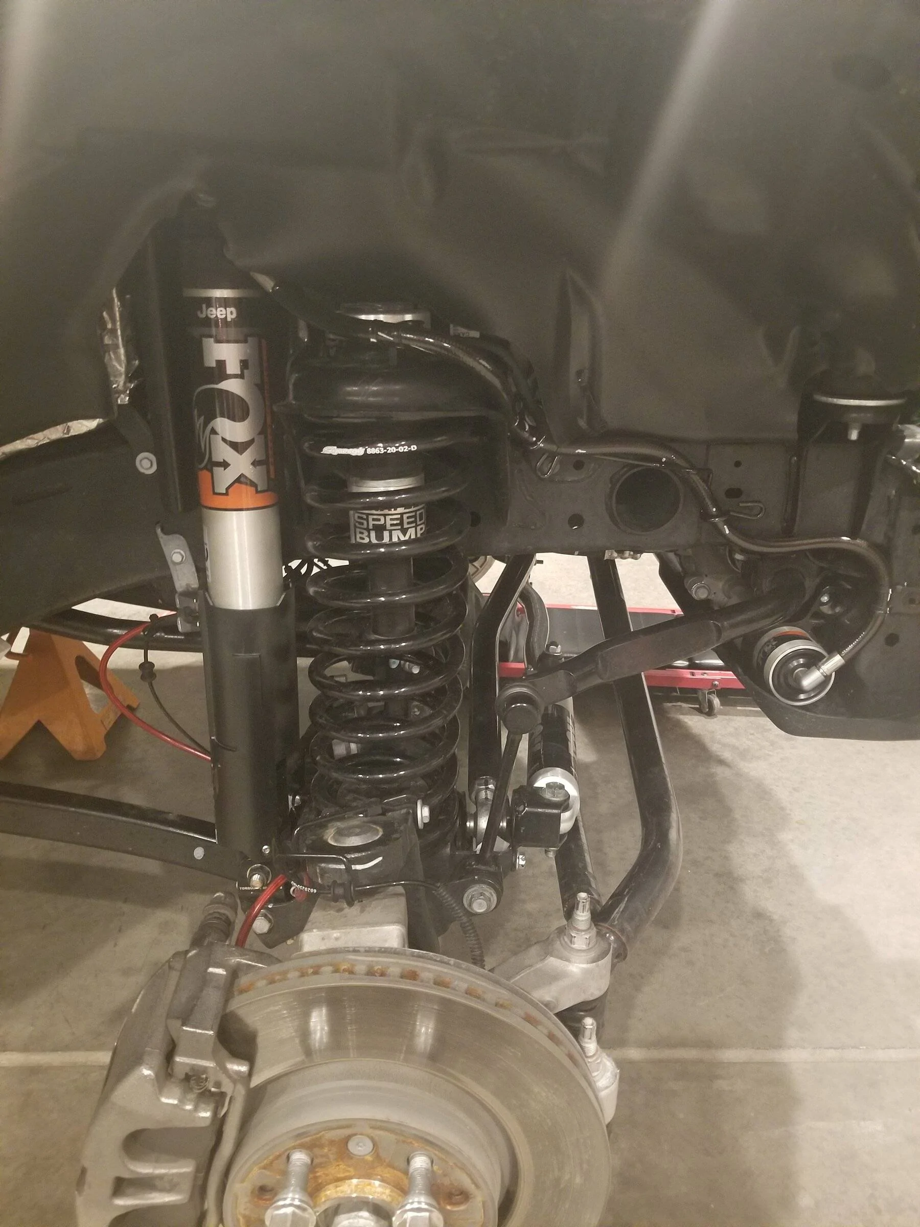

What are you doing for bump stops?
Still running the old TeraFlex kit, I put on day one. I really want to run the Fox 2.0 front and rear kit $$$$. Right now I'm just too happy with this set up. The rear could use the hydro bumps first. The front TF cushions work fine with the Mojave.

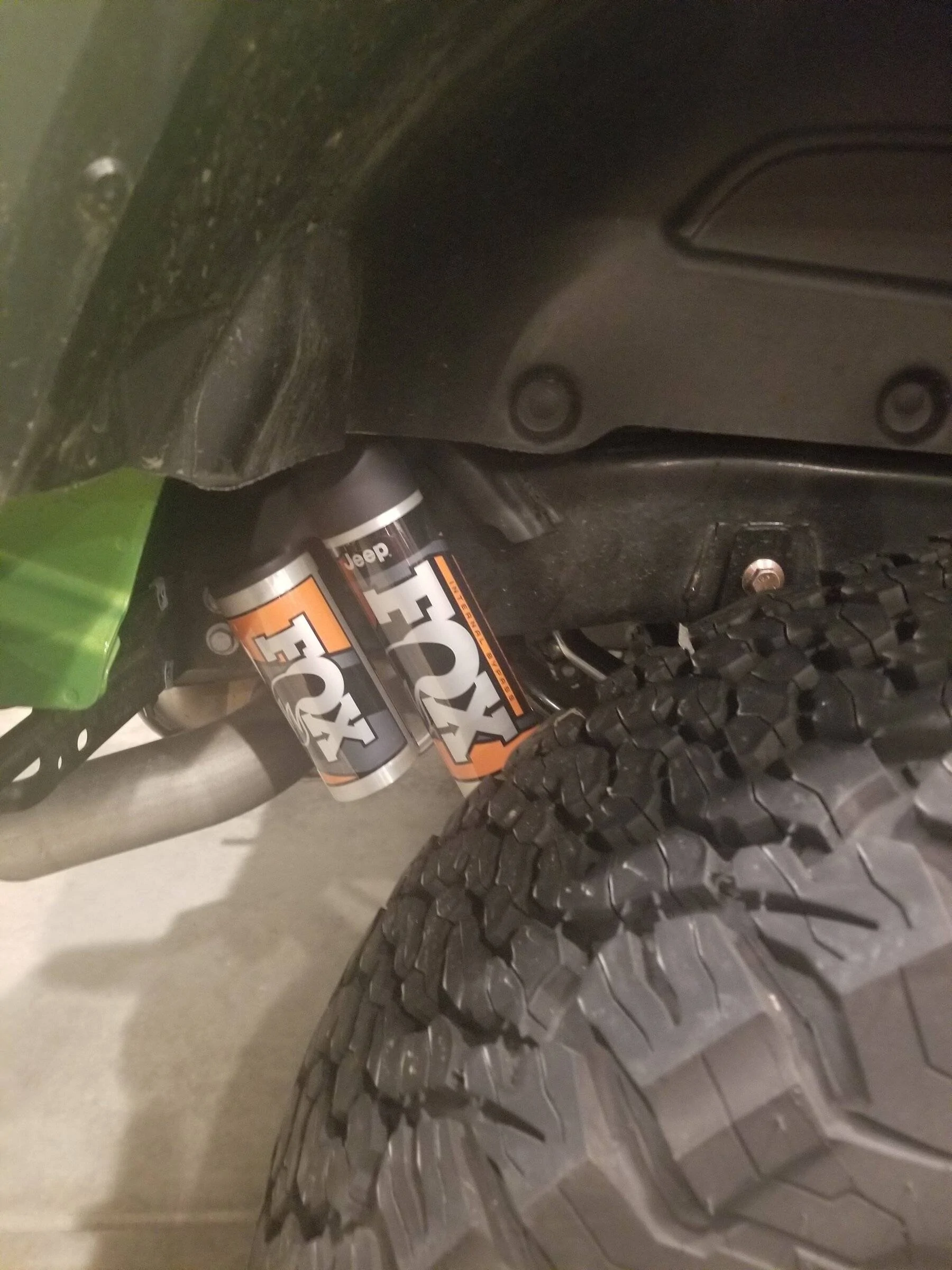

Sure can. I had my machinist buddy make spacers for me. Well, that did not work. These need to be offset away from the frame. Also the the right side will be the left side for the JL. The reservoir is offset. It just fits better swapping sides.
I just used washers.... No ones can see them in the upper mounts.

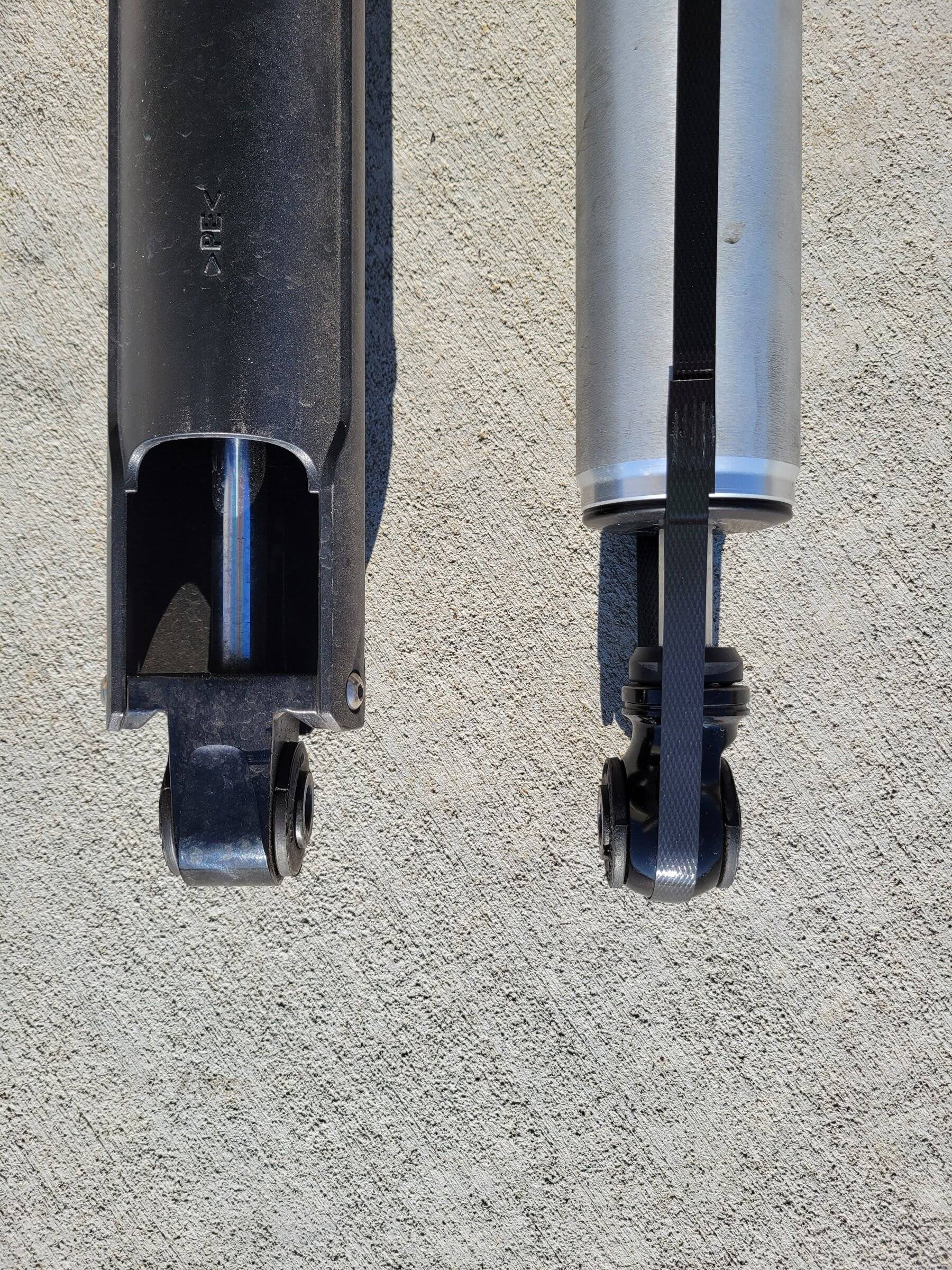

Have been getting questions about mounting and bushings.
I'll post out here to help everyone.
A 2" body shock is centered up in the mounts ( upper and lower .) A 2.5 or larger shock body needs to be offset away from the frame, for clearance reasons. Here are a few pics to help.
How do you offset the Mojave shocks? Washers or get a machinist friend, or if you can find this bushing.... 68351974AA from the Mopar 2" lift Fox 2.5 body shock. The lower bushings are the same( Rubicon) 68274045AA. Mojave have larger mounting hole for 14mm bolt.
In the lower mount ( on the 2.5 Fox )you will see the offset is made with the whole mounting leg.
For me they fit fine ( without the offset ) with the adjustable track bar. If you do not run an adjustable bar it might be a problem on one side, as the axle is not centered.

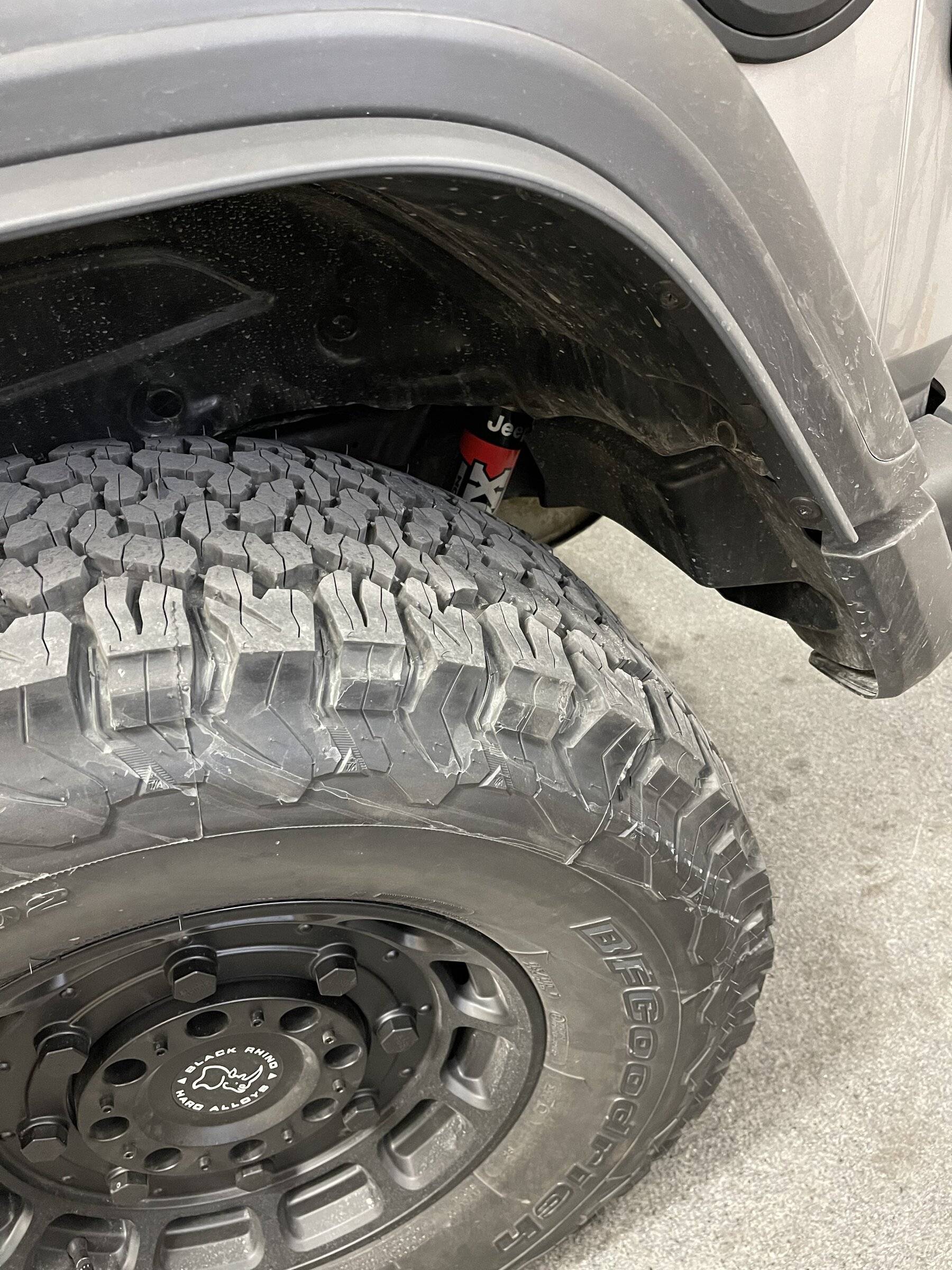

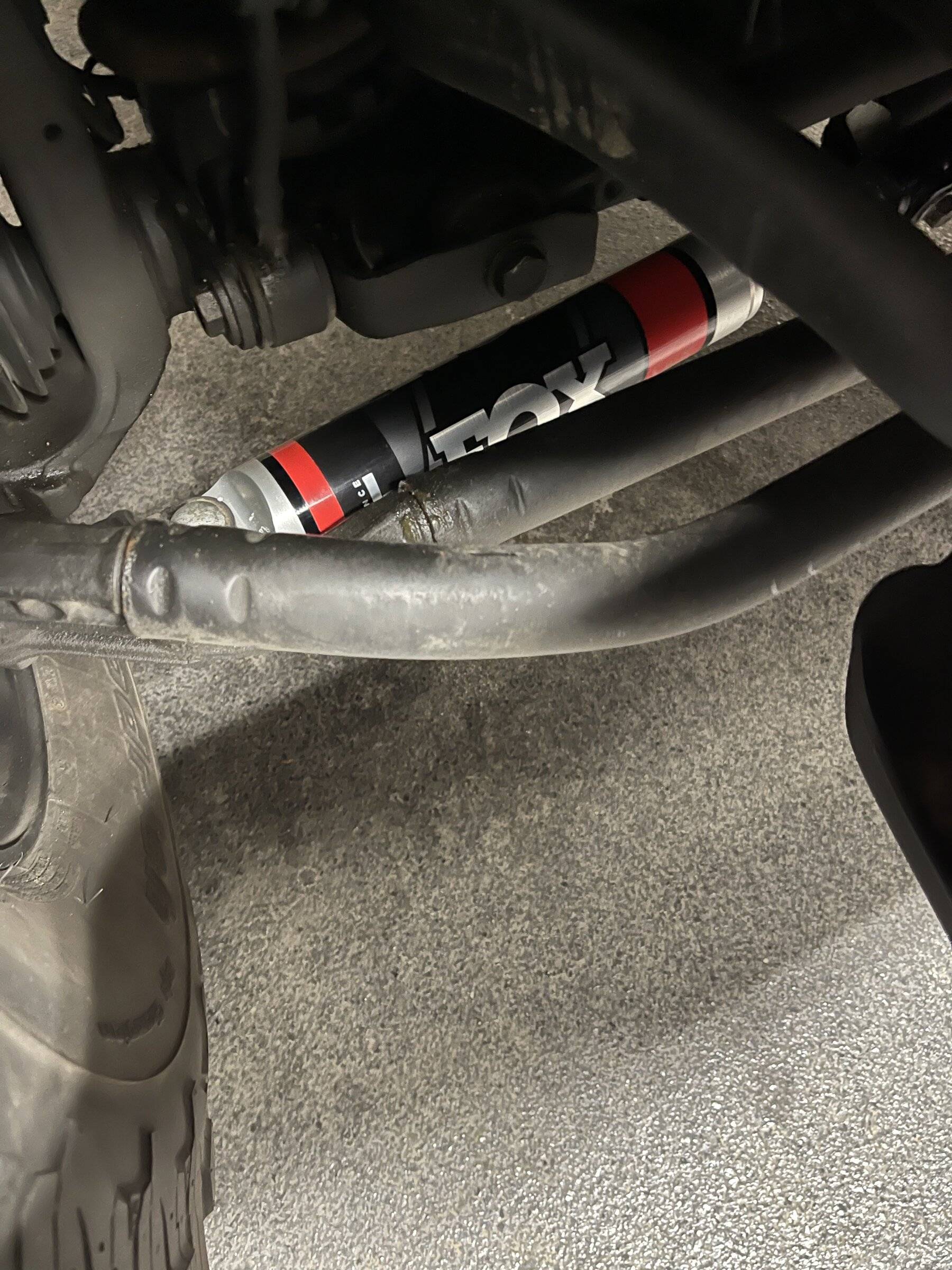

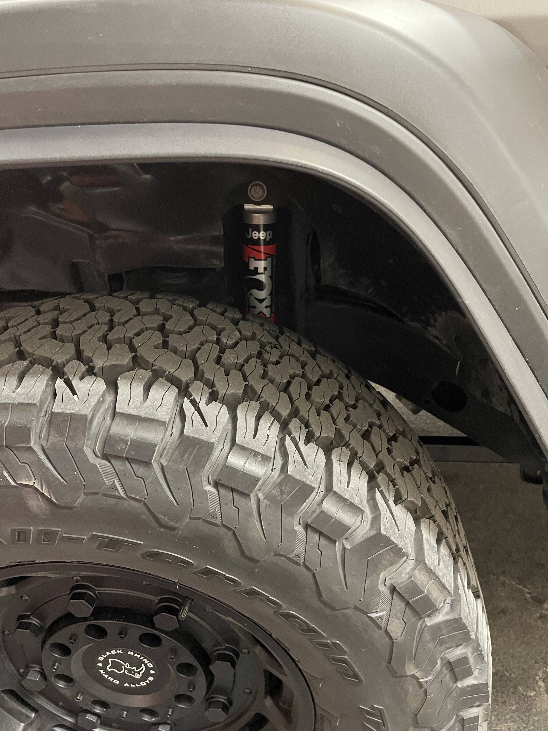

Thanks to this thread, I made the upgrade to JT Rubicon shocks a little over a month ago and totally love the spongy Cadillac like ride these shocks provide.
The only negative comment came from my daughter who borrowed the Jeep last week and commented how the Jeep fealth less stable and was constantly ā€˜ā€™rocking’’ as if it was a boat she said.
So some might not enjoy as much as I do. To me it beats the jabbing effect and banging sound provided by the stock Rubi shocks and by far.
Heck I even modded my Fox steering stabiliser to match the shocks….. yeah I know, I had too much time on my hands that day?
