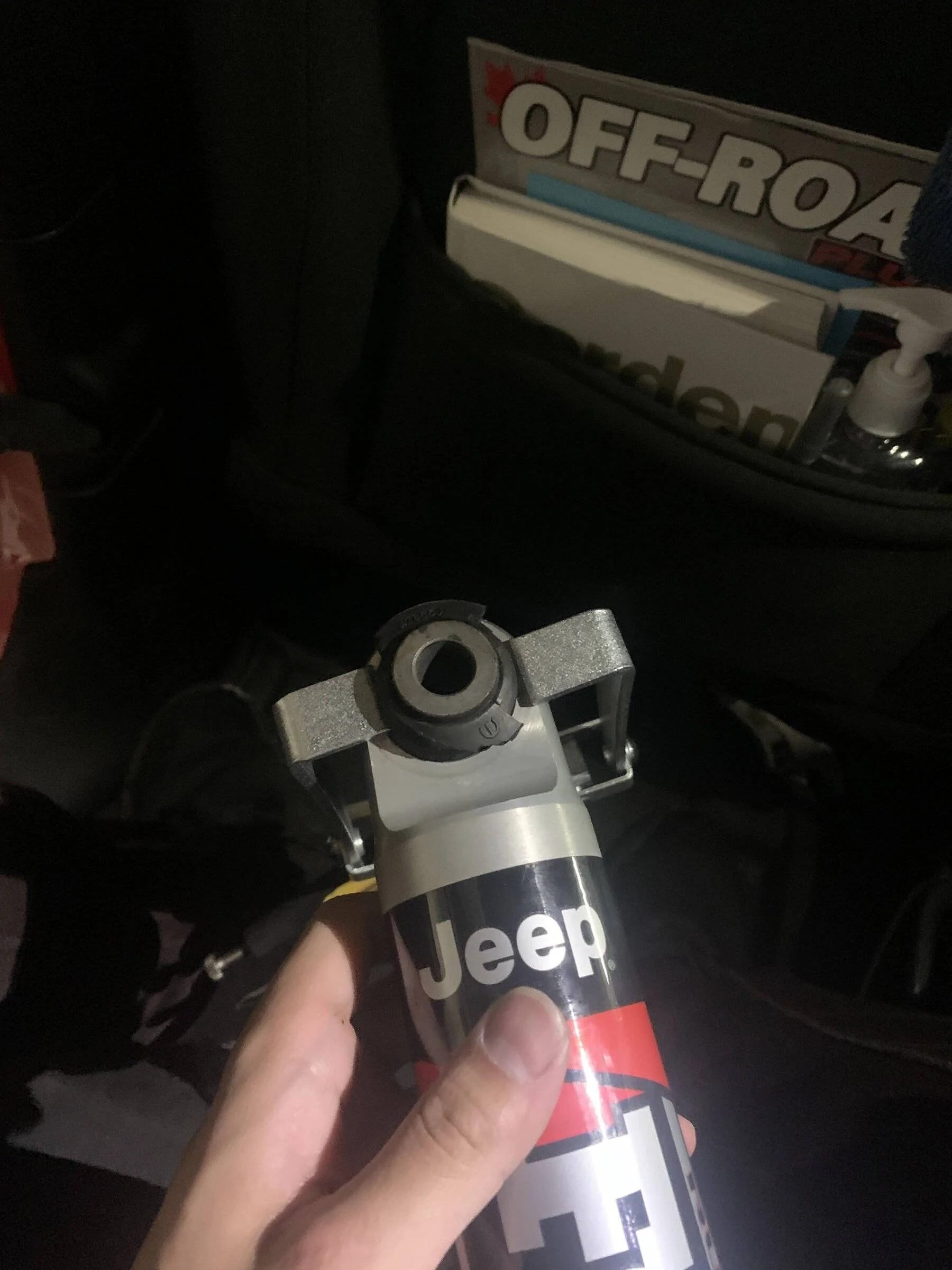

For whoever successfully replaced the rear shock upper bushings, how do you get the lip of the bushing going into the eye? I tried to do it with bolt, nut, washers and socket. The lip just did not want to go in and finally teared up ?.

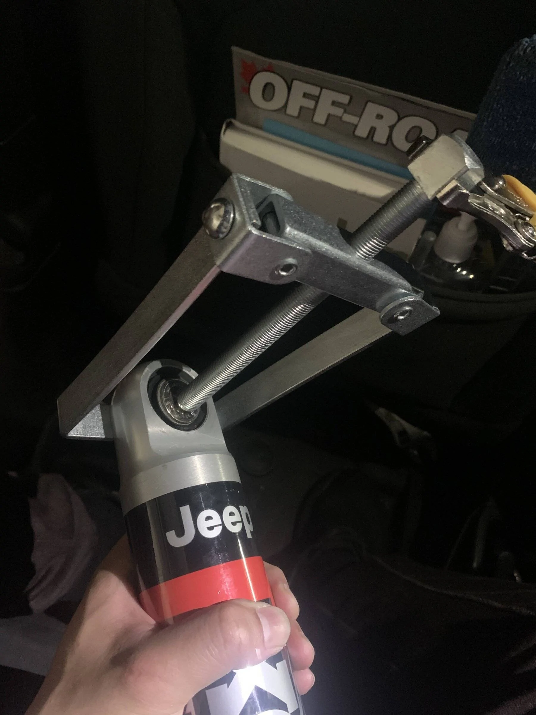

I cut part of the lip so it fit - and then pressed it in with a quarter and a puller
This looks insanely ghetto, because it is, but it worked, no issues with the shocks after some rough trips.

Thanks. This will be my last resort and the lips are wasted anyway. But there must be a better way to do it ? .

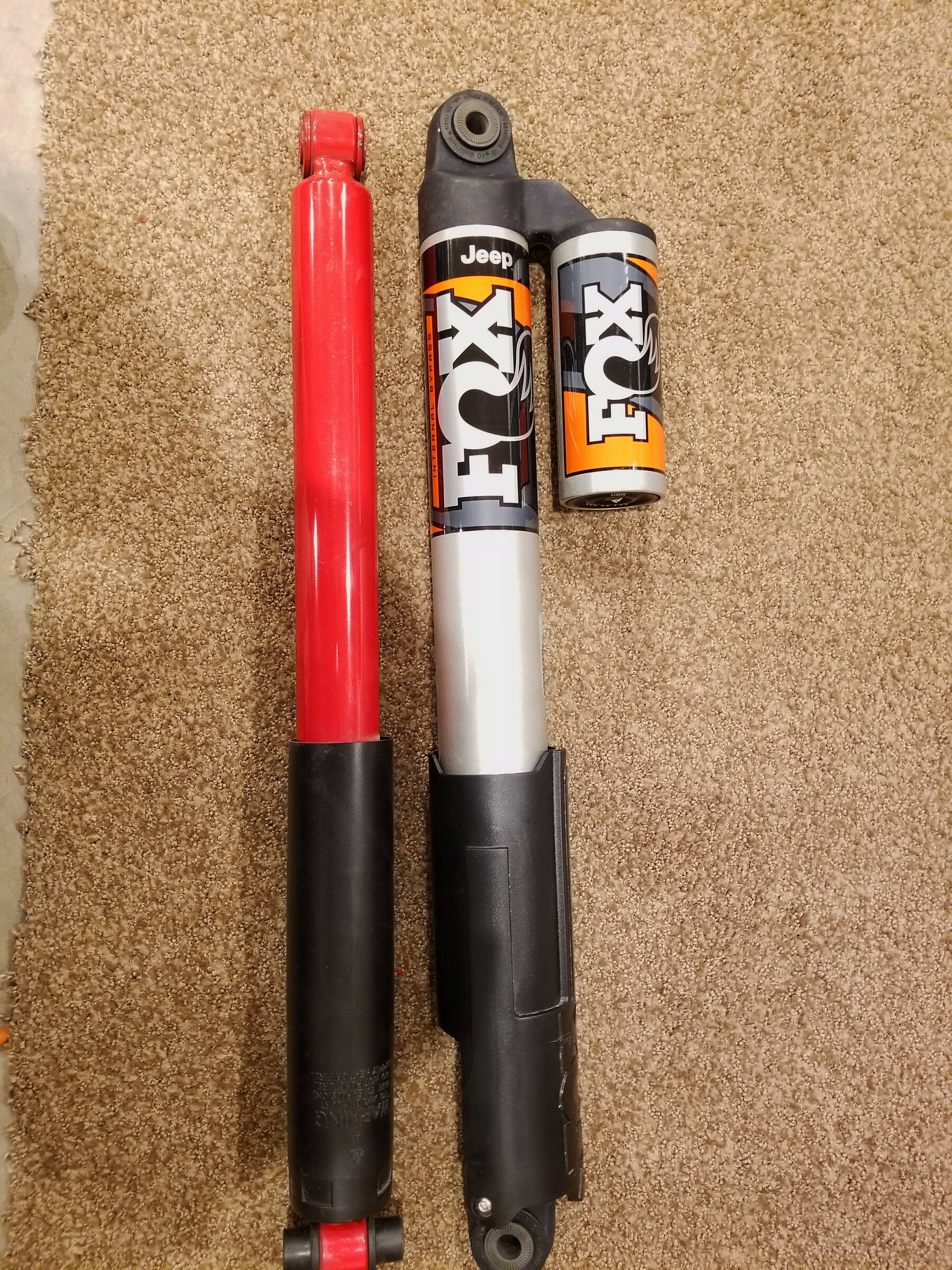

Need to get a set off the Mojave. They just a touch firmer then the JT Rubicon. Bonus they are By-pass shocks. Gets 2 inches at top and 2 inches at bottom of stroke. Goes way firmer at the ends of travel.
Prices have come down since I bought my set.
