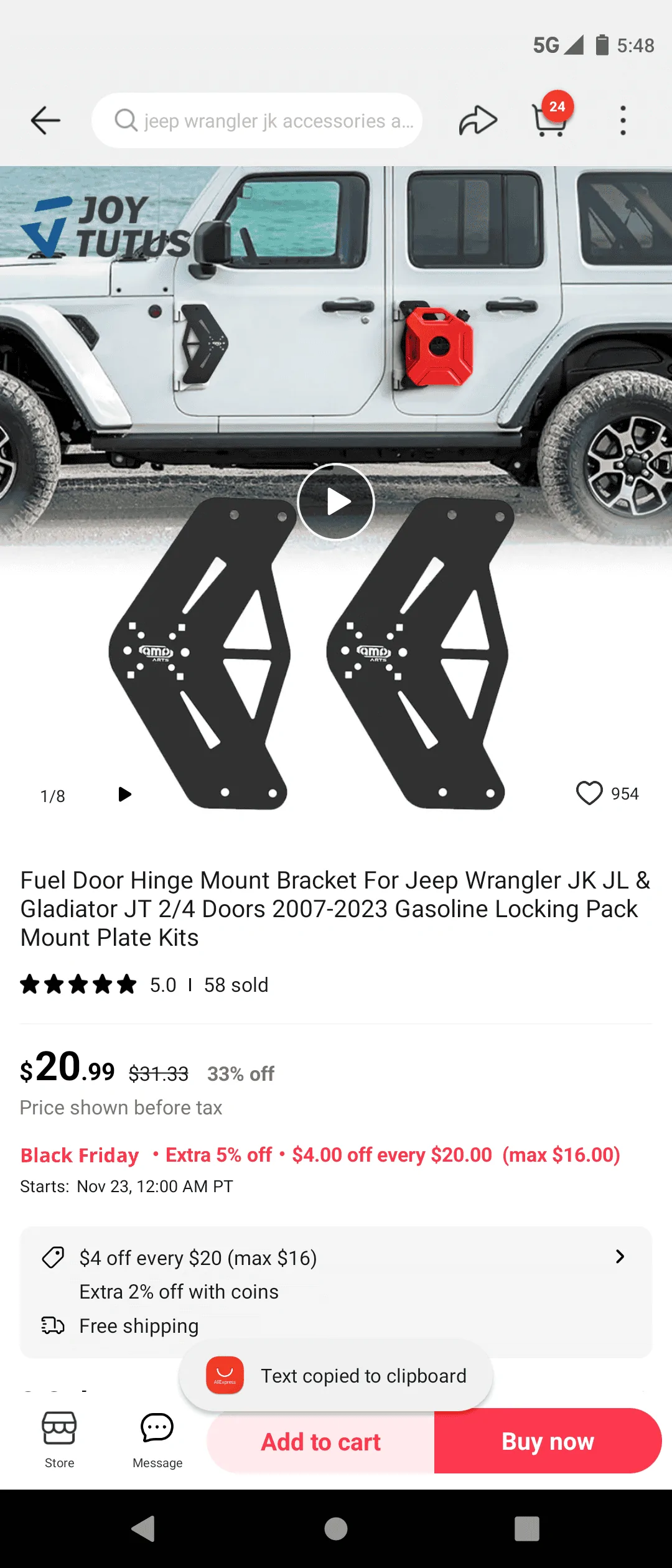

I'm now running one of these:
https://a.aliexpress.com/_mMqv6rm
Jeep Wrangler JL How Do You Carry Extra Gas Screenshot_20231122-054853
Even full of diesel fuel it's pretty lightweight. It's surprisingly high quality given that it's so inexpensive.
Shoot, I should buy a couple more for my other doors. It's dropped in price quite a bit from when I purchased it.

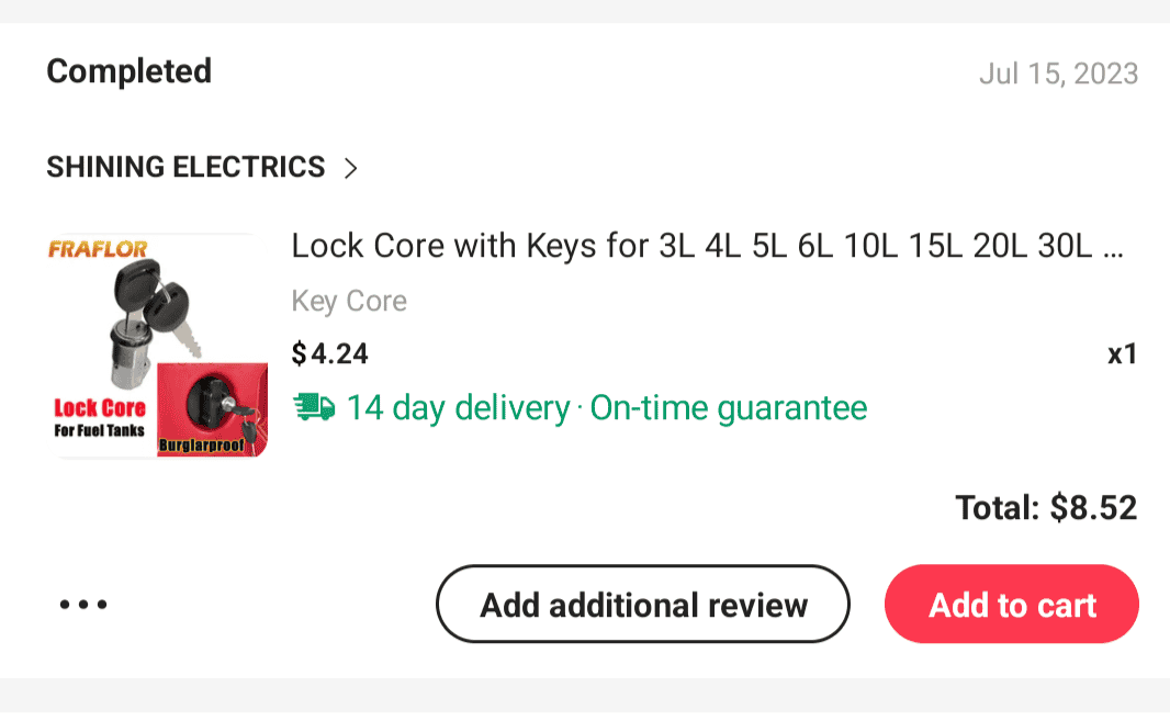

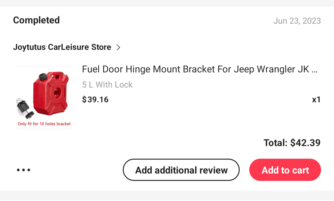

Just make sure that you purchase a compatible fuel tank and lock. Not that the lock is going to protect it too much, but it is really secure. I personally would have trouble getting it off without the key.
Jeep Wrangler JL How Do You Carry Extra Gas Screenshot_20231122-055335-351
Jeep Wrangler JL How Do You Carry Extra Gas Screenshot_20231122-055348-071
Honestly it doesn't vibrate the door at all and because it's only like 1.5 gallons or something, it doesn't weigh enough to actively affect the door where it makes it harder to close or even slam harder. You could probably run four of these, one on each door and be just fine. You could probably also get a 10L tank and you'd probably be able to do okay with that. That you might want to test it on just one door to begin with.
