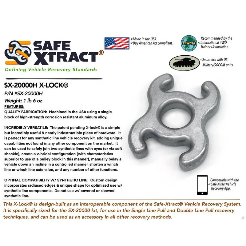

3. Similar to the first, spool out nearly the entire drum, but use one of those fancy doohickeys like X-Lock from Safe Xtract to shorten the line.
