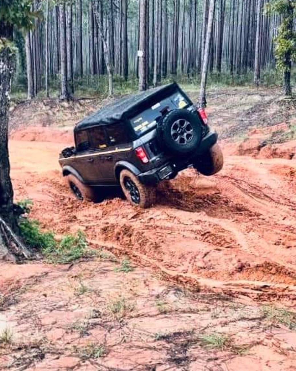

Here’s an example of BLD, I was trying to let it get me through but it was still a little wet and felt it slip so I engaged the front locker. Didn’t feel like trying to reattach my fender…🤣 And for some reason the wife found it amusing… you can hear her giggling 🤣

Do you think my little Jeep could follow you on that crazy flexy trail? That's the kind of wheeling I like, just flex, no stupid rocks and boulders 🤩🤩🤩
Yeah, no problem , in that spot the two door would probably get a little more tippy because your rear tire would be in the deeper section…you can see I was on two wheels for a second….. Broncos go around this hole because of their lack of articulation due to the IFS…They get tippy real easy on anything off camber …….

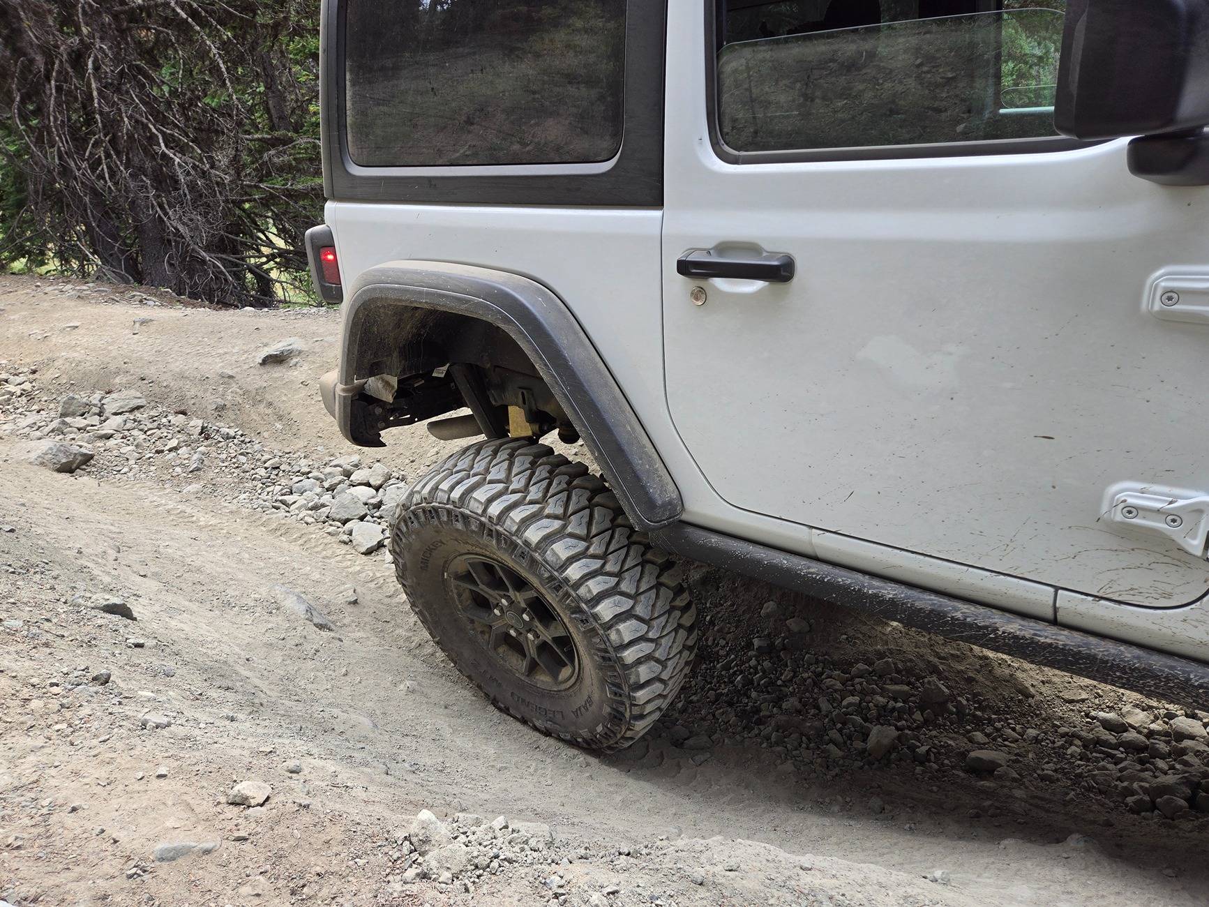

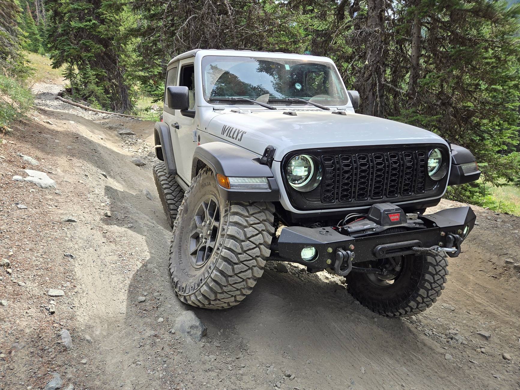

When I got maxed out. It is nothing compared to your trail
