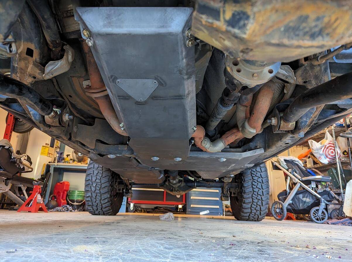

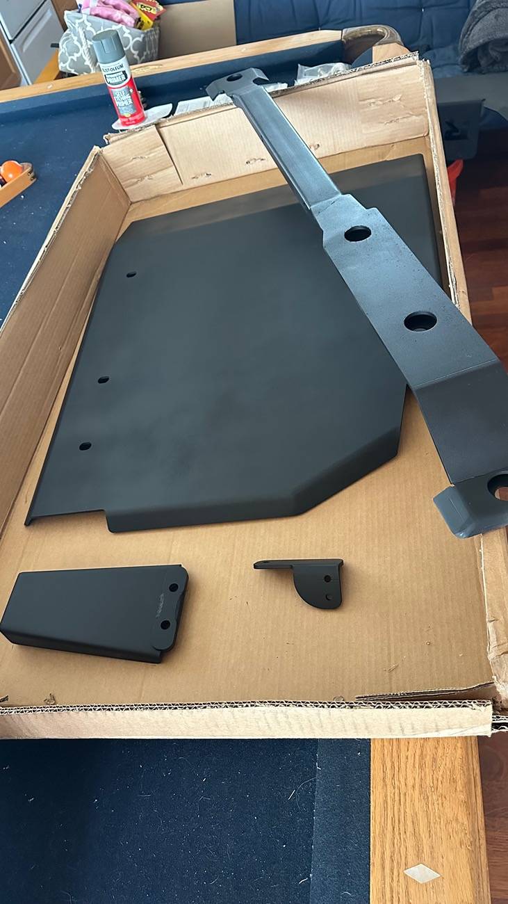

Looking for the highest clearance belly skids to maintain ground clearance and would love to compare what everyone’s running. Noticed some bolt on top the factory skids while others completely replace it and are you running steel or aluminum?
Edit: 2.0 w/ Etorque. 4 Door. Already have Rusty’s engine skid, wanting to complete rest of belly but worried about weight, heat, and clearance.
Update: I’ve purchased the rest of the Rusty’s skid system for a few reasons and will list my pros and cons below. I’ll list measurements and more pictures once fully installed.
Pros:​
- Made in America!​
- Price​
- True, fully connected belly system​
- Strength​
- Maintains lower COG, if anything it lowers it​
- Higher clearance than stock​
- Best Etorque protection on the market​
Cons:​
- 75lbs overall added weight vs stock skids (not horrible imo)​
- Comes raw, have to prep & paint​
- 4 bolts are not countersunk​
- Heat retention vs aluminum​

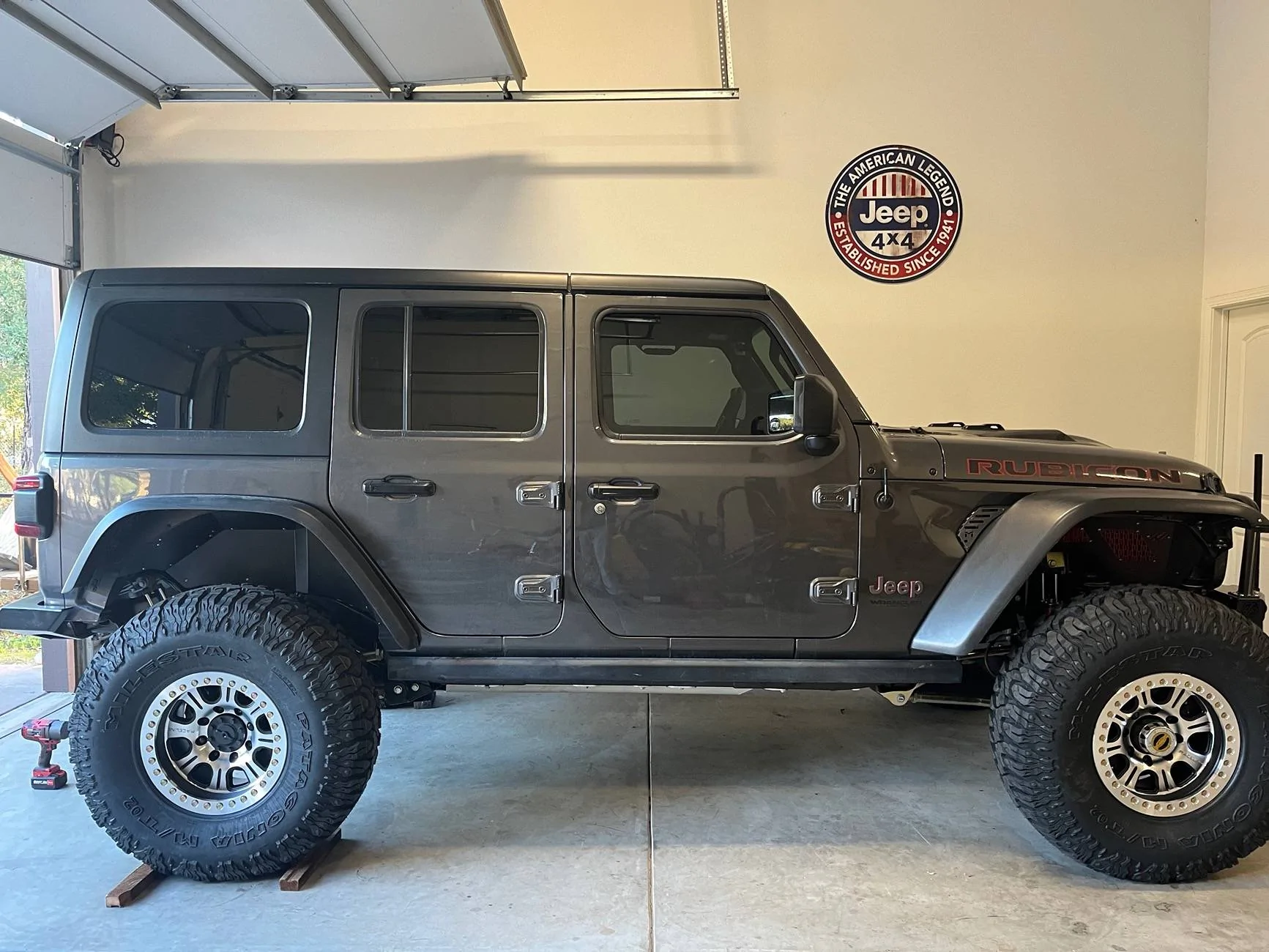

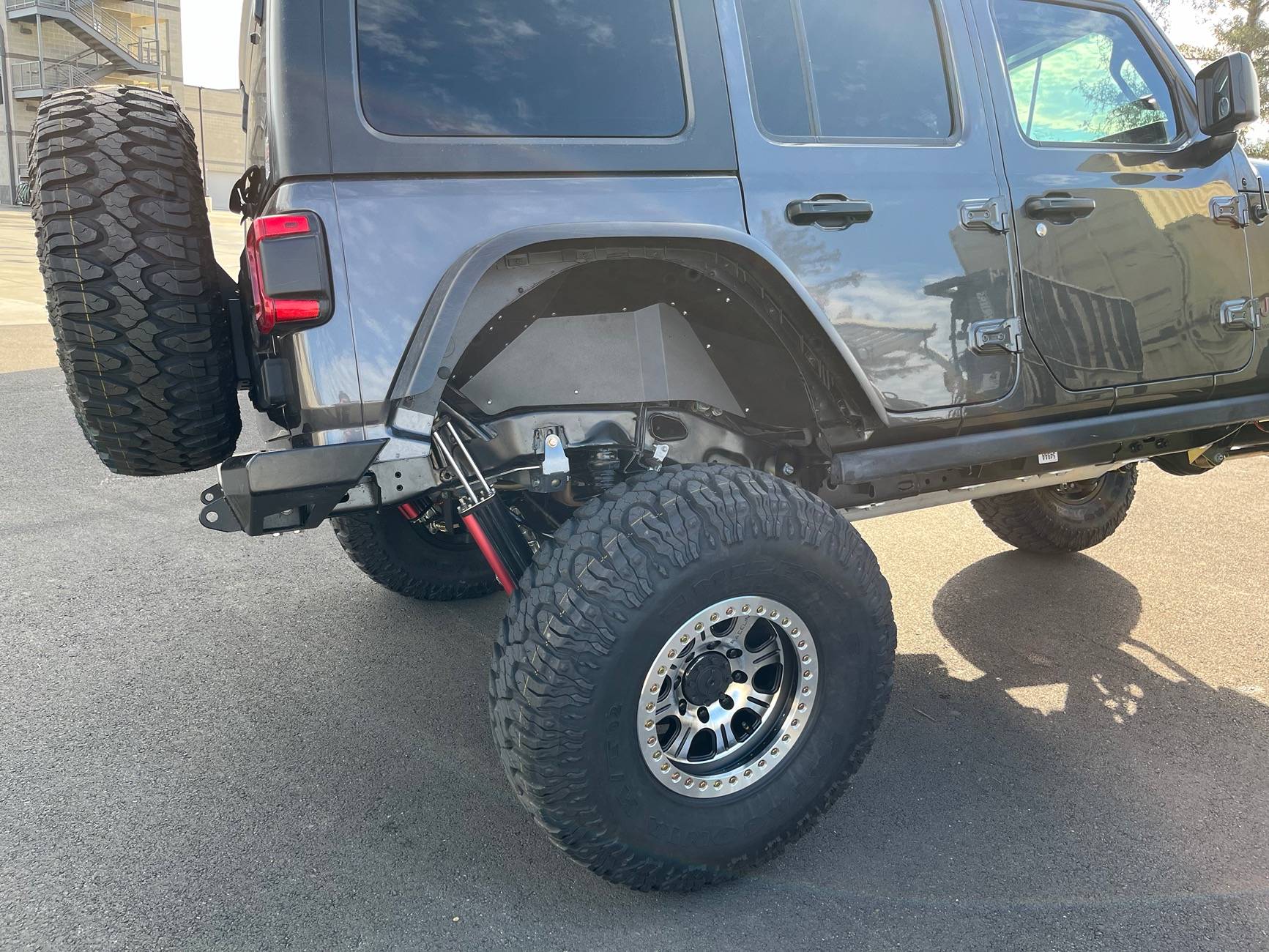

I have been happy with Artec. It covers the entire underside and only adds 10lbs to the Jeep. All of the factory skids come off. Their skid plate also raises the fuel tank up about an inch over the stock location. I hardly notice it from the side of the Jeep.

I doubt there's any meaningful difference in ground clearance between the top brands.

What fenders are those? Thought it might be a chop from the front but the rear is throwing me off.

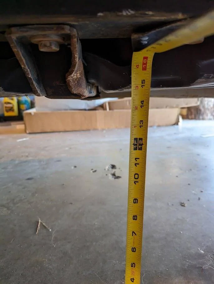

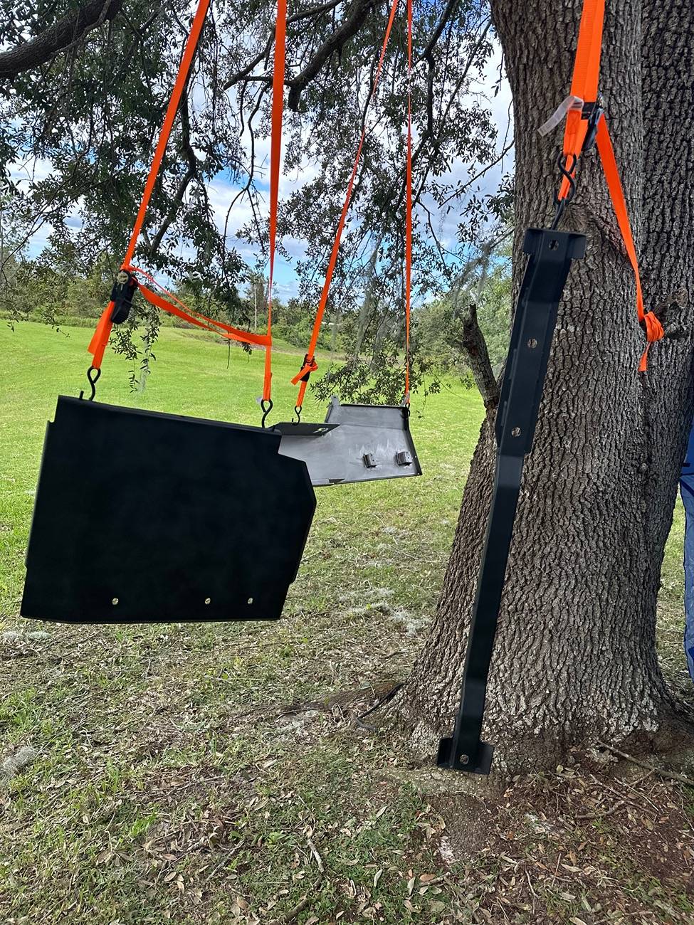

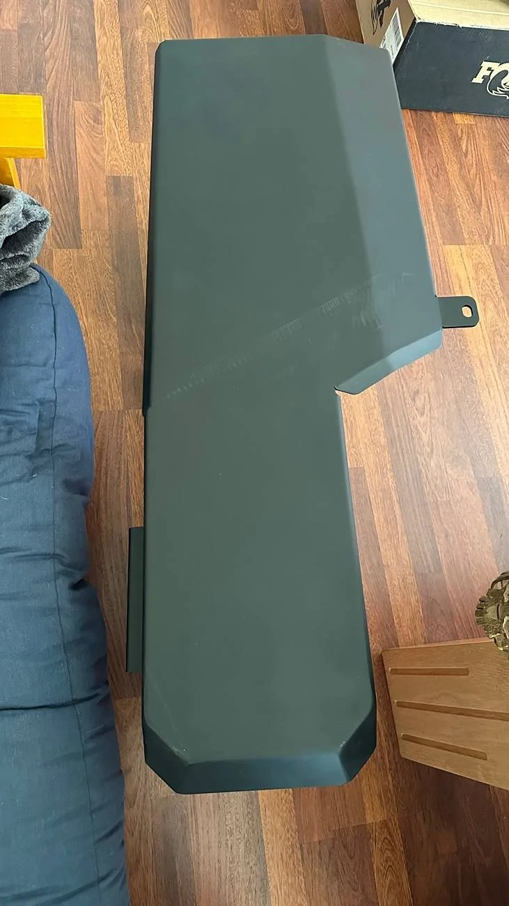

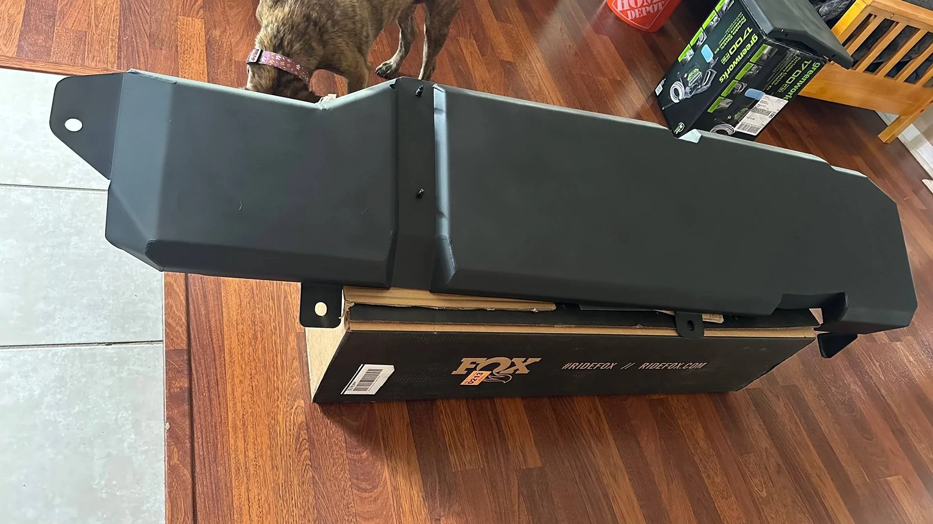

I have the Rustys, I choose these because the ground clearance is better than Metal Cloak. They are solid, and I have no regrets. Rusty is great to work with.
The only thing I dont like about these is that they leave the exhaust down pipe somewhat exposed.
They are going to get torn up anyway, I'd just assume leave them unpainted... I coat mine every year with Surface Shield. Works great for other areas as well. Good practice if you use your jeep on trails like it was made for!
https://blasterproducts.com/product/surface-shield/
I have a friend running the Metal Cloak and his are bent into the exhaust pipe resting on it. I'd rather not have that to be honest. Plus Rusty's are cheaper, get the whole kit with the gas tank skid, the factory one is not strong enough for wheeling.
If your focus is on clearance, I would assume you are going to do some wheeling. I ran aluminum for a while, but they dont hold up well. Mine bent in all kinds of undesirable ways. it got the point where I had to take them off the jeep and hammer them out with a sledge every other time I went wheeling....
