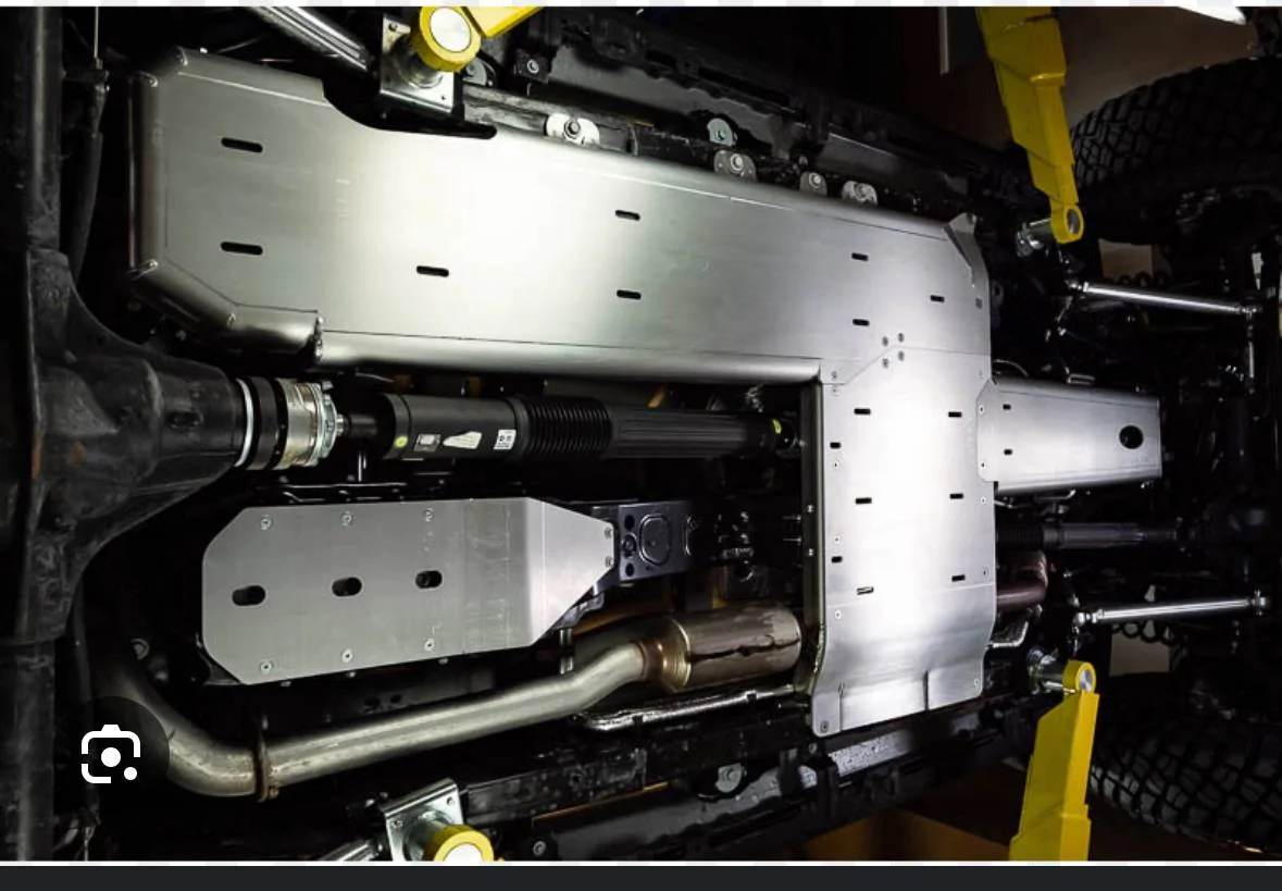

Artec
Jeep Wrangler JL Highest Clearance Belly Skids? Pics? IMG_3811

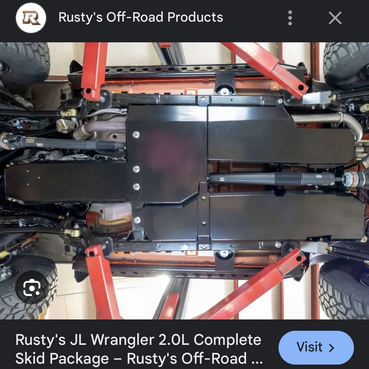

Rusty’s
Jeep Wrangler JL Highest Clearance Belly Skids? Pics? IMG_3812

Still I’ve in Florida but wheel it on everything east of the Mississippi. My exhaust travels down next to my etorque battery so that’s got me thinking about the trapped heat of I go with the Rusty’s. Motobuilt and Artec have similar etorque skids that don’t fully cover the belly allowing heat to escape from exhaust but creating a huge hang up section. I do like the idea of having the entire belly smooth but I also like the idea of running aluminum over the fully steel Rusty’s
Artec
Rusty’s
@Artec
Any plans on updating your skids to a one piece that covers the battery and exhaust like this

@Artec
No plans at this time due to the way the battery is mounted that skid hangs lower than the rest of our skid plates it would severely reduce break over angle .
